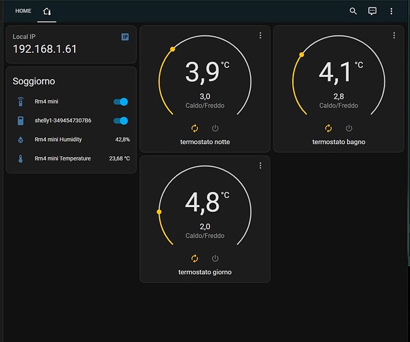

HI,
i use home assistant SO on virtualbox/win10, i read this and many other guides but i can’t change the temperature of my tuya thermostats. I used Tuya integration and the devices have been acquired, but the temperature is not correct (with this mode the \HOMEASSISTANT\config\custom_components folder is not generated).
I tried with HACS\Local Tuya but I don’t know how to set the parameters and the devices are not detected. With this mode the custom_components\local tuya folder is generated, I modified the climate.py file as instructed, restarted HA but no effect.
help help help
Tuya:
TuyaLocal:

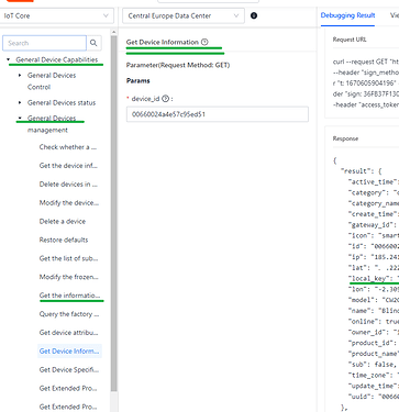

The trick and complication to get local tuya to work is finding out the device key and ip address. The details are in the link given above
Finding your device ID and local key
The easiest way to find your local key is with the Tuya Developer portal. If you have previously configured the built in Tuya cloud integration, or localtuya, you probably already have a developer account with the Tuya app linked. Note that you need to use Tuya’s own branded “Tuya Smart” or “SmartLife” apps to access devices through the developer portal. For most devices, your device will work identically with those apps as it does with your manufacturer’s branded app, but there are a few devices where that is not the case and you will need to decide whether you are willing to potentially lose access to some functionality (such as mapping for some vacuum cleaners).
If you log on to your Developer Portal account, under Cloud you should be able to get a list of your devices, which contains the “Device ID”. If you don’t see them, check your server is set correctly at the top of the page. Make a note of the Device IDs for all your devices, then select Cloud on the side bar again and go to the API Explorer.
Under General Device Capabilities / General Devices Management, select the “Get Device Information” function, and enter your Device ID. In the results you should see your local_key.
The IP address you should be able to get from your router. Using a command line Tuya client like tuyaapi/cli or tinytuya you may also be able to scan your network for Tuya devices to find the IP address and also automate the above process of connecting to the portal and getting the local key.

With a Tuya Wifi thermostat the temperature of this thermostat is divided by 5 using the ufficial Tuya addons ( Others addons not work for me).
