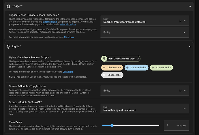

Hello
Not sure what I’m doing wrong here.
trying to add automation “when person is detected by G4 Doorbell to turn ON, over head light, and Off when no detection”. I’ve Tried running the action but nothing happens.
alias: Front Door Overhead Light-Person Detected
description: “”
use_blueprint:
path: Blackshome/smart-light.yaml
input:
include_entity_state:
- entity_on
- entity_off
entity_input: binary_sensor.g4_doorbell_pro_person_detected
include_sun:
- sun_falling
light_switch:
entity_id: light.front_door_overhead_light
include_light_control:
- use_brightness
type or paste code here
Thanks for you YAML.
Looks like you would like to turn ON a light when your doorbell detects motion but only when the sun is below a set value.
If this is the case then I would recommend using my Sensor Light blueprint. In this blueprint you would add your binary_sensor.g4_doorbell_pro_person_detected as the trigger and enable the Sun Elevation.
What ever blueprint you decide you must include your lights to turn ON in the Lights section. Current you have no lights selected so there is nothing to turn ON.
Blacky
hello
thanks for quick replay
in the blueprint i did select the light to turn ON
the automation i would like the IF person detected, turn Light on during Sun Elevation. Then turn off light when person detection stops
Yes, you’re correct… that was my oversight when cleaning up your code in the automation.
Now you’re working on the sensor light blueprint, not the smart light blueprint.
What you have currently will turn the light ON and OFF when motion is detected, regardless of the time of day.
If you want the light to turn ON only when it’s dark (e.g., when the sun is below a certain elevation), check the sun section in the blueprint and enable it. You’ll also find a helpful link there explaining how to configure sun elevation settings.
Blacky
