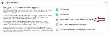

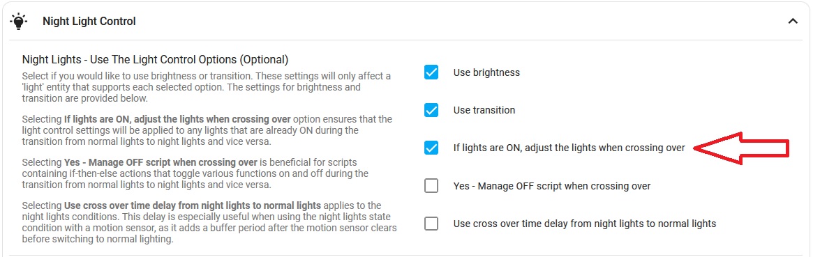

Yes, the lights in the main automation and the night lights section are different entities. That’s what got me puzzled. Anyhow, will check again tonight after update and will let you know. I’ve noticed the change in YAML code pertains to sun. So hopefully it works perfectly now.
You suggestion about changing countries work. Once again thanks for your hard work. Will donate again once I get the my presence sensor working and using the Sensor light Blueprint. Your Blueprints are definitely worth at least as much as the hardware used since they makes the use of the hardware in the way I want to use them possible. Please keep up the good work.
Erwin
@erwinsidik
Make sure you have also selected If lights are ON, adjust the lights when crossing over, see below.
Thanks for your support (donation) and your kind words it really helps!
Blacky :grinning:
Aha, got it. Did not see that option before. I need to pay better attention :grin:. Anyhow, I’ve ticked that option and will report again. Thanks for the very prompt reply.
