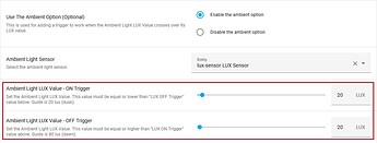

Below shows the OFF value higher than the ON value. This will work
Below shows the ON and OFF values equal. This will work
Below shows the OFF value lower than the ON value. This will not work

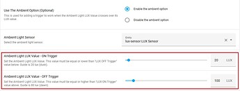

If using Ambient Light Sensor then you will need to set your OFF value. Below shows a dead ban of 80 lux.
If you would like to keep it the same before this update then set the OFF vale the same as the ON value. Below show the setting the same as before the update.
