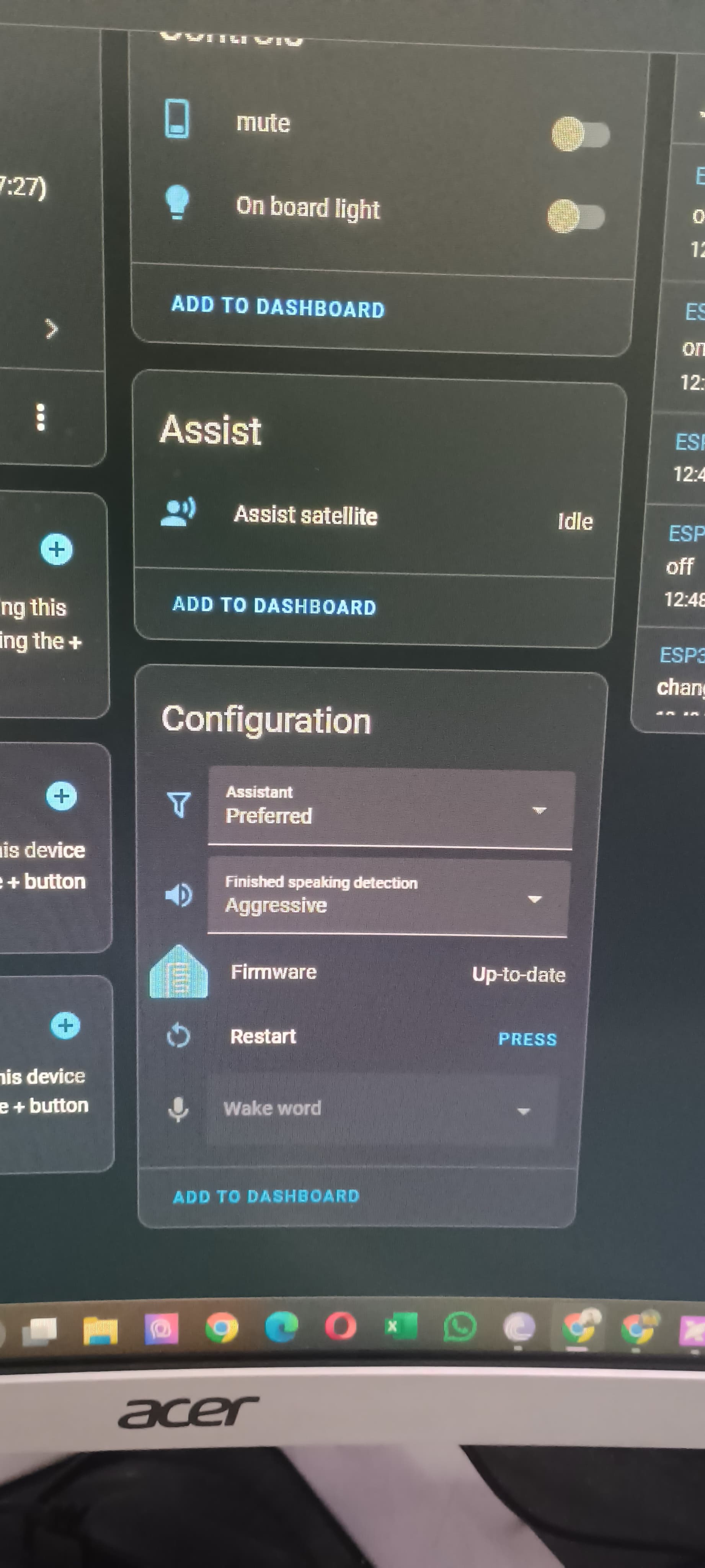

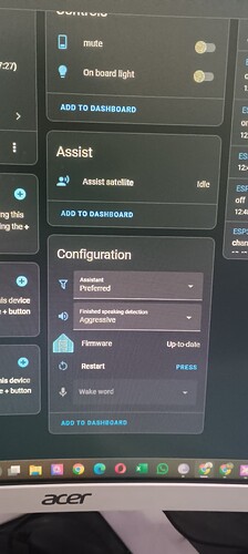

a) the external mute button doesnt work at all, although the mute option inside home assistant worked. The lights on the esp32 worked and was controllable, indicating the code worked
b) even though he setup the wake word with the voice assistant inside ha, the esp32 does not detect his voice at all, it shows that wakeword is unavailable
c) it shows ’ assist satellite ’ as idle, meaning its waiting for my voice command, which is not detectable in the first place
my question is did he go wrong in any of the steps, or is the external microphone broken?
