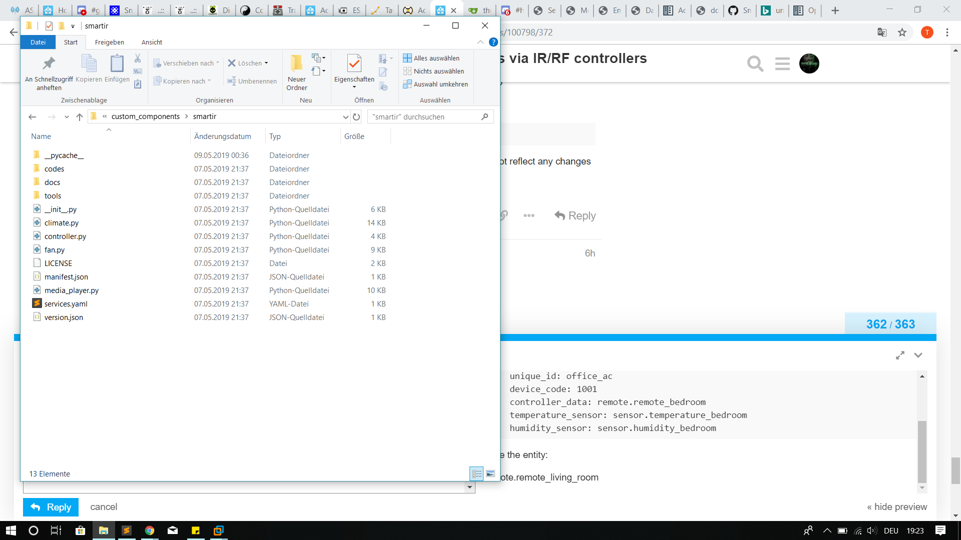

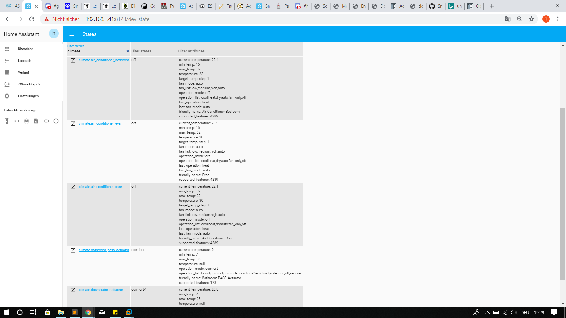

Has anyone a Xiaomi IR blaster AC running here? mine just won’t show up. Wonderung if somethng is wrong with my config?
climate:
  - platform: smartir
    unique_id: office_ac
    device_code: 1001
    controller_data: remote.remote_bedroom
    temperature_sensor: sensor.temperature_bedroom
    humidity_sensor: sensor.humidity_bedroom
Here the entity:
my codes filder has this config:
https://paste.ofcode.org/4uDaPbPaPNCVZinwTKCWXa
but never shows up in hass
 no enties in the logs
@thundergreen
Please check your controller_data:
It should be like
controller_data: your_irblaster_ip.
ref:
My entity for controller data is remote.remote_bedroom. So no IP
 I renamed it. This remote works with smartir mediaplayer but not ac
see my media player config:
  - platform: smartir
    name: Living room TV
    device_code: 1040
    controller_data: remote.remote_living_room
    power_sensor: binary_sensor.tv_state
It just won’t work wit AC platform
controller_data: 192.168.1.___
What is the local up on which your Xiaomi it blaster is connected
You should have errors in logs. Please restart your HA and post your full logs on GitHub
But i don’t have any entity_id with ip as I renamed it. do ihave to put the remote.entity_name or the IP ? Not clear because for the media player it works with my remote.entity_name
What’s would be the logger setting for this component to enable debug?
Don’t enable deeper logging settings. Just send your full logs
2019-06-11 09:43:42 ERROR (MainThread) [custom_components.smartir.climate] The device Json file is invalid
My Json file is invalid. could you have a loo
https://paste.ofcode.org/4uDaPbPaPNCVZinwTKCWXak what i am doing wrong?
The link is broken
my actual Json file is this:
https://paste.ofcode.org/Xa984EdSLmDExdnv4vnPr4
Please remove the comma from heat -> low -> 30
