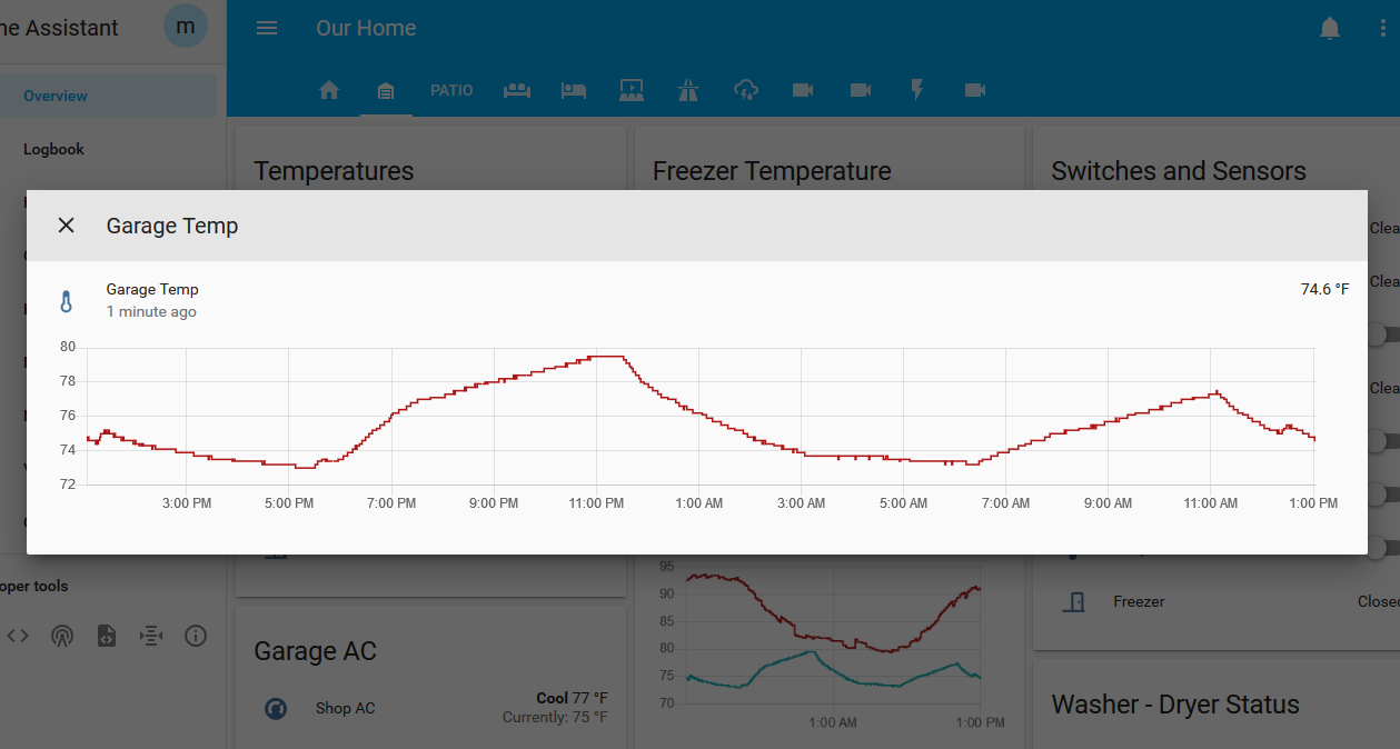

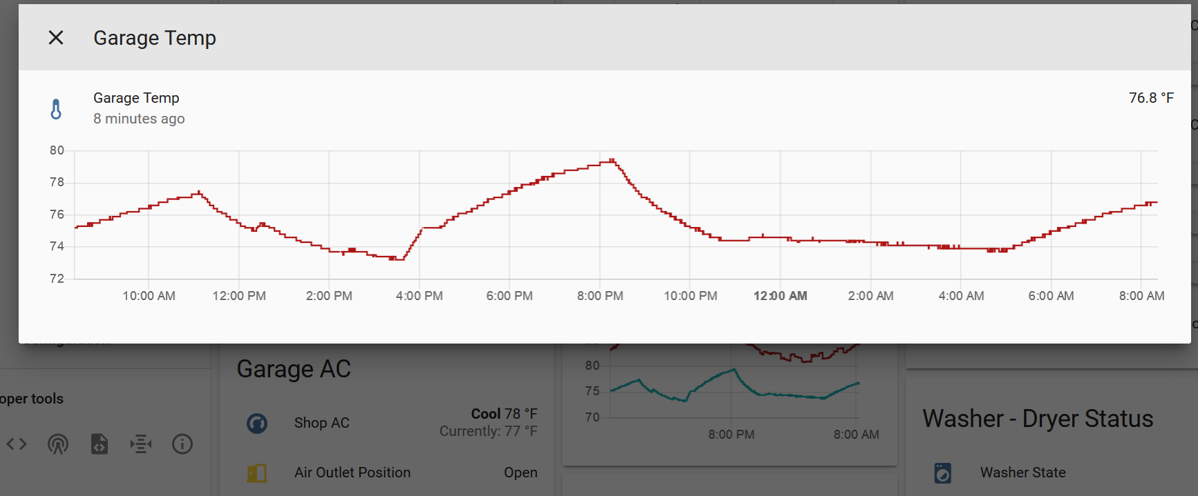

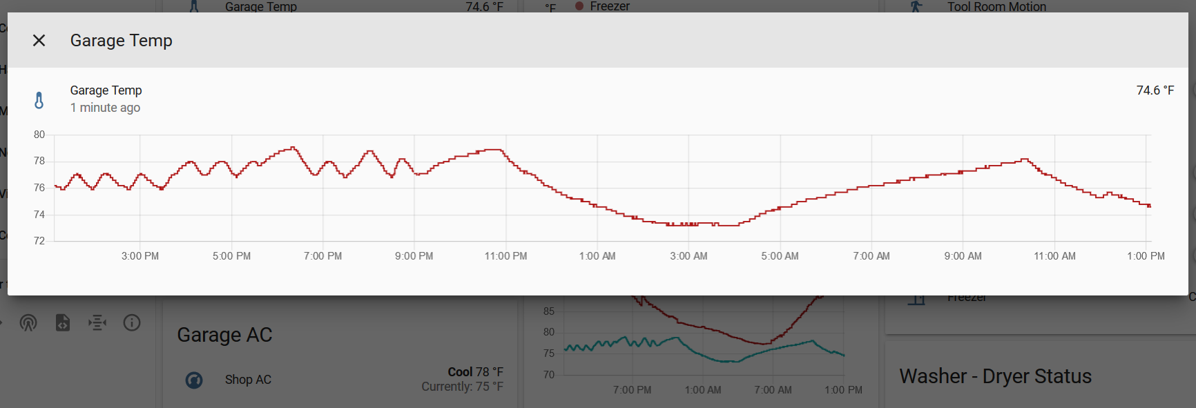

I just got a new MRCOOL 12K mini split AC installed. Last night, I changed over from the genreic thermostat to the Smartir. Since there wasn’t a json file for the MRCOOL, I had to capture the codes using Broadlink Manager. So far, I only have the ones for “cool” and the temp setpoints when the fan is in Auto. It seems to be working OK. To me, it seems the control is slow with several degrees swing. I will let it run and see if the control tightens up. Thanks for creating SMartir.
If you check the graph, 9PM is when I switched to Smartir. Then about 3AM, I raised the setpoint one degree to 78 because the temp kept falling and was 73 deg F. I hope this works out good. I like it.

Does anyone have any suggestions for tighter control, or is this the expected outcome? The garage is well insulated. When I was using the generic thermostat, the temp was being controlled at about 1 deg swing. My temperature sensor is about 12 feet from the unit, so it is a representative reading for the entire garage. Set point is 77 deg F. High swing 79 deg, low at 73.2
Question. What does “Precision 1” mean in the json file? Can that be tweaked to get tighter control?
This component doesn’t regulate anything, it just sends codes, it’s up to the Aircon to do this.
Is it inverter model?
Yes. This is an inverter model.
This one.
https://www.homedepot.com/p/MRCOOL-DIY-Enhanced-12-000-BTU-1-Ton-Ductless-Mini-Split-Air-Conditioner-and-Heat-Pump-115V-60Hz-DIY-12-HP-115AE/309068908 Here is the overnight graph.
