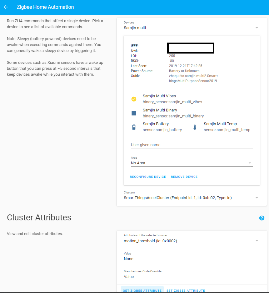

Not sure when or why (guessing some update that silently came through), but I was playing with my zha stuff and now everything on this Samjin multi is working perfectly with the latest hassio/hassos!
Now when I move the sensor the vibes entity correctly registers as active. When I stop moving it, about 10 seconds later it changes back to no vibes. The magnetic binary, battery level, and temperatures are also working well as they always have since I got it last summer. As I said, I’m running the latest releases (hassio 0.103.3 + hassos 3.7 + HUSBZB-1), and all I did was play around in the zha configuration page. I was checking the accel cluster attributes and noticed the x/y/z values seemed to be changing (but the entity wasn’t updating). So the lightbulb went off, I hit the button to “reconfigure device”, and a moment later the once dead entity was alive, registering movement properly!
I’m just guessing that there was some hassio update along the way that must have come with a fix for this, and ‘reconfiguring’ applied the updates to the system files. Regardless, this makes a huge difference in how I feel about the Samsung multi. I’ll be getting more of these versatile things in the future… just wish it had humidity too LOL.

I also tried to add this sensor to a home assistant running a HUSBZB-1 on Hassos 3.7 and Hassio 0.103.0, and I had the same problems as some folks in this thread:
a) the open/close was detected as a wet/dry, and
b) it only ever got a reading when it was first added and then never woke up and sent anything ever again.
Updating hassio to 0.103.6 and re-pairing the sensor fixed the latter, so now the sensor is working properly! (Thanks for suggesting that the latest patch version made a difference, @truglodite! I didn’t see anything in the change log that would be pertinent, but it sure seems like something got nudged.)
It did not, however, fix the former. So I added an override for the Device class field in the Customizations settings for that sensor, for it to be opening instead.
That did fix the problem - though at first it appeared to only partly fix the problem; it changed the icon, and the wording of the “Do something when...” automation shortcut buttons on the device screen, and stuff like that, but the state history still said “Wet”/"Dry".
As it turns out though, it displays the right values going forward, and it’s just the recorded data from before customizing and restarting that is incorrect:
So like, if you go that route to fix this problem, just don’t worry about the bit of history that was recorded beforehand, it’ll be fine :laughing:
I also used a custom device class to change that moisture default to an opening binary. Not sure how/why the quirk for this device has it defined as moisture, but oh well easy fix.
