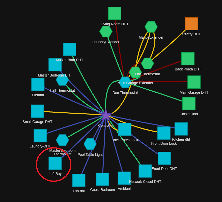

What does the zwave mesh map look like? Are the blinds connecting directly to the hub or are they connecting to a nearby device first? Which zooz radio are you using?

The map shows the shade (when i can include) with a direct LR connection. It’s circled below. There are weird paths in some of the standard protocols that one day I need to figure out or override, but the LR’s (all blue) go direct.
At this moment in time there’s only one shade that is included.
