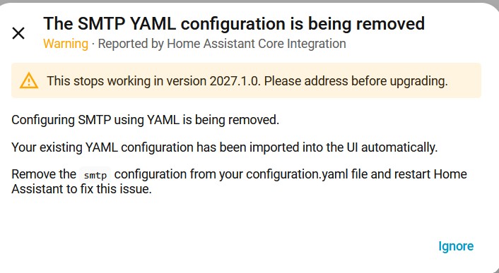

Folks, I received
the attached message the other day when I did a system update. I'm not clear about what is happening and how it will affect my automations?
I'm really a beginner with HA. I have set up several automations for your leak detectors which send e-mails. Does this affect them and if so what should I do to insure that e-mail alerts will operate?
Thanks....RDK
I Means what it says, remove the SMTP-conf, in your YAML, go to /Settings/Device&Services, check the SMTP Integration there, make sure it's configured correct
Another time, try to use the Search function in here, im sure you would have found this.
Also it's a good practice / routine to Read the Release Note,before hitting Update
After verifying your SMTP integration settings, You could go to your Automations and run them manually( or "provoke" them somehow ) ( Beside the one which call 911 ) :grin:

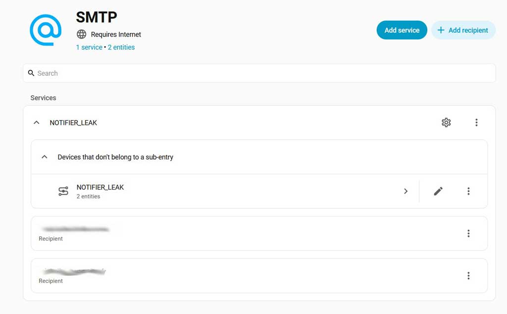

When older YAML only integrations get updated and moved to being configured in the graphical user interface they will also import your existing yaml into the new GUI integration for you. All you have to do iis check that this worked correctly by looking in Settings -> Devices & Services -> SMTP. If it did then delete your SMTP YAML and restart.
Everything should keep working.
Clear as mud to me as well ...
I checked configuration.yaml and didn't find an reference to smtp ... Digging into my config I found that I had my smtp configuration in a notify.yaml linked to configuration.yaml with an include command.
So the error message could have been clearer ....
I went to the new smtp integration in my devices and services, clicked on one of the entries to check the configuration and it crashed my home assistant .... not a good start
(update) .. .after another restart I could edit the smtp info ... no idea why it failed first time. I was left with three old entities related to the old smtp configuration .. they showed unknown .. no delete option available for the entity so I just had to disable them .. probably leaving more old junk in my config.
