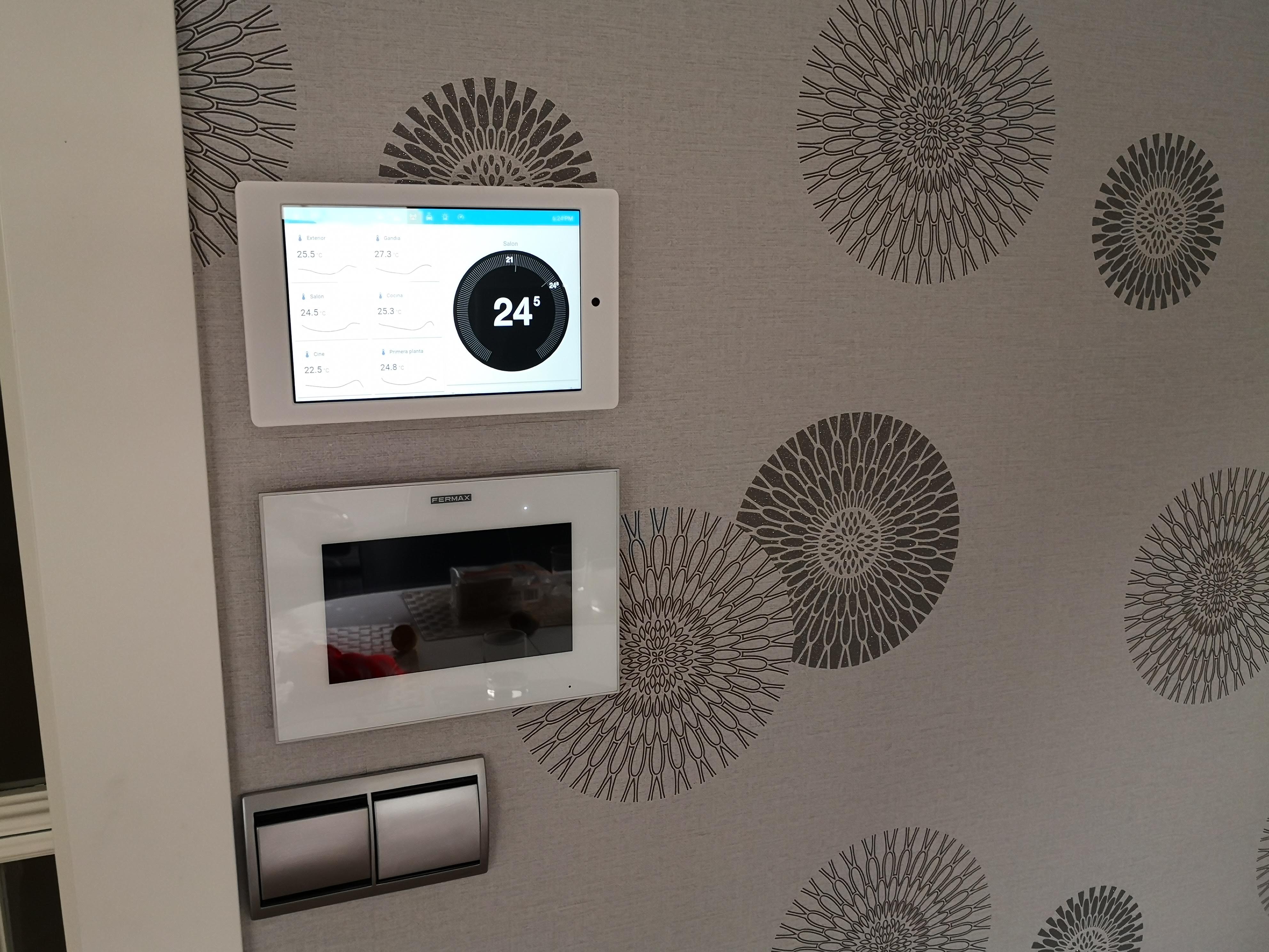

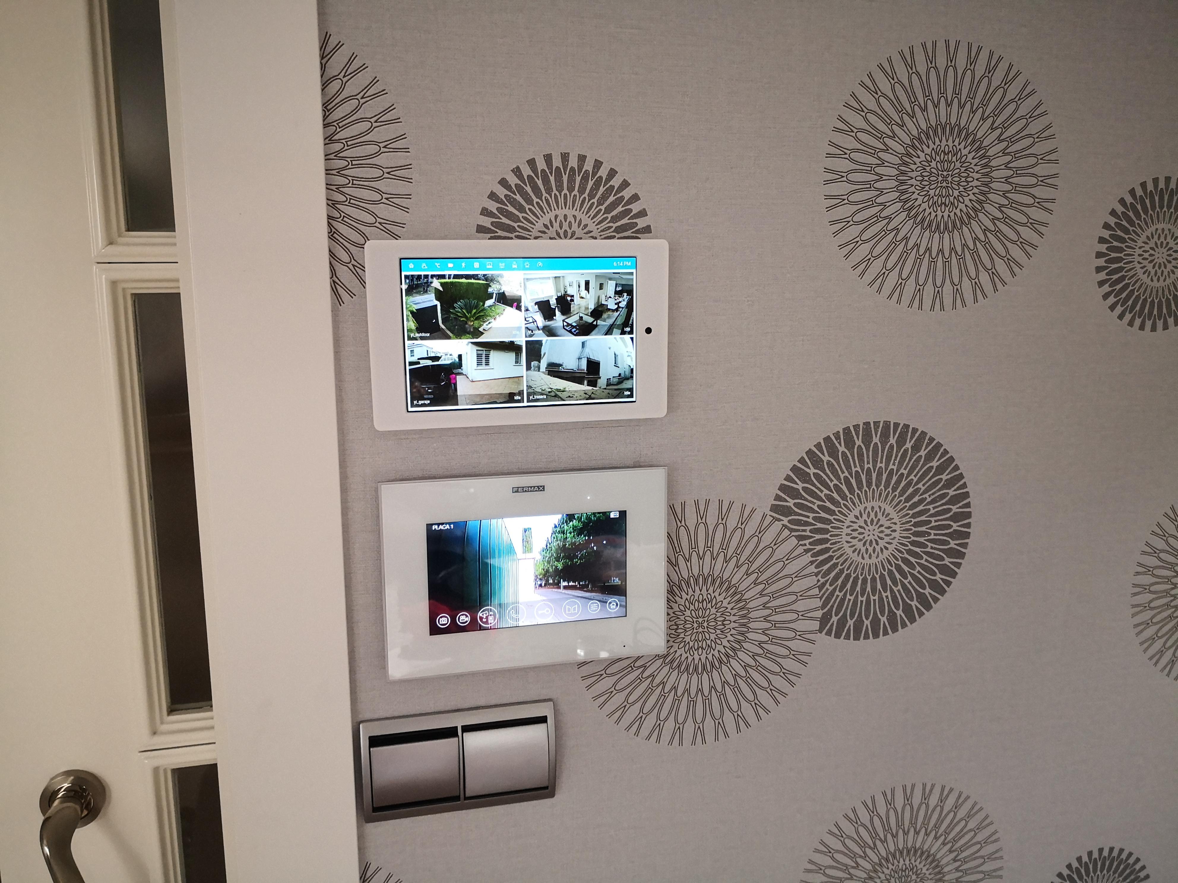

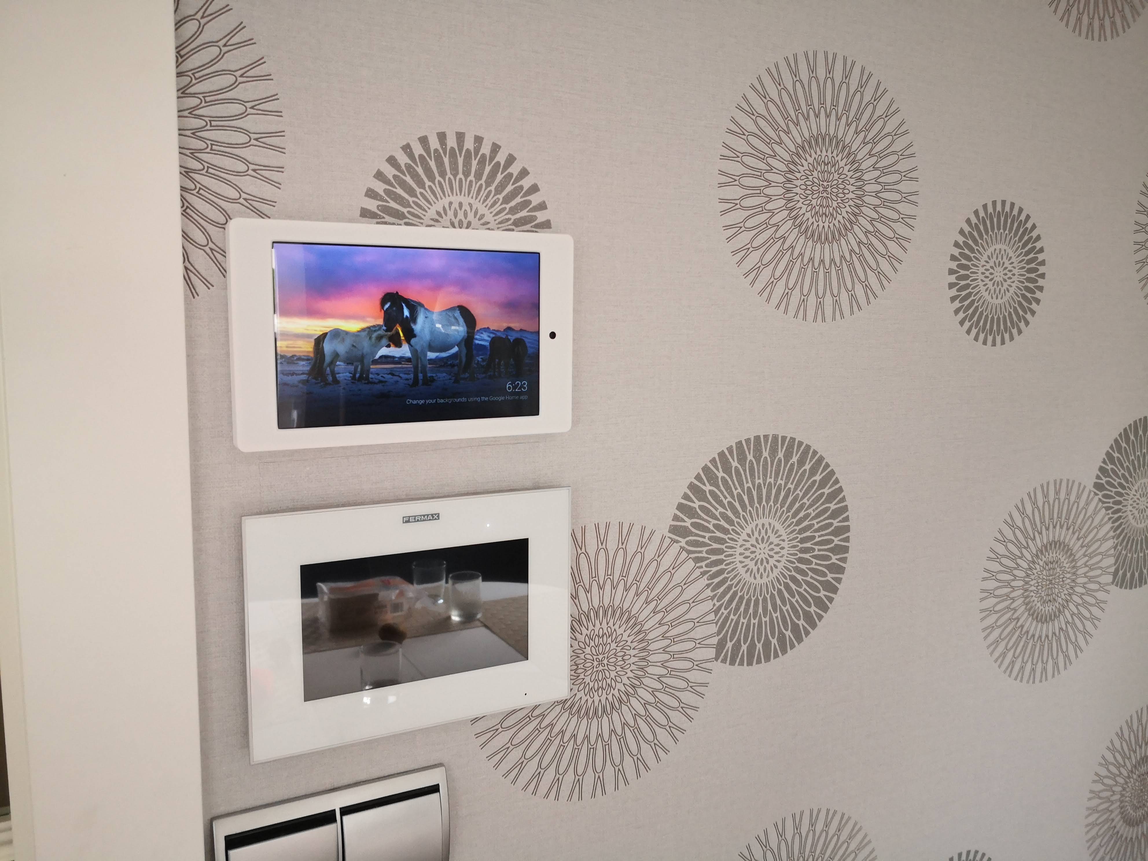

Hi all, I am very happy with the final look of my new smart home panel with home assistant. I want to thank @jaburges for his advises here: https://community.home-assistant.io/t/wall-panel-fire-8-hd-tablet-lovelace-cch-mqtt-alarm-and-video-doorbell-on-ring/133561 regarding a panel installation using an amazon fire HD 8 tablet with an adequate case.
I’ve been able to setup HA with custom lovelace cards using latest amazon firmware version and also latest version of full kiosc. I didn’t need to root the tablet and it’s running great. And the best thing: not a single wire visible!!
Here I share some photos of how it went:

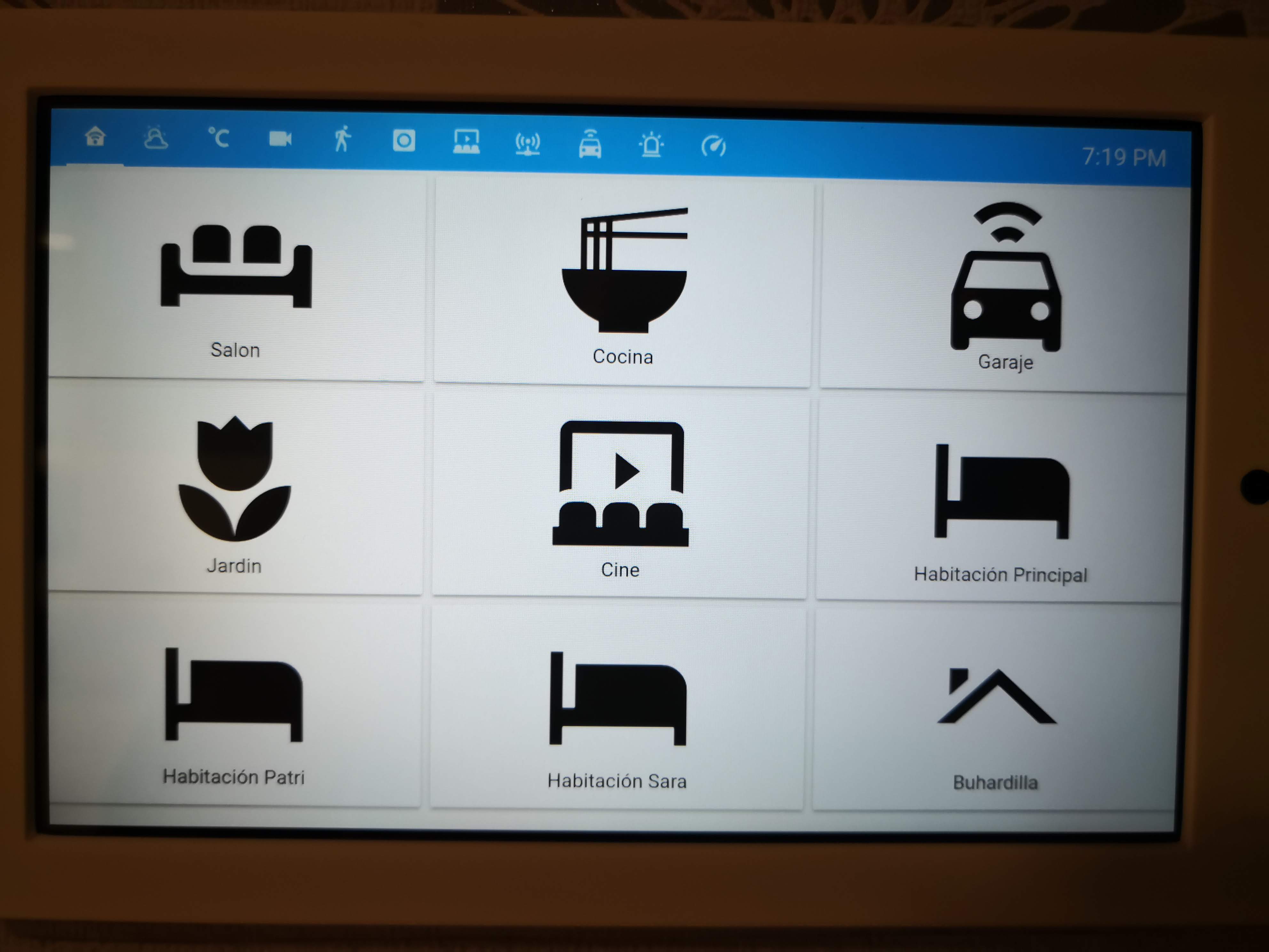

Hi, how did you get the 9 tiles in the second last image.
I cant my cards to display evenly on my fire hd 8 tablet.
thanks
Hi @Glass, take a look at the code below: it’s quite easy I’ve used the custom-button card with and array of 3 horizontal stack cards (with 3 buttons each) inside one unique vertical stack with the option of panel to true, thus you are making 3 rows of 3 elements each inside one single vertical column to be shown in the panel. Here it is the simple code:

Thanks Jorge, can you show me a screenshot of what that looks like if possible.
Thank you
Sure, here it is, this is the effect of that code, displayed by the panel:
I think you were asking for this, weren’t you??
Ah right, its the code for that screenshot above, thank you very much this is exactly what i am after.

One question: what is the second touch display for… The one below your fire tablet?
When I try to access home assistant using the app Fully kiosk browser but comes with nothing on the screen. any ideas?
Thanks @Yoinkz, the second touch display is the interior screen of a video intercom, this one:
https://www.fermax.com/intl/en/pro/products/video-door-entry-systems/kits/SF-2-video-entry-kits-individual-houses-1-or-2-ways-ter/KT-221-1w-video-wayfi-7-kit.html
For me it’s better than a door bell (like ring or nest hello), because it let’s you open the exterior door lock, from that screen or from the mobile wherever you are.
