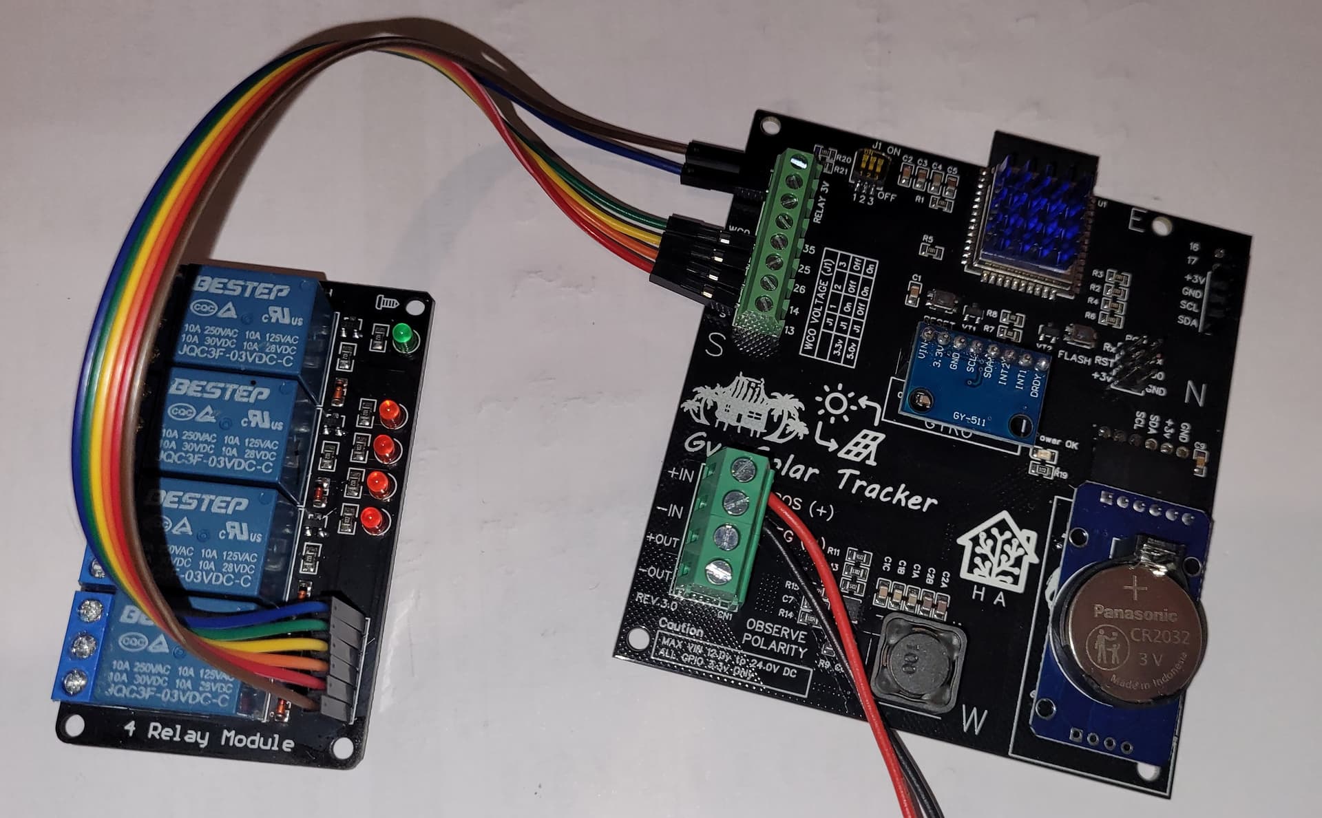

Nice project…I was trying to set up a solar tracker with Ha,but had problem with N/S,because Ha dont use - for south and + for North.
So i went for another Arduino solution,but i can send Rest command by HA to the tracker to control it…for example Wind Parking…or shadow parking using an external light sensor.

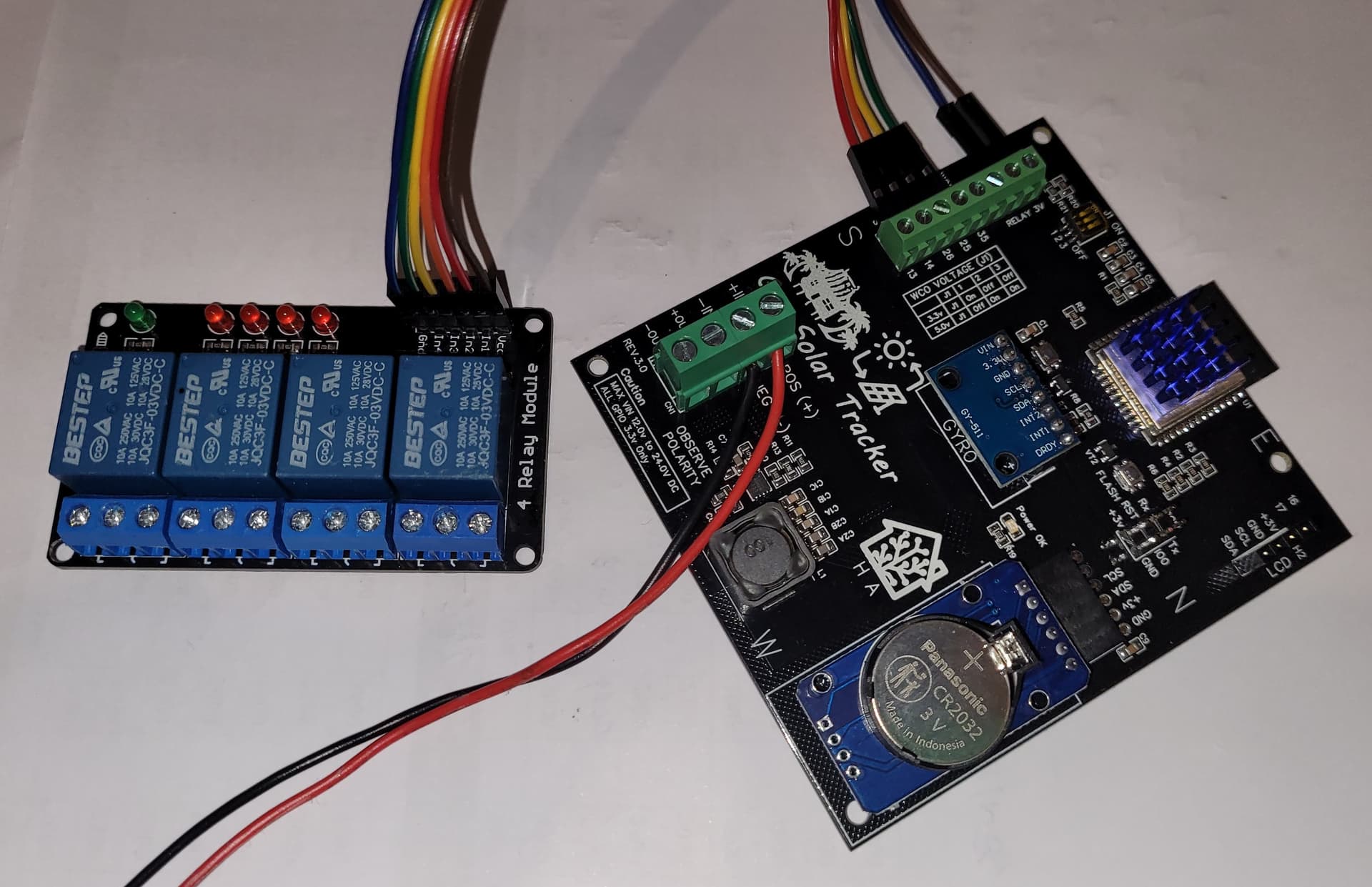

I my project I use an Esp32 ,a gyro and a RTC module with battery to save setting when no electricity.
Annoied from Dupont Cable i decide to create and print an Esp32 board with a Gyro and Rtc Module connector,so they can be replaced and use different Gyro model,have external I2c pin to connect Gps or Lcd screen…and have Terminal screw for better safety.
Input Voltage 12 or 24 volt…
This board can be used also with your project to make things more easy and reliable.
I post a pic,if can help.

Hi…new board and new software are ready.
New Board and software are ready.I put on Ebay:Solar Tracker 2 or 1 Axix Gps Tracking System WiFi Control App Shadow Park set.
This software version have new Shadow Park function:
Es:if in the morning you have shadow on the panel,you can set a different angle and set the time tracker must keep that angle…after that time tracker will return on the original tracking position.
This board have a connector for SH1106Wire display with this pins, in order: SDA-SCL-GND-3.3V.

This board runs on my software,not Ha…but you can load it if you need.
You can inport my Tracker web UI in homeassistant and control it from HA.
You can set Maximum and Minimum angle for both axix.This function act as a limit switch.
You can easily use it with the actuators you already have; the stroke isn’t much, and the actuators have internal limit switches in the fully closed and fully open positions, so you don’t risk damaging them.
I use it from 2021 and is working perfectly.
The important think is to position the Tracker board not near AC wires and Iron beams,because electromagnetic fields can interfere with gyroscope.
