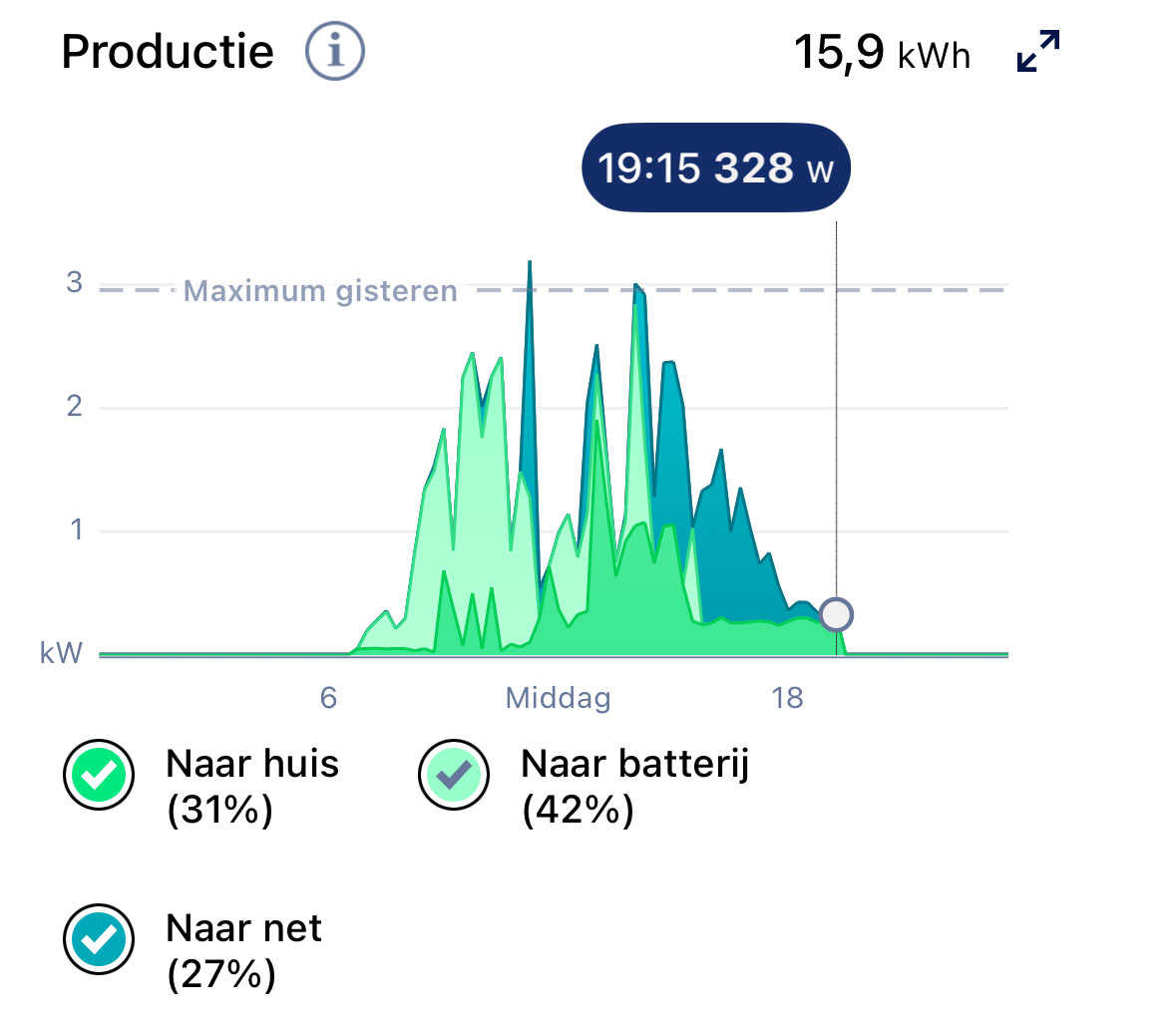

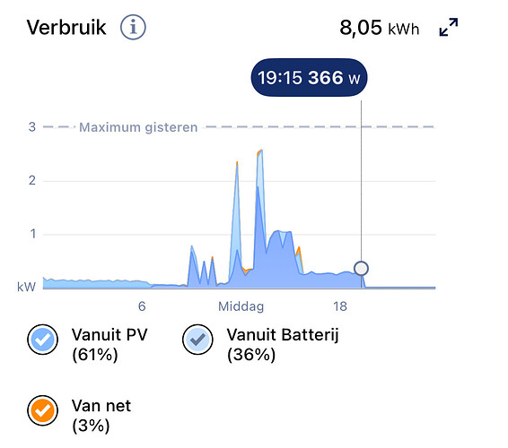

I created a case with SolarEdge, and after some convincing that their numbers where wrong, they admitted that there was a problem:
Our monitoring system displays data based on numerous calculations and algorithms, and lately, we’ve noticed that this isn’t always calculated correctly on our end.
This is a long-standing bug in our monitoring portal.
A completely new monitoring system will be rolled out in the near future that will resolve these types of issues.

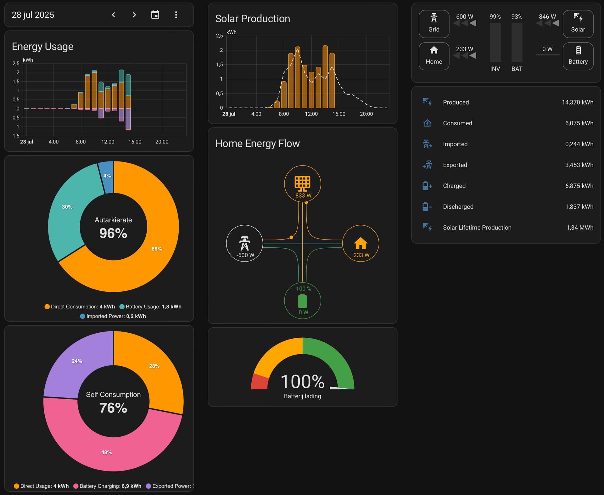

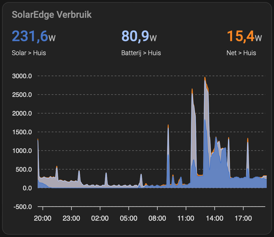

So left with nothing to see what my system was doing, I searched for a solution. The HA original integration “SolarEdge Local” didn’t work for me. So HACS to the rescue. There I found “SolarEdge Modbus”. But this didn’t worked also. And so I came to “SolarEdge Modbus Multi” and this one worked! I asked my installer to enable the Modbus TCP in my inverter and got to work.
This integration gave me a bunch of numbers, but I soon noticed that it didn’t gave me all the numbers I was looking for. Especially what my solar panels were doing, and where the power went. So more searching and reading. And that’s how I ended up with Remko’s post.
But… Like so many times getting it all to work wasn’t straightforward. The naming of my entity’s didn’t correspond with Remko’s. The recorder part shutdown all other recordings. Some naming was different. Dashboard was in the old style and many more things. Also I missed some key information in the main post, so I had to read a lot to get everything working.
So in this post I will try to give a complete manual of everything I did. If you see anything wrong, let me know!

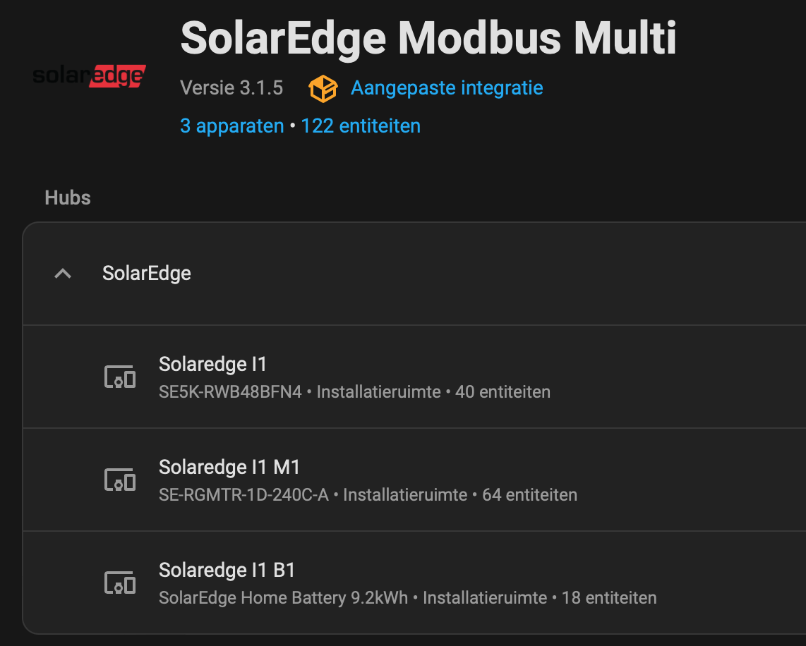

I’ll assume that you already have Modbus TCP acces to you’re inverter and you have HACS installed in you’re Home Assistant.

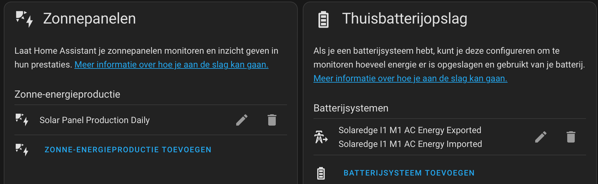

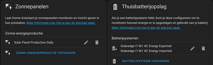

  1. With HACS install the “SolarEdge Modbus Multi”. Then in “Integrations” add the “SolarEdge Modbus Multi”. I use 10 sec for ‘call frequency’ (haven’t had any problems with this high frequency), but you can change that if you want. I checked the boxes for “Automatic meter detection” and “Automatic battery detection” and left the others unchecked or standard.
Now this is key!! The naming of my devices is “Solaredge I1”, “Solaredge I1 M1” and “Solaredge I1 B1”. So an entity within my meter looks like this: sensor.solaredge_i1_m1_ac_power. This is key, because that’s where my files are based on.

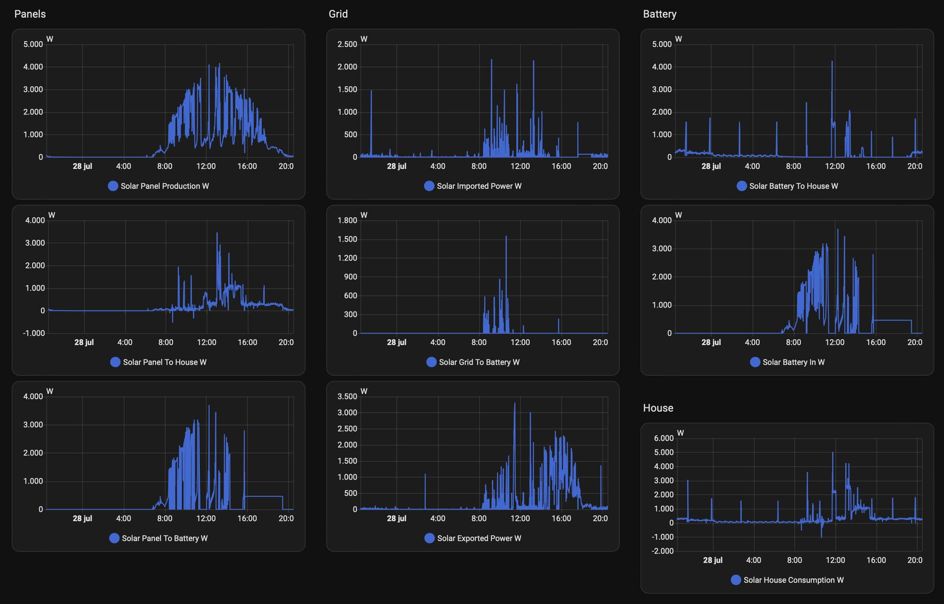

  1. From the GitHub Remko’s created I only used 3 files: “energy_utilities.yaml”, “energy_stats.yaml” and "“electricity.yaml”. I changed the naming of the entities to mine, and also deleted some code that I didn’t find necessary like weekly numbers. Here are the 3 files: (check different entity names in the code below if they correspond to your entities!!)
electricity.yaml

That’s it! In my next post I’ll share what to put in your Energy dashboard, Remko’s adjusted dashboard with the right entity names and other helpful tips.
Energy Dashboard
For the Solar panels I use: Solar Panel Production Daily (sensor.solar_panel_production_daily)
For Battery export I use: Solaredge I1 M1 AC Energy Exported (sensor.solaredge_i1_m1_ac_energy_exported)
For Battery import I use: Solaredge I1 M1 AC Energy Imported (sensor.solaredge_i1_m1_ac_energy_imported)
In one of the post in Remko’s post (Solaredge Modbus Configuration for Single Inverter and Battery - #45 by Remko) it said to use “sensor.solaredge_i1_ac_energy_kwh” for your solar panels, but somewhere else I found that current sensor I’m using. Try for yourself what gives you the best result.
Sample Dashboard
In Remko’s first post he gives a sample of his “Energy Dashboard”. I edited it with the right entity names:
With this code:

SolarEdge Usage:
type: custom:apexcharts-card
graph_span: 24h
update_interval: 5min
cache: false
apex_config:
  chart:
    stacked: true
    stackOnlyBar: false
  legend:
    show: false
  grid:
    show: true
    borderColor: "#666666"
all_series_config:
  stroke_width: 1
  type: area
  group_by:
    func: avg
    duration: 15m
header:
  show: true
  title: SolarEdge Verbruik
  show_states: true
  colorize_states: true
series:
  - entity: sensor.solar_panel_to_house_w
    color: "#4774cc"
    name: Solar > Huis
  - entity: sensor.solar_battery_to_house_w
    color: "#a6c3ff"
    name: Batterij > Huis
  - entity: sensor.solar_grid_to_house_w
    color: "#ff8800"
    name: Net > Huis

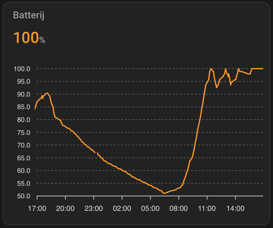

Battery state:
graph_span: 24h
apex_config:
  legend:
    show: false
  grid:
    show: true
all_series_config:
  stroke_width: 2
header:
  show: true
  title: Battery
  show_states: true
series:
  - entity: sensor.solaredge_i1_b1_state_of_energy
    show:
      name_in_header: false
These 3 will give you the following cards:
This seems to correspond to the SolarEdge Monitoring app:

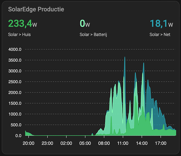

Update: I corrected the 2 Apexcharts Production and Usage.
Additionally if you want a Dashboard with all your solar sensors:

This will give you this dashboard:
Very handy when looking for the right ones! :sweat_smile:

Your YAML files seemed to work because the naming of your devices are the same as mine with the exception of batteries 1 and 2.

Or maybe show us a screenshot of your Modbus device. Then perhaps @WillCodeForCats can help

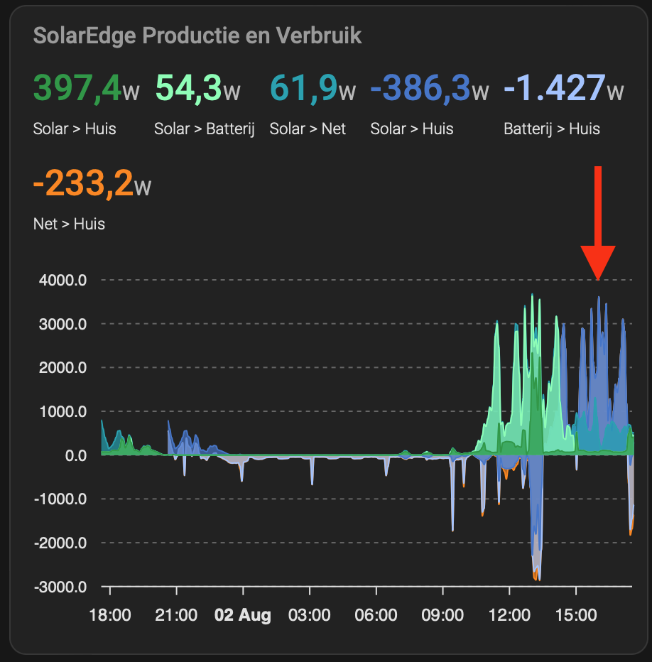

I wanted to try something, I want the 2 Apexcharts “Production” and “Usage” in 1, just like in the Monitoring app. After a lot of reading I think I figured it out:
Place this code in your “electricity.yaml” (I placed it at line 227)
  #Negative Sensors
    - name: "Solar Panel To House W Negative"
      unique_id: solar_panel_to_house_w_negative
      unit_of_measurement: "W"
      icon: mdi:solar-power
      state: >
        {{ states('sensor.solar_panel_to_house_w') | float * -1 }}
    - name: "Solar Battery To House W Negative"
      unique_id: solar_battery_to_house_w_negative
      icon: mdi:battery-negative
      state: >
        {{ states('sensor.solar_battery_to_house_w') | float * -1 }}
    - name: "Solar Grid To House W Negative"
      unique_id: solar_grid_to_house_w_negative
      icon: mdi:transmission-tower-export
      state: >
        {{ states('sensor.solar_grid_to_house_w') | float * -1 }}
This will take the 3 Watt sensors, create new ones and convert them to negative

Now you have the same graph as in the SolarEdge Monitoring app!
It works, but I get some ‘ghosting’ effect. The blue under the red arrow shouldn’t be there:
Anyone idea’s? I asked the same question here: ApexCharts card - A highly customizable graph card - #4576 by jrebergen
I had this before, but the cache: false solved it. Now it doesn’t anymore.
It doesn’t seem to work. I think stacking gets confused.
