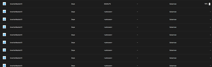

Hi. I tested yesterday last version
New device was added
But sensor in device not working
Hi @000al000, that long serial number indicates that you are not using latest version of the profile for some reason:
fix: Battery X Serial Number decoding rule in Deye
Working after redownload throught HACS! Thank you
May be you known how remove “old battery”, that was added by previuos version of integration?
And i have strange device that contain “Battery 9” and “Battery 10” in one device, and i have only 8 battery :slight_smile:
Hi @000al000, thanks for your report. I fixed it in this commit, so it will be part of the next release. :wink:
