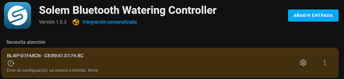

Hello @hcraveiro:
Same problem here. Connecting via bt-proxy (ESP-WROOM-32)
Logs:
Registrador: custom_components.solem_bluetooth_watering_controller.api
Fuente: custom_components/solem_bluetooth_watering_controller/api.py:412
integraciĂłn: Solem Bluetooth Watering Controller ([documentaciĂłn](https://github.com/hcraveiro/Home-Assistant-Solem-Bluetooth-Watering-Controller))
OcurriĂł por primera vez: 20:29:10 (6 ocurrencias)
Ăšltima vez registrado: 20:31:46
Error processing Forecast Weather data: JSON format invalid!
Traceback (most recent call last): File "/config/custom_components/solem_bluetooth_watering_controller/api.py", line 412, in get_forecast (index for index, forecast in enumerate(self._cache_forecast) ~~~~~~~~~^^^^^^^^^^^^^^^^^^^^^^ TypeError: 'NoneType' object is not iterable

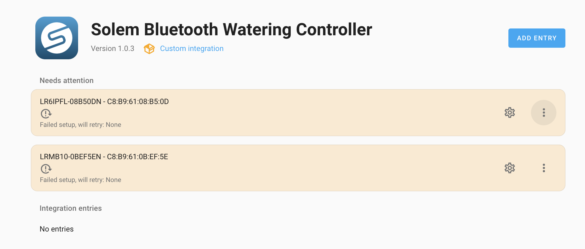

@cfrancio yes, I’ve build a Bluetooth proxy with ESP32. Both the LR-IP and the LRMB10 are visible but once configured in HA, no luck. The plugin is only working for BLIP for the moment, hence my proposal to assist the developer.

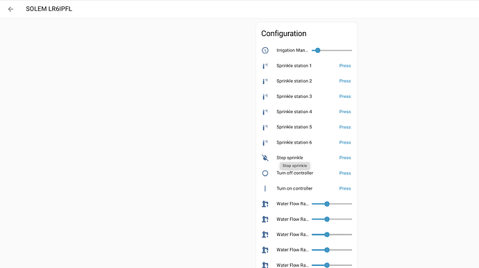

little update on my own post. After updating to the latest version and using the mac adress of my LR-IP, the configuration goes till the end and creates lots of sensors and actionable buttons
but so far none seems to reach my LR-IP.
Let me know if you want help to debug

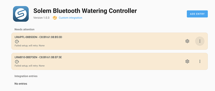

Just like Frédéric (Fvanoost), I am trying to connect Home Assistant to my LRMB10 (LoRa/Ethernet gateway) for my pool and upcoming irrigation system. I've already installed the toolkit, but as expected, I am getting the Device not found error during the Bluetooth scan because the LRMB10 handles communications differently once it's set up on the network.
I really want to help bridge the gap between your integration and the LoRa/LRMB10 lineup. While I am not a developer and cannot code, I am more than happy to contribute as an active tester!
Let me know if you are interested in exploring the LRMB10/LoRa side, I'd be glad to be your tester on this!
Hi all, great work @hcraveiro on the Bluetooth integration :+1:
For everyone in this thread who hit a wall with LR-IP / LR-IS controllers and the LR-MB (LRMB10) gateway: those are LoRa devices, so Bluetooth can't reach them. I built a separate integration that talks to them through the MySOLEM cloud (the same API the mysolem.com app uses), so it's complementary to the BLE one rather than a replacement.
