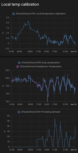

I ended up with my own automation - just adjusting differences via local_temp_calibration.
alias: TRVDefneRoomExtTempSensorSync
description: ""
trigger:
  - platform: state
    entity_id:
      - sensor.0x00158d000950a9d2_temperature
    attribute: temperature
  - platform: state
    entity_id:
      - sensor.2floordefroomtrv_local_temperature
condition: []
action:
  - variables:
      tempcalc: >-
        {{(states('sensor.0x00158d000950a9d2_temperature')|float(0)|round(1) -
        (states('sensor.2floordefroomtrv_local_temperature')|float(0) -
        states('number.0x18fc2600000c99e1_local_temperature_calibration')|float(0)))|round(1)}}
  - if:
      - condition: template
        value_template: >-
          {{tempcalc !=
          states('number.0x18fc2600000c99e1_local_temperature_calibration')|float(0)}}
    then:
      - service: number.set_value
          value: "{{tempcalc}}"
          entity_id: number.0x18fc2600000c99e1_local_temperature_calibration
mode: queued
max: 3
