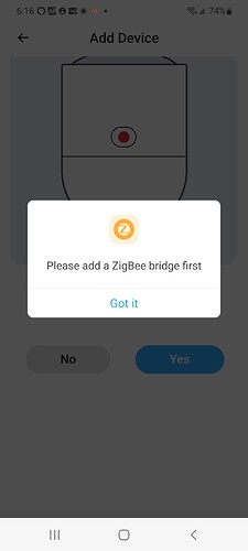

Has anyone gotten past this step in the eWelink app without a Sonoff hub?

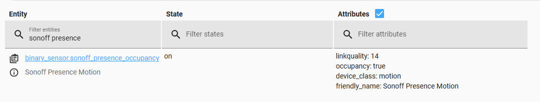

UPDATE. “Worse, it never goes ‘occupancy: false’. It is always ‘true’.” is INCORRECT.
In my test setup, I forgot that it sees through walls and my dog was on the bed on the other side of the wall.
But still, without being able to use the eWelink app I can’t “tune” the sensitivity. And the timing? It takes 8 minutes from ‘on’ to time out and turn off.

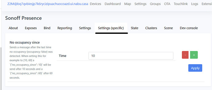

Under Manage Device I found a cluster that seems to correspond to the 60sec delay between occupied and not occupied. Not sure if this is something that can be adjusted or not.
Update: I wrote a value of 30 and it changed to 30seconds as expected. Will experiment with shorter value to see how well it behaves.
Update 2: It seems 10 seconds and 20 seconds do not work, I stop getting any changes to the occupied status when I set with those values, maybe 30seconds is the minimum.
