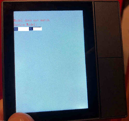

I try to install 4.0.2 over wifi but probably brick my device.
LCD shows: "
Model does not match
Device Model :
XXXXXXX
Any advice ?

After multiple attempts I’ve managed to get the blank tft file on my NS Panel (shows the QR code).
I did. it takes you to the Github page describing the blank tft file and wat to do next. Pretty cool idea really.
I’l try once more to flash the proper tft file but I haven’t had success so many times I’m not very optimistic. My other NS Panel went smoothly the first time.
With the blank tft file loaded: (display is connected, good)
With the us.tft file in the ESP code and 2 hours after pressing ‘update tft’:
Back to the long/never completing upload.
Do we know why this sometimes happens?

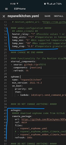

I tried to implement it however it does not turn the relay on and off automatically. When I look at the log the “Mode:off” is visible even when the target temp is above the room temp. I looked into the “How to” and there was a statement:
" You will need to add the reference to addon_climate_heat or addon_climate_cool files on your ESPHome settings in the package section and after te remote_package (base code), as shown bellow (for heat in this example):"
I think I missing these files in my local HA install. Could someone help me with where these files should be stored locally so that the automation works? In the below screenshots you can see the Thermostat state is Off even when the target is above room temp.
