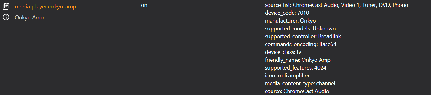

Could you please go to Developer Tools, tab States, then look for this entity and let me know what it is in its attributes? Ims specially interested on the supported_features attribute.
By the way, which integration are you using for this media player device?
That would be awesome. In fact, there are some GPIO probably available (gpio2, gpio23?) so finding a pin for your mic might not be an issue.
So this is an old AV receiver which I’m controlling via SmartIR with a Broadlink IR blaster. Basically HA can only send it commands for power, volume, mute and input selection, then expect that it got through. For volume it can therefore only give up and down commands with no knowledge of the actual volume level. In media cards this normally just give up and down buttons rather than a slider.

Supported features is 4024:
    PAUSE = 1
    SEEK = 2
    VOLUME_SET = 4
  ->VOLUME_MUTE = 8
  ->PREVIOUS_TRACK = 16
  ->NEXT_TRACK = 32
  ->TURN_ON = 128
  ->TURN_OFF = 256
  ->PLAY_MEDIA = 512
  ->VOLUME_STEP = 1024
  ->SELECT_SOURCE = 2048
    STOP = 4096
    CLEAR_PLAYLIST = 8192
    PLAY = 16384
    SHUFFLE_SET = 32768
    SELECT_SOUND_MODE = 65536
    BROWSE_MEDIA = 131072
    REPEAT_SET = 262144
    GROUPING = 524288
    MEDIA_ANNOUNCE = 1048576
    MEDIA_ENQUEUE = 2097152
We use volume set to define if volume buttons are shown, but I understand in your case volume up/down buttons should be there.
Volume step is probably the best one in this case, but that will require changes in the service calls also, as currently the +/- also use volume set service.
I will take a look at this.
