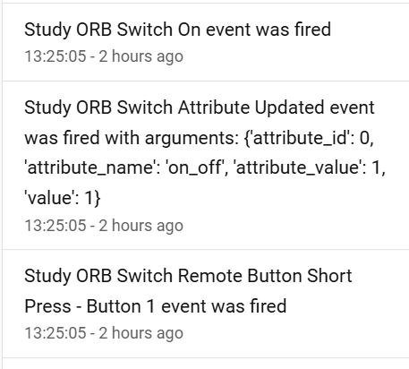

I’ve had this Blueprint working for a while, but it seems to have stopped working in the last week or so.
I can see the events firing correctly in the Device Activity
There seems to be 3 events each time I press a button and this triggers 3 runs in the automation. However, for each run the Command never matches what the automation is expecting.
The Endpoint ID is matching the button. This is from the trace of the first of three:
event:
event_type: zha_event
device_ieee: a4:c1:38:10:4b:c2:ff:ff
device_id: 0a3fa0325743994dac5f501d8b1d9a49
unique_id: a4:c1:38:10:4b:c2:ff:ff:1:0xfc12
endpoint_id: 1
cluster_id: 64530
command: single
args: {}
params: {}
The next one:
event:
unique_id: a4:c1:38:10:4b:c2:ff:ff:1:0x0006
endpoint_id: 1
cluster_id: 6
command: attribute_updated
args:
attribute_id: 0
attribute_name: on_off
attribute_value: 1
value: 1
params: {}
The final one:
event:
endpoint_id: 1
cluster_id: 6
command: ‘on’
args:
params: {}
This is from the device Zigbee info:
Quirk: zigpy.quirks.v2.CustomDeviceV2
I was given the option to update the firmware of the SNZB-01M today and it was when I pressed a button to wake it up that I realised the automation wasn’t working. The update completed anyway and I’m now running: 0x00001100

change the code
Save it as sonoff_snzb01m_zha.yaml in /config/blueprints/automation/3jam3/, rename the old file to sonoff_snzb01m_zha_old.yaml, then open the automation and click Save to reload

Here is my experience:
  • I installed the official quirk from sonoff’s website and connected the orb with ZHA.
  • I was able to update the firmware by getting related close to the bridge, and pressing a button to wake it up, then pressed ‘Update Firmware’ on HA’s dashboard.The OP’s blueprint didn’t work for me.
  • Updating this blueprint with Alex’s worked.
My only concern is that the first action, which is the one that wakes the orb, has a big delay. Sequential pressing of bottons are fast enough, tho.
