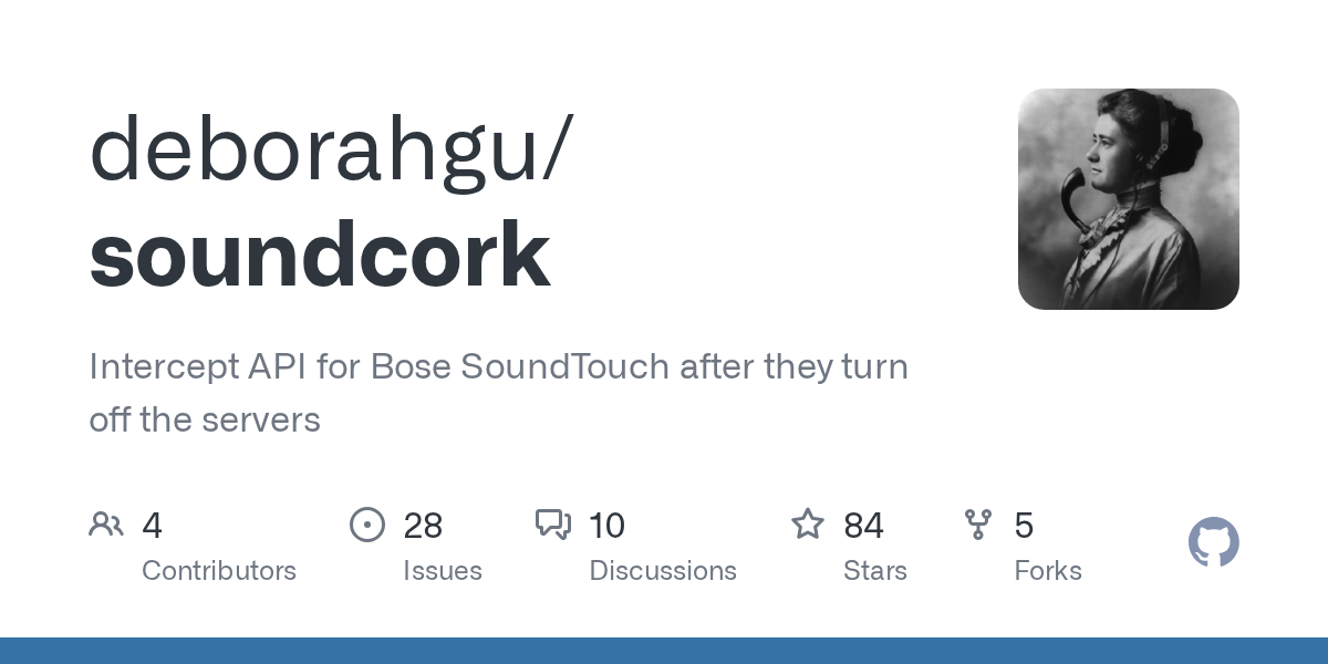

This is very interesting
They found a way (hack) to change the cloud link in the Soundtouch devices and provide a locally hosted cloud to still have internet radio (presets don’t seem to work yet as of 27/01/2026).
