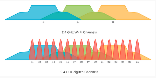

This is how channels map onto each other:
My Zigbee channel is 20 right now. These are fresh diagnostics. I see yours is 89! Doesn’t that cause problems?

Is there wifi that is not on 1,6,11?
Well, my Zigbee channel is a lot noisier than yours, but it seems quite solid (touch wood).
Have you tried a few more routers? The idea is to blanket the house with connections - even if you have them spread evenly, they may not be doing that.
This is just 2.4 GHz wi-fi, which many IoT devices insist on, unfortunately.
My wifi is on channel 1. I do not have much surrounding networks from neighbors.
