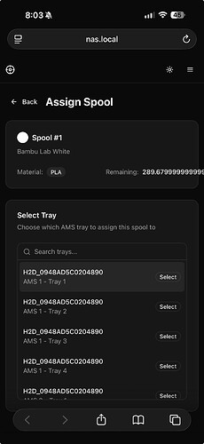

When scanning one of my generated QR codes on mobile (via Safari on my iPhone), the value displayed in the “Remaining:” field has a very long number after the decimal point and runs off the screen:
Perhaps it would make sense to only display the remaining weight in grams rounded up/down to the nearest full integer? (e.g. 290g instead of 289.6799999999997g)
