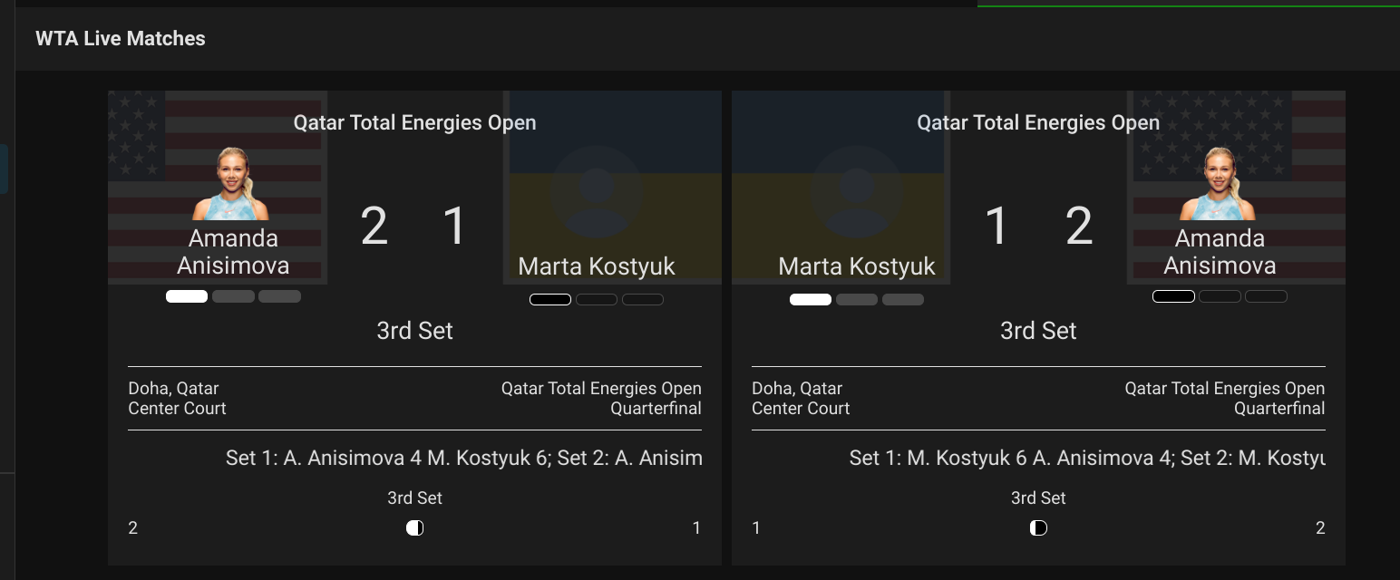

              So I was curious how Tennis works with TeamTracker because they are individuals and not teams.  It would be cool if you could just have teamtracker do events instead of individuals or some other method to simplify the code but I am not sure how that would work.
Anyway for fun I looked at https://site.web.api.espn.com/apis/site/v2/sports/tennis/atp/scoreboard  to see what players were either in pre/in/post mode which is one of the items TT keys off of.  I saw a couple and put them into my tennis.yaml sensor file.  Here are the 4 I grabbed (I am not doing all 150 and would love to have someone post it if they get an itch to create them and I would put them on my github site).
- platform: teamtracker
  league_id: "ATP"
  team_id: "Jannik Sinner"
  league_id: "ATP"
  team_id: "Luca Nardi"
  league_id: "ATP"
  team_id: "Benjamin Bonzi"
  league_id: "ATP"
  team_id: "Manuel Guinard"

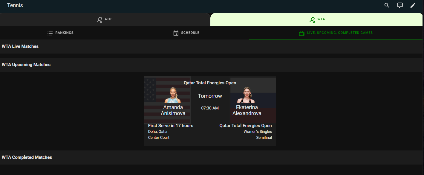

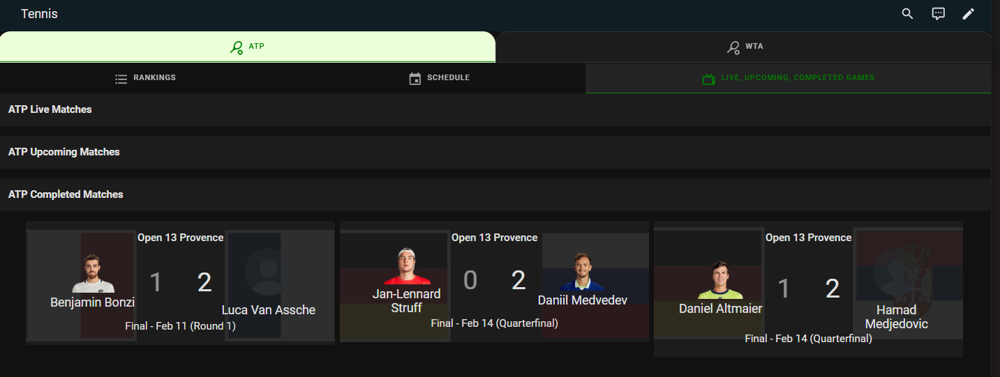

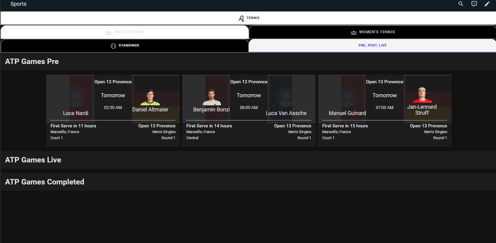

I changed up my Sandbox - Tennis dashboard to use post the TT cards if available.  I like to keep things compact so here is what it looks like now.
Here is what the TT card tabs look like.

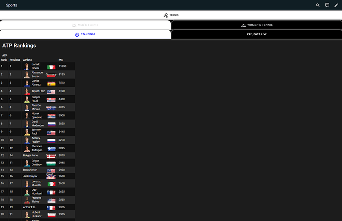

Here is the Sandbox dashboard code for any interested:

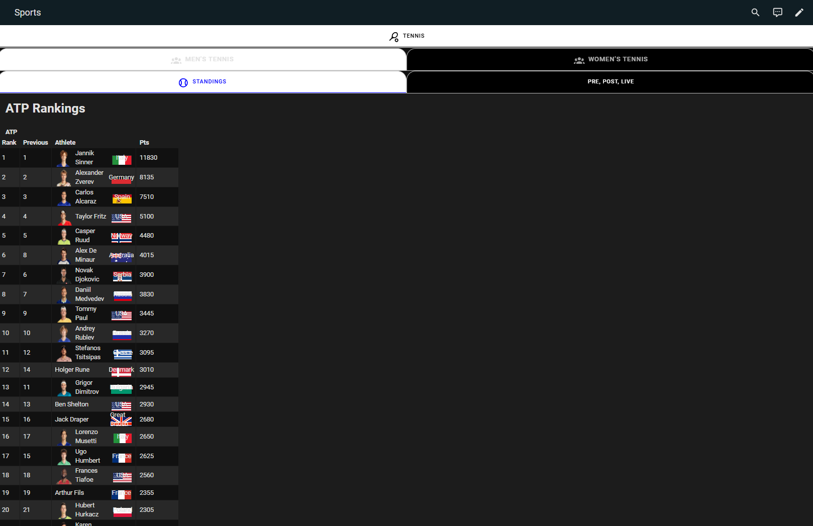

decluttering_templates:
  bpl_settings:
    card:
      type: custom:flex-table-card
      title: '[[title]]'
      css:
        table+: 'padding: 0px; width: 400px;'
        tbody tr td:first-child: 'width: 1%;'
        tbody tr td:nth-child(2): 'width: 1%;'
        tbody tr td:nth-child(3): 'width: 20%;'
        tbody tr:hover: 'background-color: green!important; color:white!important;'
      card_mod:
        style:
            ha-card {
              overflow: auto;
            .card-header {
               padding-top: 6px!important;
               padding-bottom: 4px!important;
               font-size: 14px!important;
               line-height: 14px!important;
               font-weight: bold!important;
      entities:
        include: '[[entity]]'
      sort_by: ranks
      columns:
        - name: Rank
          data: ranks
          modify: x.current
        - name: Previous
          data: ranks
          modify: x.previous
        - name: Athlete
          data: ranks
          modify: >-
            '<div
            style="display:flex;justify-content:space-between;align-items:center;">'
            + '<div style="display:flex;align-items:center;">' + (typeof
            x.athlete.headshot !== 'undefined' ? '<img src="' +
            x.athlete.headshot + '"
            style="width:40px;height:40px;margin-right:5px;">' : '') +
            x.athlete.displayName + '</div>' + '<div style="background-image:
            url(' + (typeof x.athlete.flag !== 'undefined' ? x.athlete.flag :
            '') + '); background-size: cover; background-repeat: no-repeat;
            height: 30px; width: 50px; display: flex; align-items: center;
            justify-content: center;">' + (typeof x.athlete.flag !== 'undefined'
            ? x.athlete.flagAltText : '') + '</div>' + '</div>'
        - name: Pts
          data: ranks
          modify: x.points
  game_stats:
    card:
      type: custom:auto-entities
      unique: true
      show_empty: false
      card:
        type: custom:layout-card
        layout_type: masonry
        width: 200px
        max-columns: 5
      card_param: cards
      filter:
        template: |
          {%- for team in integration_entities("teamtracker") -%}
            {%- if state_attr(team, "league") == "[[sport]]" -%}
               {%- if states(team) == "[[status]]" -%}
                    {{{"type": "custom:teamtracker-card",
                      "entity": team,
                      "home_side": "right"}}},
              {%- endif -%}
            {%- endif -%}
          {%- endfor -%}
        exclude:
          - entity_id: '*team_tracker*'
      sort:
        method: attribute
        attribute: date
views:
  - theme: Backend-selected
    title: Sports
    type: panel
    icon: mdi:strategy
    badges: []
    cards:
      - type: custom:mod-card
        card_mod:
          style:
            tabbed-card $: |
              mwc-tab {
                background: black;
                color: silver;
                border-color: var(--ha-card-border-color, var(--divider-color, #e0e0e0));
                border-width: 2px;
                border-style: solid;
                overflow: hidden;
                width: 20%;
              mwc-tab[active] {
                background: white !important;
                color: black !important;
        card:
          type: custom:tabbed-card
          styles:
            '--mdc-theme-primary': black
            '--mdc-tab-text-label-color-default': silver
            '--mdc-typography-button-font-size': 12px
          tabs:
            - attributes:
                label: Tennis
                icon: mdi:tennis
              card:
                card_mod:
                  style:
                    tabbed-card $: |
                      mwc-tab {
                        background: black;
                        border-color: silver;
                        border-width: 2px;
                        border-top-left-radius: 20px;
                        border-top-right-radius: 20px;
                        overflow: hidden;
                        width: 15%;
                      mwc-tab[active] {
                card:
                  card_mod:
                    style:
                      tabbed-card $: |
                        mwc-tab {
                          background: black;
                          border-width: 2px;
                          overflow: hidden;
                          width: 10%;
                        mwc-tab[active] {
                  tabs:
                    - attributes:
                        label: Men's Tennis
                        icon: mdi:account-group
                      card:
                        card_mod:
                          style:
                            tabbed-card $: |
                              mwc-tab {
                               background: black;
                               border-width: 2px;
                               overflow: hidden;
                               width: 15%;
                              mwc-tab[active] {
                        card:
                          styles:
                            '--mdc-theme-primary': blue
                            '--mdc-tab-text-label-color-default': white
                          tabs:
                            - attributes:
                                label: Standings
                                icon: mdi:tennis-ball-outline
                              card:
                                type: custom:stack-in-card
                                mode: vertical
                                cards:
                                  - type: markdown
                                    content: |
                                      <h1>ATP Rankings</h1>
                                  - type: custom:decluttering-card
                                    template: bpl_settings
                                    variables:
                                      - title: ATP
                                      - entity: sensor.tennis_atp_ranking
                            - attributes:
                                label: Pre, Post, Live
                              card:
                                type: horizontal-stack
                                cards:
                                  - type: vertical-stack
                                    cards:
                                      - type: markdown
                                        content: |
                                          <h1>ATP Games Pre</h1>
                                        template: game_stats
                                        variables:
                                          - sport: ATP
                                          - status: PRE
                                      - type: markdown
                                        content: |
                                          <h1>ATP Games Live</h1>
                                        variables:
                                          - sport: ATP
                                          - status: IN
                                      - type: markdown
                                        content: |
                                          <h1>ATP Games Completed</h1>
                                        variables:
                                          - sport: ATP
                                          - status: POST
                    - attributes:
                        label: Women's Tennis
                      card:
                        cards:
                            cards:
                              - type: markdown
                                content: |
                                  <h1>WTA Rankings</h1>
                                variables:
                                  - title: WTA
                                  - entity: sensor.tennis_wta_ranking

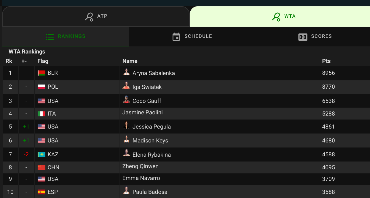

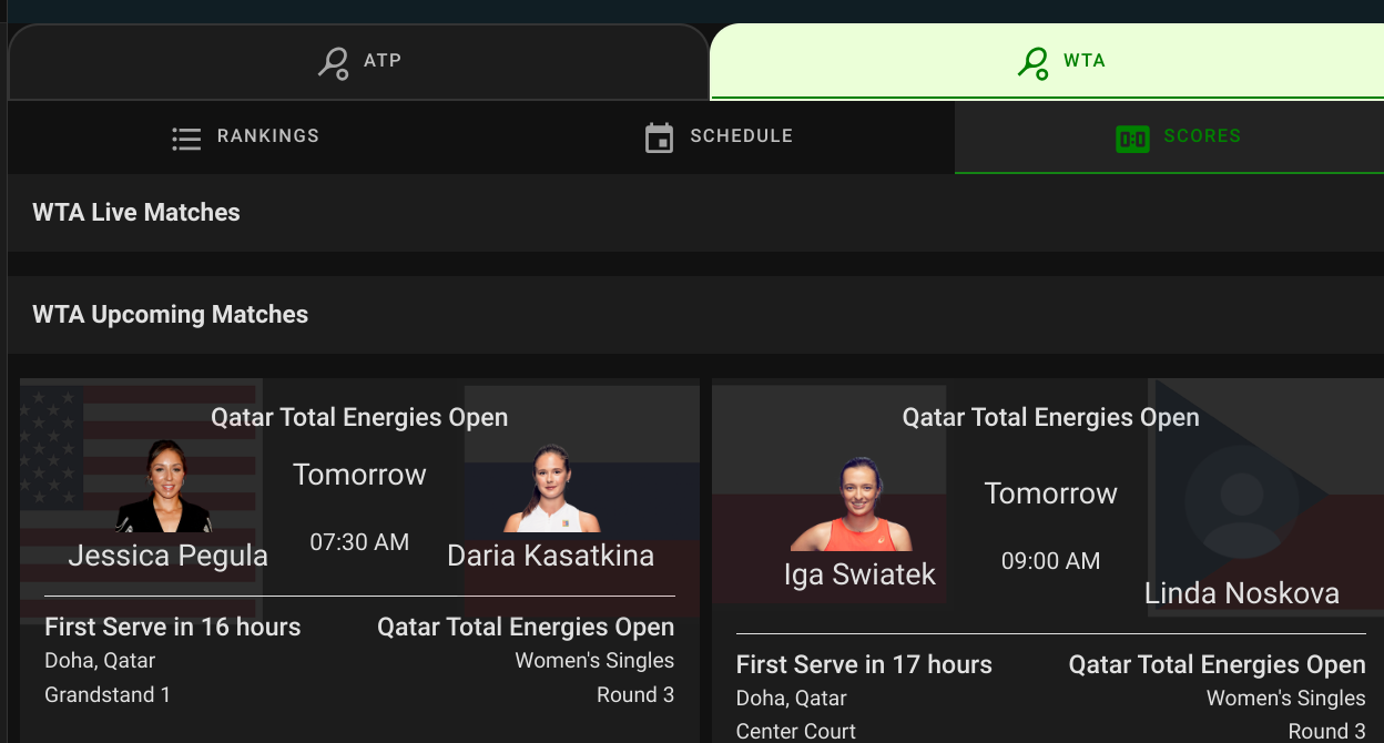

More for fun than anything else
              For tennis tracking, Iāve gotten rankings, upcoming tournament schedule and scores all pulled together for ATP and WTA. Here are some screenshots:
I have created player specific teamtracker sensors for those that I want to follow ā since there isnāt a āteamā type list, players coming in/out of the top 25 or so will always be a moving target ā I donāt have a solution for that.
Outside of the teamtracker sensors for individual players, I created four sensors to pull in the rankings and tournaments, as follows. The rankings only update once per week (Monday mornings) and Iāve got another automation to update them at that time.
## ATP Rankings

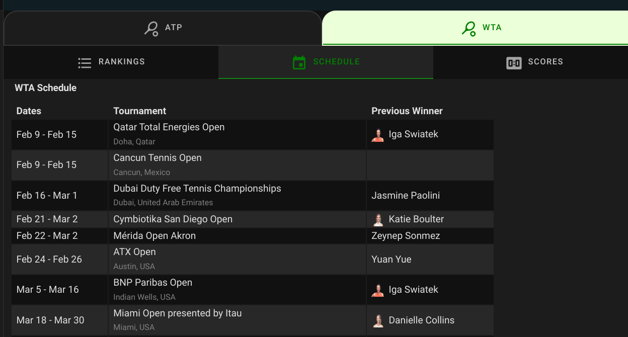

For the schedule sensors, I added the dates variable to the api url and it brings back each tournament from today through the end of the year.
Here is the yaml:

      entities:
      sort_by: ranks
      columns:
        - name: Rk
          data: ranks
          modify: x.current
        - name: +-
          data: ranks
          modify: >-
            '<div style="color:' + (x.trend > 0 ? 'green' : x.trend < 0 ? 'red'
            : 'white') + ';">' + x.trend + '</div>'
        - name: Flag
          data: ranks
          modify: >-
            '<div style="white-space: nowrap; display: flex; align-items:
            center;">' + (typeof x.athlete.flag !== 'undefined' ? '<img src="' +
            x.athlete.flag + '"
            style="width:20px;height:20px;margin-right:5px;">' : '') + '<span>'
            + x.athlete.citizenshipCountry + '</span></div>'
        - name: Name
          data: ranks
          modify: >-
            '<div style="white-space: nowrap; overflow: auto; max-width: 150px;
            display: inline-block;">' + (typeof x.athlete.headshot !==
            'undefined' ? '<img src="' + x.athlete.headshot + '"
            (x.athlete.links && x.athlete.links.find(l =>
            l.rel.includes("playercard")) ? '<a href="' + x.athlete.links.find(l
            => l.rel.includes("playercard")).href + '" target="_blank"
            style="text-decoration: none; color: inherit;">' +
            x.athlete.displayName + '</a>' : x.athlete.displayName) + '</div>'
        - name: Pts
          data: ranks
          modify: x.points

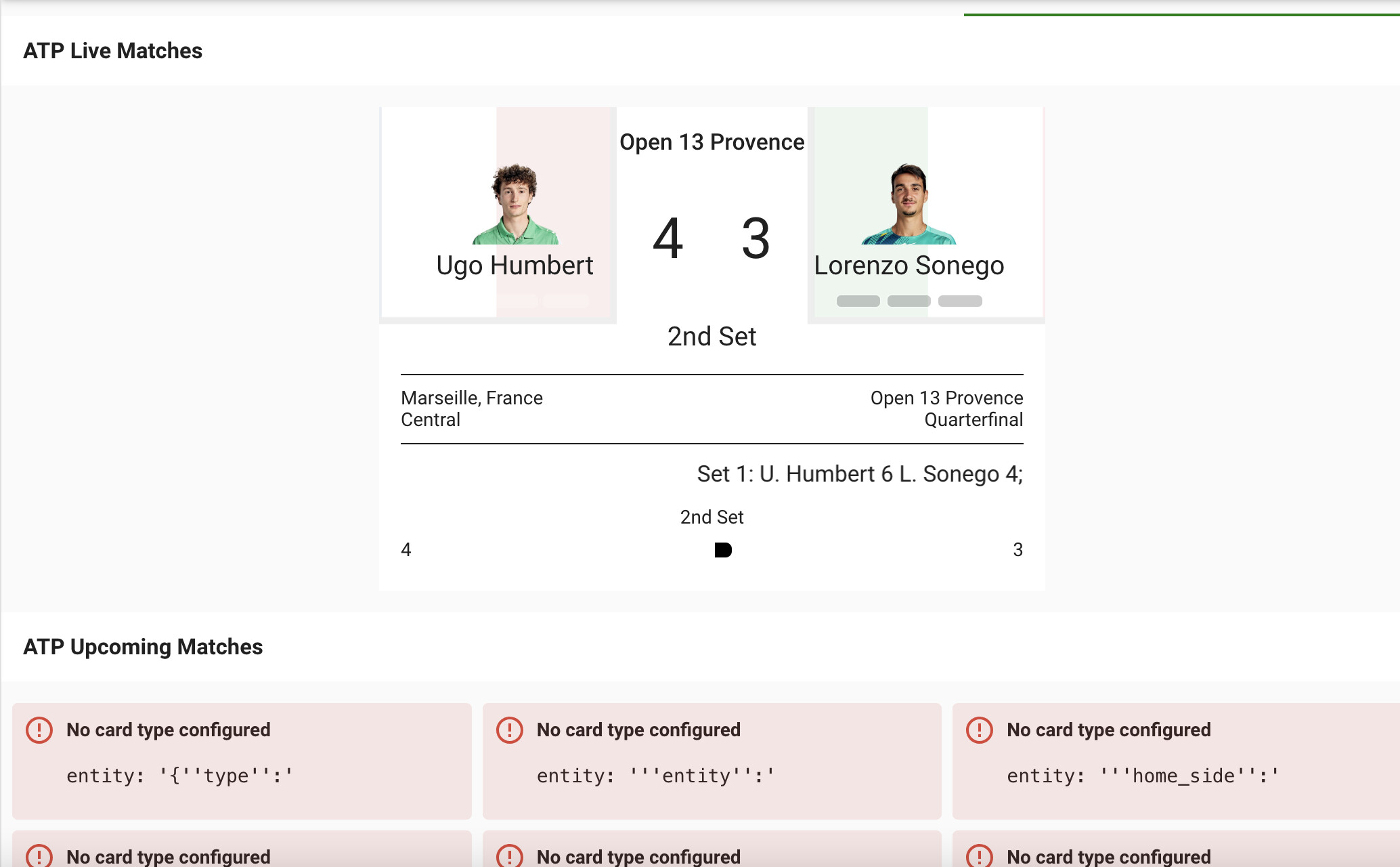

              Are there any other workarounds for getting duplicate cards?
Tennis isnāt populating a value for the āteam_homeawayā attribute so Iāve removed that filter from the game stats tab which is allowing duplicates to appear.
                bburwell
                (Bob B)
                    February 13, 2025,  9:39pm
              794
              Iām not showing duplicate cards on mine today, but I just put Amanda in as a quick test.
Do you have both tennis players names in there - teamtracker sensor?
If so you may need to create a check to see if the friendly_name has already been used.  Similar to something I did with NCAAF/NCAAM to filter out conference only game.
              Yes, it occurs when I have both players tracked in team tracker.
I looked at your filter and came up with something that will remove the duplicates (not as easy since the home/away isnāt an option for tennis) ā which does filter out the duplicates for IN games.
However, it creates a āno card type configuredā error for the PRE and POST games. Not certain I understand whatās causing it to only work on the IN games.
This is what Iām using the game_stats section:

                bburwell
                (Bob B)
                    February 15, 2025,  2:51pm
              796
              So Jinja2 drives me crazy when you are trying to use namespaces.  Thatās why filtering on home works well because you donāt have to create, but in this case there isnāt a home.
For my NCAAF/M conferences I created a separate sensor that included the team names and then sorted on that (you can see it on my github ncaaf.yaml and template.yaml files but I donāt think you really need that here.
Maybe this is an alternative, havenāt really checked it for other than a couple players.
I see that team_id has the player id that ESPN should keep constant.  For example Benjamin Bonzi is 2355 which equates to his page on ESPN - Benjamin Bonzi Stats, News, Pictures, Bio, Videos - ESPN
Since we know players competing against each other will be in each others card, maybe key off their idās and since we donāt care if they are on the right or left only list the lower value id.
Try this instead (btw I always sandbox changes in the decluttering which is why you will see it called duplicate_game_stats and then I change dashboard calls until I verify that it works.
  duplicate_game_stats:
    card:
      unique: true
      show_empty: false
      card:
        width: 200px
        max-columns: 5
      card_param: cards
      filter:
        template: |
            {%- set team_id = state_attr(team, "team_id") %}
            {%- set opponent_id = state_attr(team, "opponent_id") %}
            {%- if state_attr(team, "league") == "[[sport]]" and states(team) == "[[status]]" -%}
              {%- if team_id is not none and opponent_id is not none and team_id < opponent_id -%}
                  "entity": team,
                  "home_side": "right",
                  "outline": true,
                  "outline_color": "white"}}},
              {%- endif -%}
            {%- endif -%}
          {%- endfor -%}
      sort:
        method: attribute
        attribute: date
This is what I get:

  league_id: "ATP"
  team_id: "Holger Rune"
  league_id: "ATP"
  team_id: "Felix Auger-Aliassime"
  name: "Felix Auger-Aliassime"
  league_id: "ATP"
  team_id: "Frances Tiafoe"
  league_id: "ATP"
  team_id: "Karen Khachanov"
  name: "Karen Khachanov"
  league_id: "ATP"
  team_id: "Hubert Hurkacz"
  league_id: "ATP"
  team_id: "Pablo Carreno Busta"
  name: "Pablo Carreno Busta"
  league_id: "ATP"
  team_id: "Denis Shapovalov"
  name: "Denis Shapovalov"
  league_id: "ATP"
  team_id: "Nick Kyrgios"
  league_id: "ATP"
  team_id: "Roberto Bautista Agut"
  name: "Roberto Bautista Agut"
  league_id: "ATP"
  team_id: "Diego Schwartzman"
  name: "Diego Schwartzman"
  league_id: "ATP"
  team_id: "Lorenzo Musetti"
  league_id: "ATP"
  team_id: "Borna Coric"
  league_id: "ATP"
  team_id: "Sebastian Korda"
  league_id: "ATP"
  team_id: "Daniel Evans"
  league_id: "ATP"
  team_id: "John Isner"
  league_id: "ATP"
  team_id: "Miomir Kecmanovic"
  name: "Miomir Kecmanovic"
  league_id: "ATP"
  team_id: "Alejandro Davidovich Fokina"
  name: "Alejandro Davidovich Fokina"
  league_id: "ATP"
  team_id: "Jenson Brooksby"
  name: "Jenson Brooksby"
  league_id: "ATP"
  team_id: "Adrian Mannarino"
  name: "Adrian Mannarino"
  league_id: "ATP"
  team_id: "Albert Ramos-Vinolas"
  name: "Albert Ramos-Vinolas"
  league_id: "ATP"
  team_id: "Lorenzo Sonego"
  league_id: "ATP"
  team_id: "Filip Krajinovic"
  name: "Filip Krajinovic"
  league_id: "ATP"
  team_id: "Alexander Bublik"
  league_id: "ATP"
  team_id: "Marton Fucsovics"
  name: "Marton Fucsovics"
  league_id: "ATP"
  team_id: "Emil Ruusuvuori"
  name: "Emil Ruusuvuori"
  league_id: "ATP"
  team_id: "Brandon Nakashima"
  name: "Brandon Nakashima"
  league_id: "ATP"
  team_id: "Aslan Karatsev"
  name: "Aslan Karatsev"
  league_id: "ATP"
  team_id: "Pedro Martinez"
  name: "Pedro Martinez"
  league_id: "ATP"
  team_id: "Sebastian Baez"
  league_id: "ATP"
  league_id: "ATP"
  team_id: "Ugo Humbert"
  league_id: "ATP"
  team_id: "Francisco Cerundolo"
  name: "Francisco Cerundolo"
  league_id: "ATP"
  team_id: "Maxime Cressy"
WTA:
  league_id: "WTA"
  team_id: "Aryna Sabalenka"
  name: "Aryna Sabalenka"
  league_id: "WTA"
  team_id: "Iga Swiatek"
  league_id: "WTA"
  team_id: "Coco Gauff"
  league_id: "WTA"
  team_id: "Jasmine Paolini"
  league_id: "WTA"
  team_id: "Jessica Pegula"
  league_id: "WTA"
  team_id: "Madison Keys"
  league_id: "WTA"
  team_id: "Elena Rybakina"
  name: "Elena Rybakina"
  league_id: "WTA"
  team_id: "Qinwen Zheng"
  league_id: "WTA"
  team_id: "Emma Navarro"
  league_id: "WTA"
  team_id: "Paula Badosa"
  league_id: "WTA"
  team_id: "Danielle Collins"
  league_id: "WTA"
  team_id: "Daria Kasatkina"
  name: "Daria Kasatkina"
  league_id: "WTA"
  team_id: "Diana Shnaider"
  name: "Diana Shnaider"
  league_id: "WTA"
  team_id: "Anhelina Kalinina"
  name: "Anhelina Kalinina"
  league_id: "WTA"
  team_id: "Mirra Andreeva"
  name: "Mirra Andreeva"
  league_id: "WTA"
  team_id: "Magda Linette"
  league_id: "WTA"
  team_id: "Veronika Kudermetova"
  name: "Veronika Kudermetova"
  league_id: "WTA"
  team_id: "Liudmila Samsonova"
  name: "Liudmila Samsonova"
  league_id: "WTA"
  team_id: "Anna Kalinskaya"
  name: "Anna Kalinskaya"
  league_id: "WTA"
  team_id: "Jelena Ostapenko"
  name: "Jelena Ostapenko"
  league_id: "WTA"
  team_id: "Petra Kvitova"
  league_id: "WTA"
  team_id: "Ekaterina Alexandrova"
  name: "Ekaterina Alexandrova"
  league_id: "WTA"
  team_id: "Barbora Krejcikova"
  name: "Barbora Krejcikova"
  league_id: "WTA"
  team_id: "Karolina Pliskova"
  name: "Karolina Pliskova"
  league_id: "WTA"
  team_id: "Karolina Muchova"
  league_id: "WTA"
  team_id: "Zhang Shuai"
  league_id: "WTA"
  team_id: "Elise Mertens"
  league_id: "WTA"
  team_id: "Victoria Azarenka"
  name: "Victoria Azarenka"
  league_id: "WTA"
  team_id: "Sloane Stephens"
  name: "Sloane Stephens"
  league_id: "WTA"
  team_id: "Fiona Ferro"
  league_id: "WTA"
  team_id: "Kaia Kanepi"
  league_id: "WTA"
  team_id: "Jule Niemeier"
  name: "Jule Niemeier"
  league_id: "WTA"
  team_id: "Marie Bouzkova"
  name: "Marie Bouzkova"
  league_id: "WTA"
  team_id: "Clara Tauson"
  league_id: "WTA"
  team_id: "Claire Liu"
  league_id: "WTA"
  team_id: "Elina Svitolina"
  name: "Elina Svitolina"
  league_id: "WTA"
  team_id: "Marta Kostyuk"
  league_id: "WTA"
  team_id: "Anastasia Potapova"
  name: "Anastasia Potapova"
  league_id: "WTA"
  team_id: "Bianca Andreescu"
  name: "Bianca Andreescu"
  league_id: "WTA"
  team_id: "Leylah Fernandez"
  name: "Leylah Fernandez"
  league_id: "WTA"
  team_id: "Amanda Anisimova"
  name: "Amanda Anisimova"
  league_id: "WTA"
  team_id: "Camila Giorgi"
  league_id: "WTA"
  team_id: "Alize Cornet"
