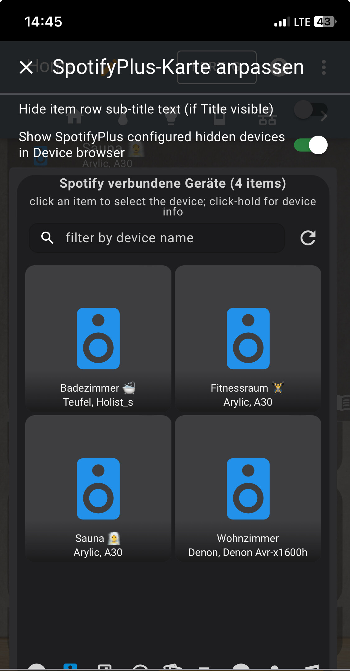

Hi Todd, would it be possible to add any background to the speaker selection for each individual device? Maybe there is interest? Best regards
Stefan
@Richi
The customImageUrls support will probably satisfy this request, though I did find a bug in the image processing for devices. I released a v1.0.43 update to fix that.
To start, find the images that you wish to display for a device and upload them to your HA <config>/www location. I would suggest creating a special directory under the HA <config>/www location for these custom images - e.g. <config>/www/spotifypluscard/customimages. The images in this location can then be easily referenced using the /local/spotifypluscard/customimages/filename.jpg (or .png) syntax in the configuration editor. PNG images with transparent backgrounds look the best in the UI, in my experience.

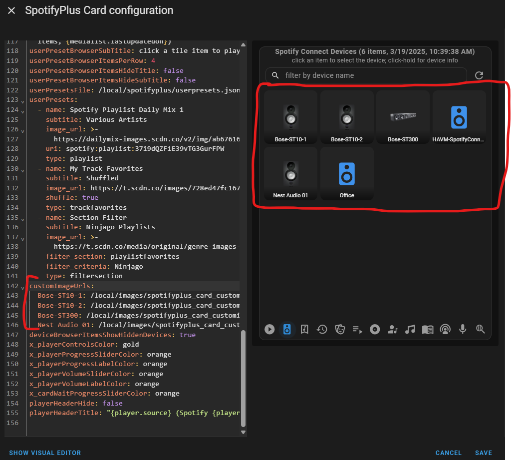

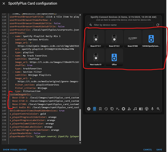

Next, you will need to update the custom image url’s table in the card configuration. Custom Image URL’s must be manually configured in the Configuration Editor using the “Show Code Editor” option (e.g. no UI editor). Once in the code editor, just add custom image url’s for your device names, like so:
customImageUrls:
  Bose-ST10-1: /local/spotifypluscard/customimages/device-speaker.png
  Bose-ST10-2: /local/spotifypluscard/customimages/device-speaker.png
  Bose-ST300: /local/spotifypluscard/customimages/device-soundbar.png
  Nest Audio 01: /local/spotifypluscard/customimages/device-speaker.png
And this is what it will look like. Note that I use a different location in my config folder to store my images (e.g. /local/images/spotifyplus_card_customimages/...)
Great, you’ve thought of everything! Many thanks for the great integration!

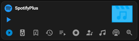

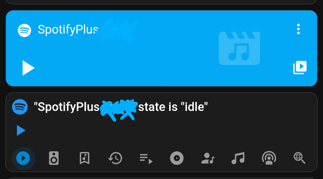

It’s working nicely. Thank you! If I was to nitpick it would be that the design now is a bit “dull”. But I don’t really have a good suggestion on how to improve it. :yum:
Design on top is the normal media player.

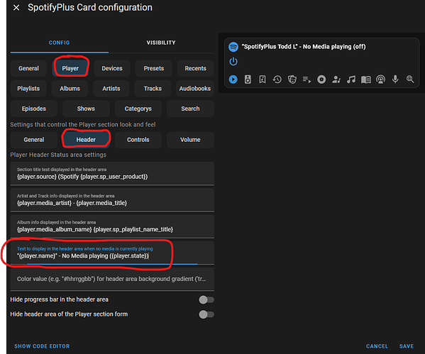

@Quacked
You can change the text that is displayed by setting the playerHeaderNoMediaPlayingText configuration option.
It also supports title formatting options, which allow you to display various integration attributes. For example, if you just wanted to display the player name like the HA Spotify player does, use the following:
playerHeaderNoMediaPlayingText: {player.name}
I will see if I can add some background color options, though it might be a few days before I get to it.
Personally I don’t think I need background color options. It matches my UI neatly already. By comparing to the default player I was thinking more of the transparent music icon to the right and the larger play button. They make the card look more symmetrical and elaborate. I’m no designer but adding some style like this could work? Obviously not that horrid box and that color, but maybe something indicating music? And maybe even making it clickable if there’s something logical missing a button. :grin:

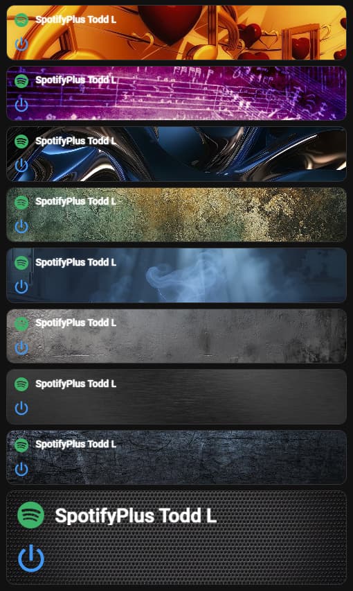

I am in the process of updating the card to add background capabilities for the off | idle state. This will allow you to tailor it more to your taste; you could also set a solid color image to simulate a background color as well.
Will keep you posted.
Some idle / off backgrounds I have been experimenting with …
All of the above backgrounds were downloaded from pixabay.com.

If you get time, do you mind sharing those idle/off backgrounds?
Thanks!
DM’ed you, but will post here as well …
All of the above idle / off backgrounds were downloaded from pixabay.com.
