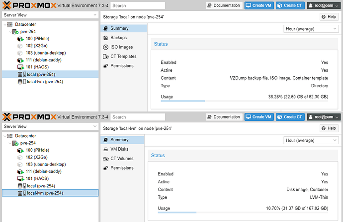

I suggest you install PVE using zfs not ext4 file system. Proxmox uses two volumes to install things. With zfs both volumes are installed in a single partition, while using ext4 on a 256G disk it is split as per the image below.
With zfs during PVE installation you can opt for a RAID-0 (striped giving a grand total storage of 512GB; no disk redundancy and not optimal as your disks are not similar) or RAID-1 (mirrored giving a grand total storage of 256GB; this provides redundancy; your 1st disk should be the NVMe).
