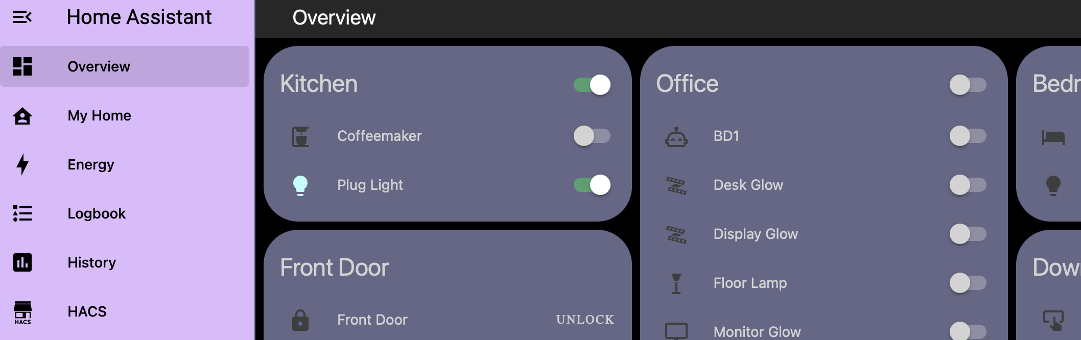

I have the theme set in Configuration & in my profile, but I just get color changes, no, actual LCARS-style UI updates.
Help?
Try a new dashboard and add card-mod tags.
                  - show_name: true
                    show_icon: true
                    type: button
                    tap_action:
                      action: toggle
                    entity: switch.plug_bathroom
                    icon: mdi:star-face
                    show_state: true
                    card_mod:
                      class: button-capped-right
Notice the last two lines there. :arrow_up:

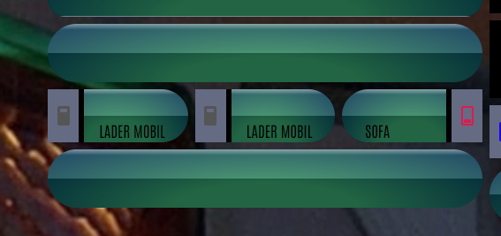

No, it’s not just sections. Old-style cards are impacted as well. I have a couple dashboards in different styles (because I’m too lazy to update a few of the simpler ones). All are LCARS skinned, and wound up looking like crap on update.
For the most part, it looks like it’s mainly the bars and headers that get wonky. Some of the effects (button highlighting for clickable entities) works on some buttons, and buttons are still active/clickable. It appears that bars and headers wind up showing their “areas” with backgrounds, making text hard to read, and throwing the look off.
To be clear, its likely some minor changes in the css to make it happy again. Functionality is still all there. Ideally the theme could hook into the new functionality, changing read-only buttons to have a different header color or such.
I will note that bullet, barrel, and capped buttons all look fine, and work as expected. They even highlight on mouse over if they control a button (using Modern theme colors, anyway).

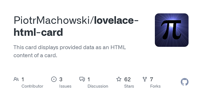

Just checking, are we talking about this custom:html-card?
Edit: Yes, it was. Works like a charm.
With a little further testing, I noted there was one panel that was OK under 2025.3.0. Turns out, if you update the headers to use custom:html-card, the background issues go away. So there is a work-around, and it’s one that several people are using already. Given that, my layout is back to “normal” under either version.
