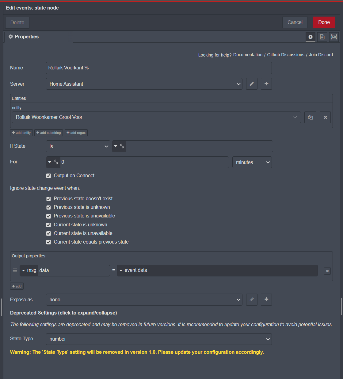

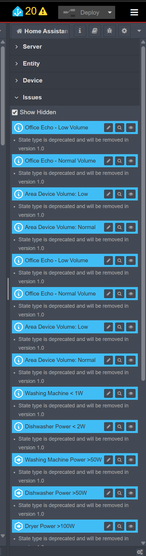

State type is deprecated and will be removed in version 1.0
What does this mean and how do I solve it? I have many of these errors:
Deprecated Settings (click to expand/collapse)
The following settings are deprecated and may be removed in future versions. It is recommended to update your configuration to avoid potential issues.
Warning: The ‘State Type’ setting will be removed in version 1.0. Please update your configuration accordingly.
In:
  • state nodes
  • current state nodes

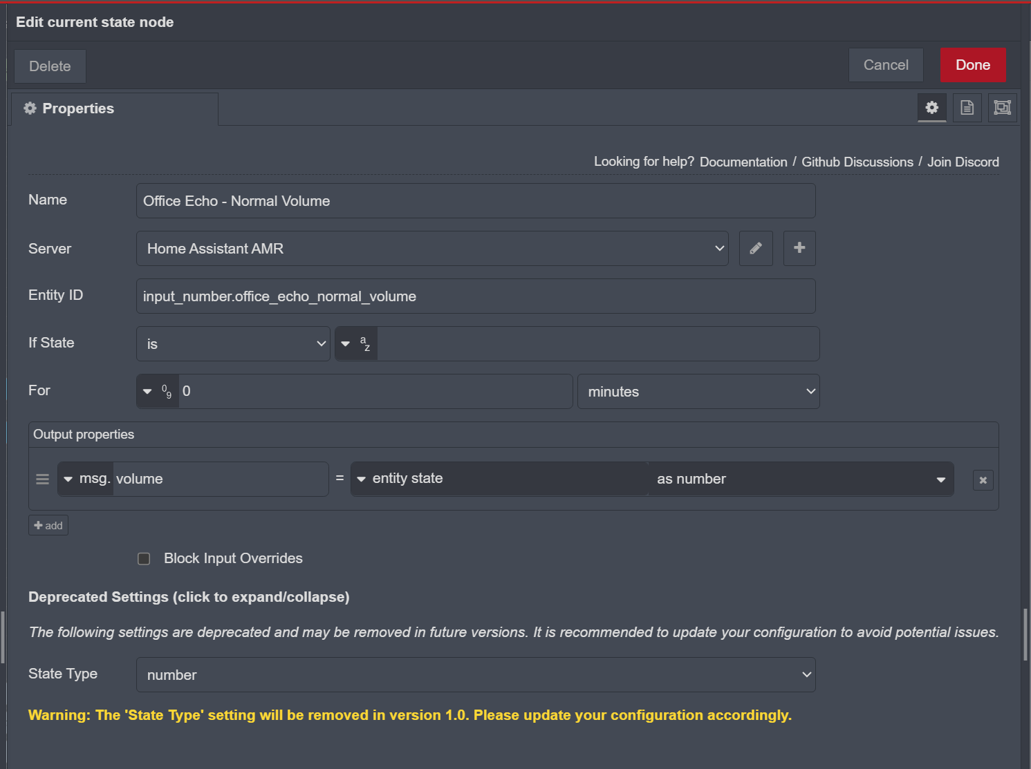

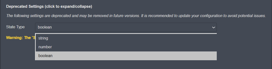

I can select something else, but not sure what to do:
It has essentially been moved. Right above that you’ll see a new dropdown next to state. If it was set to boolean, set it to boolean above.
Also, make sure you’re running at least version 0.79.4, as earlier versions contained a related bug.
I updated the node red websocket to 0.79.4 and fixed all of the 20 reported configuration nodes, however the warning persists. Deselecting “Show Hidden” makes no difference (as none are hidden, and I’d like to avoid that method to make this go away) and it actually re-selected itself anyway. Restarting NR also did not help. Am I missing something?
While I am guessing the warning is harmless, my OCD desire to resolve it kicks in :wink:
TL;DR:
  • Edit the node
  • Click on Deprecated Settings to expose the State Type field
  • Change this to “string” [changing from “number” or changing from “boolean”]
  • [Click on Deprecated Settings just to hide the field again as you no longer need to use this]
  • Save the node: Redeploy when done

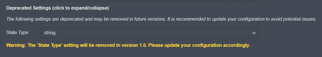

Change the State Type (in the Depreciated Settings) to “string” and the error will go away. In “string” mode, the node no longer attempts to cast the entity state value at start (which is where this change is going).
You are not using a conditional test, so nothing has to change there.
You are using the entity state as the output property, to msg.volume, so yes you have to use the new feature to cast the entity state to a number.
To be quite clear (if I have got this right from testing). The ‘error message’ is there because the node has the old (now deprecated and hidden) State Type still set to “number” or “boolean”. The update does not change this, just hides it.
You have to change the State Type to “string” to a) turn off the type conversion and b) make any changes to boolean conditional tests, JSONata use of $entity().state, and any Output Property that uses entity state to re-set the state value type casting at this point.
@Biscuit Yes, I confirm that setting the hidden type back to string makes the error go away. I changed the new casting feature to match what the hidden one said but based on the super helpful information you provided, I have a lot of work to validate all my flows (all of my automation is exclusively in NR so I have A LOT to review :grimacing:

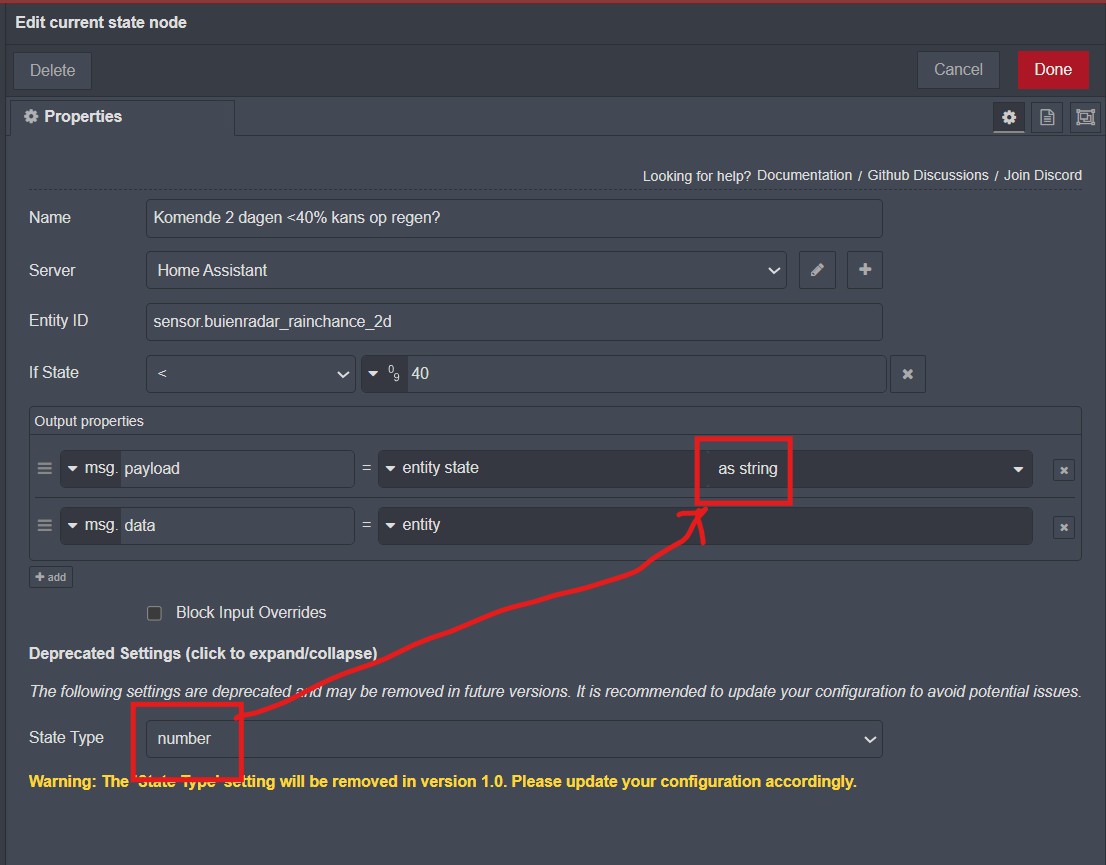

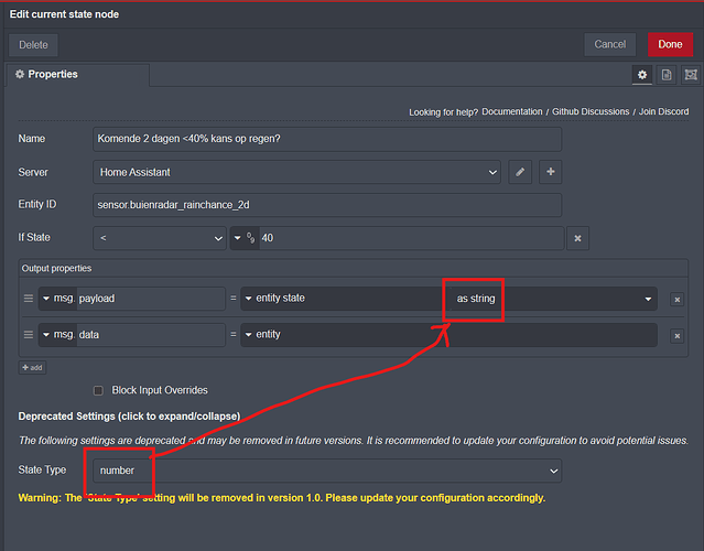

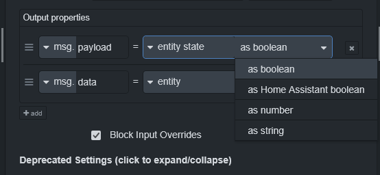

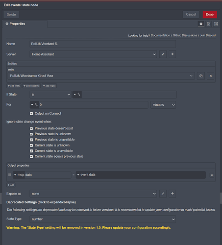

What to change here then:
And this one?
change “as string” to as number?
change number to string?
feels a bit un-intuitive
Yes.
For each ‘state’ node [where you currently have State Type as ‘number’]:
Change Deprecated Settings - State Type
  • from “number”
  • to “string”
This turns off the entity state-value casting when the node starts.
[so now the node - conditional tests etc - will always be working with the entity-state value as a string, and no longer as a number]
For the Current State node:
Change Output properties - for msg.payload = entity state
  • from “as string”
  • to “as number”
This [if you need it] turns back on the state-value casting at the generation of output properties. [so the output property msg.payload will continue to have a number rather than a string as it did before]
Your conditional test, as < 40 uses a number literal but will still work (with the entity state as a string) so no change is required there.

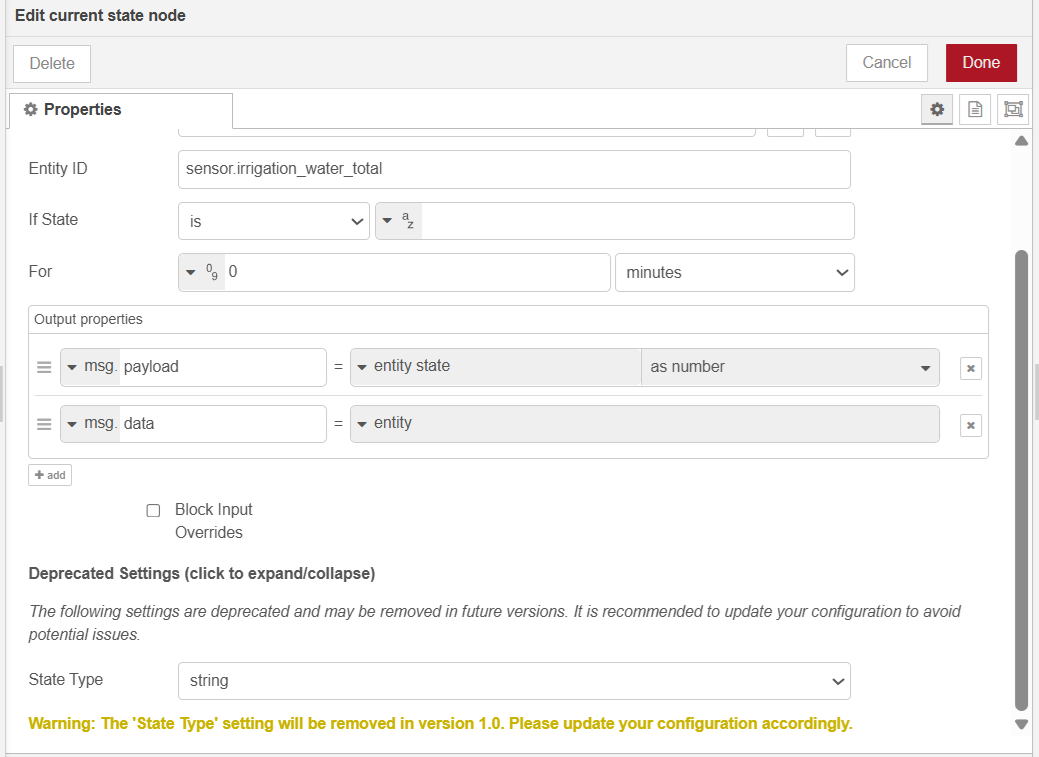

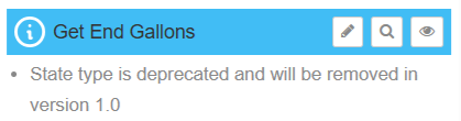

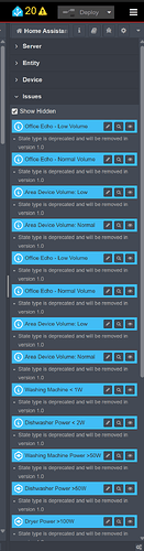

I continue to get numerous “Nodes with issues” like the one below. The sensor is originating from an ESPHome device and has a State value of 7.65299987792969:
state_class: total_increasing
unit_of_measurement: gal
device_class: water
icon: mdi:pulse
friendly_name: irrigation-meter-valves Irrigation Water Total
I understand that the actual state value is a string and I’m changing the output value to a number, but don’t understand why it still shows an error.
These are Kermit’s nodes, and I have only been tinkering with this on my development instance, but I have found the ‘nodes with issues’ can be sticky, and also not all nodes with issues are being shown.
You may find, as I have, that restarting Node-RED forces the ‘node-issue’ routine to clear and re-check, and this for me has cleared any ‘sticky messages’.
Indeed - a restart of Node Red does update (reduce) the number of errors shown after making the changes.

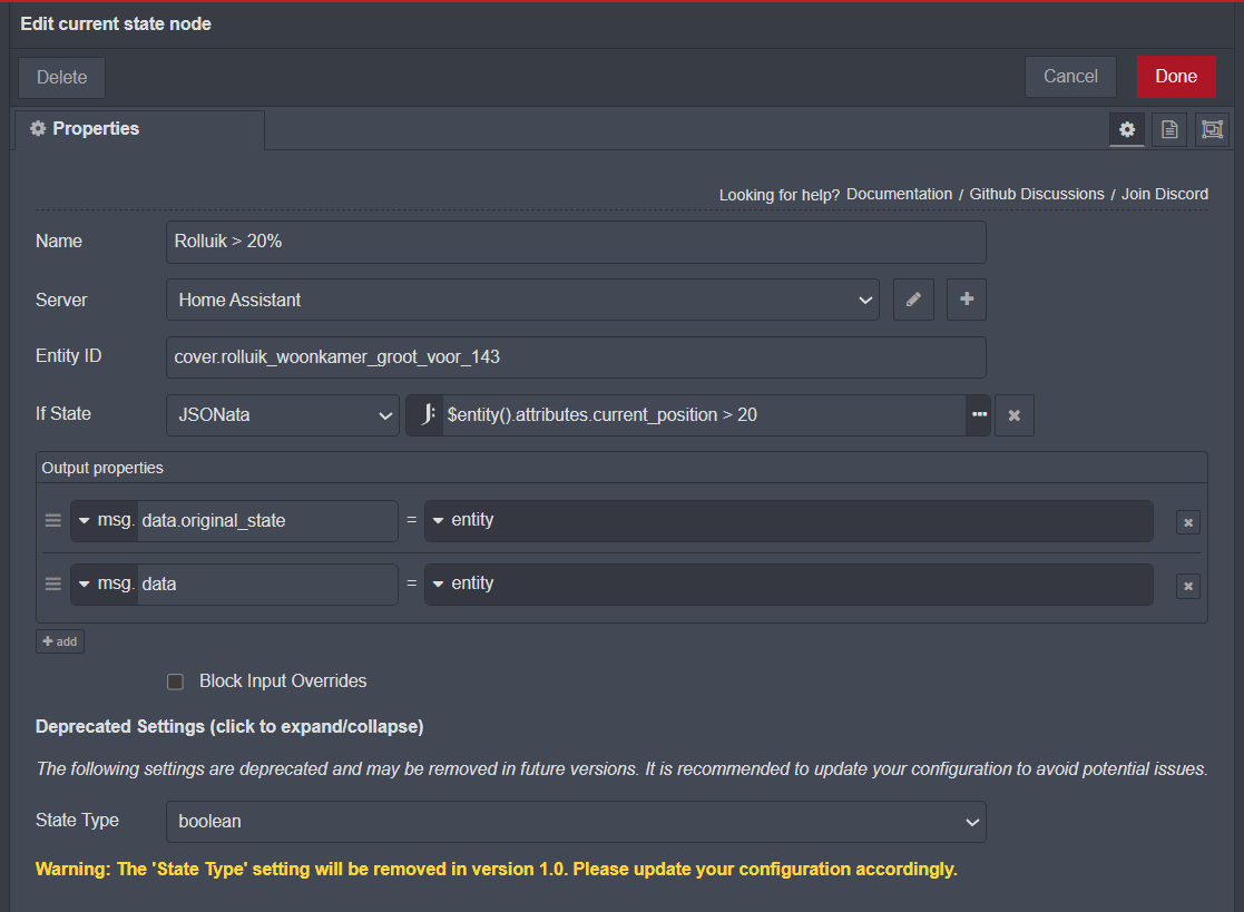

It’s odd that all of my nodes with the error defaulted to “State Type: Boolean”, forcing me to change all of them to ‘String’. I don’t think any of my nodes checked for or output boolean values, yet I had over 150 nodes flagged with errors that defaulted to boolean.

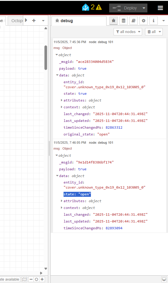

And what about this one?
It is currently like this:
Well yes, that one is a bit more tricky.
I will attempt to cover this (pun) in detail, so that you and others can work the rest out for yourselves.
You have a cover entity. These normally have an entity state that is a string as “open” or “closed”. This is nominally boolean, but clearly Home Assistant treats it as a string with two distinct values.
A Current State node
Original situation:
  • the State Type setting was set to “boolean” [and actually still is].
  • using the boolean string in the HA Server Configuration node, the node converted (cast) the entity-state value from string to boolean true if the original entity state was “open”, or to false if the original state was “closed”
  • this entity.state value (boolean) was available in the node
  • you are using JSONata in the ‘If State’ condition, but your expression $entity().attributes.current_position > 20 is reading the entity attributes, which is not the entity state.
  • you do have output properties with entity, that return the entire entity object, but you do not have an output property with entity state.

  • turn State Type to “string”
    • this turns off the entity state casting from string to boolean
    • this will remove the “error message”
    • note: at some point, the State Type UI entry will go entirely, but you will no longer have to worry about this setting ever again

  • will this effect any output property for the node?
    • no it will not, since you do not have any output property set to entity state | string
    • if you did, you would change this to show entity state | Home Assistant boolean so that the output property continued to be cast (converted) from a string (“open”/“close”) to a boolean (true/false) value, using the Home Assistant boolean rules

The only other problem that you may experience, is from the use of the msg.data.original_state and the msg.data output properties, which are both set to use the entity object.
The node entity object contains everything about the entity, including the entity state. The side-effect of the state-casting is that the entity state value was changed in this object at the start of the node.
This means that, before changing the State Type, msg.data.state will be boolean
This means that after changing the State type, msg.data.state will be a string.
If you are using msg.data in the subsequent flow, you will now have “open”/“closed” and not true/false
You will need to consider any use of the full entity object later in your flow. In the new situation, entity state casting does not apply to the entire entity object, and can only be applied to the state value itself.
If you used the entity state, with the Home Assistant boolean option, then you would have the state value cast to boolean.
Picture:
Top (before) - State Type set to boolean. The msg.payload (entity.state) is true, the msg.data (entity) object has state true, and there is an original_state object as “open” [which was the original entity state the node saw before casting the state to boolean]
Bottom (after changes) - State Type set to string, msg.payload set to entity.state | Home Assistant boolean, the msg.data (entity) object now has state “open”, since no state casting is taking place. msg.payload continues to have the value cast to boolean, using the Home Assisant ‘rules’
