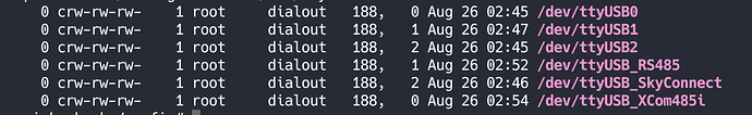

The symlinks created after reboot are always correct (but do change from time to time):
0 crw-rw-rw- 1 root dialout 188, 0 Aug 25 20:39 /dev/ttyUSB0
0 crw-rw-rw- 1 root dialout 188, 1 Aug 25 20:39 /dev/ttyUSB1
0 crw-rw-rw- 1 root dialout 188, 2 Aug 25 13:53 /dev/ttyUSB2
0 lrwxrwxrwx 1 root root 7 Aug 25 13:53 /dev/ttyUSB_RS485 -> ttyUSB1
0 lrwxrwxrwx 1 root root 7 Aug 25 13:53 /dev/ttyUSB_SkyConnect -> ttyUSB2
0 lrwxrwxrwx 1 root root 7 Aug 25 13:53 /dev/ttyUSB_XCom485i -> ttyUSB0

However, if I reboot and the configuration ends up being e.g.:
/dev/ttyUSB_RS485 -> ttyUSB0
/dev/ttyUSB_SkyConnect -> ttyUSB1
/dev/ttyUSB_XCom485i -> ttyUSB2
then on the host system everything still works fine, i.e. if I access /dev/ttyUSB_XCom485i it is the correct XCom485i device that I expect, likewise if I access /dev/ttyUSB_RS485 it is the RS485 device that I expect.
However, within the HA docker container unfortunately, the ports seemed to be stuck with the configuration that was active during the last docker compose up -d, i.e. if I want to access the XCom485i in the container, it is still mapped to /dev/ttyUSB0 on the host system (which was the symlink for XCom485i during the last docker compose up -d) but that obviously does not work anymore since the symlink now points to /dev/ttyUSB2.
