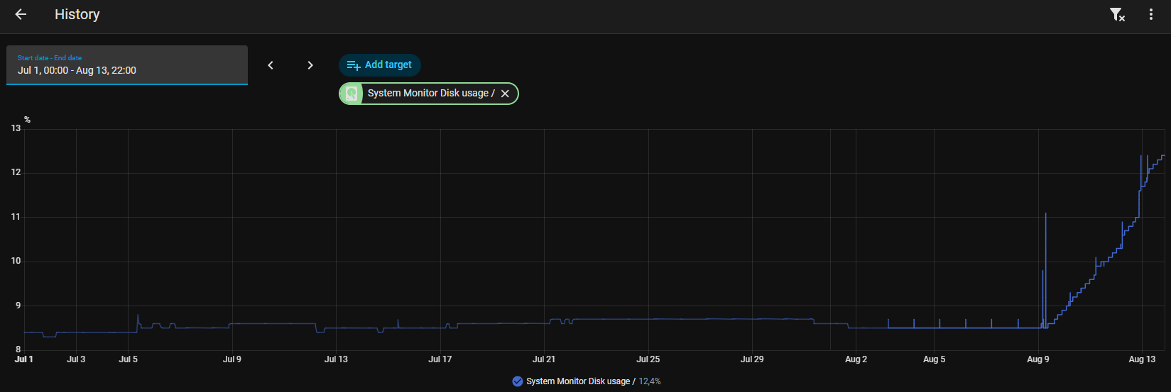

I installed 2026.8.1 (on top of the last 2026.7) last weekend and noticed a continuous increase in storage usage. Does anybody else have that? Is something not being cleaned up properly?
It was fairly constant before. I’m on HAOS 18.2
8,5 to 12,5% of what amount of storage?
the concern is not the higher usage but the trend since

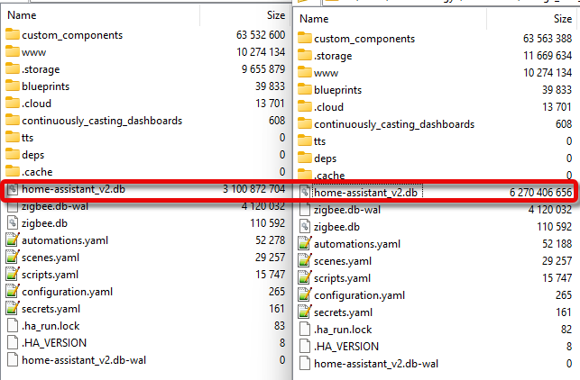

the trend is unchanged; disk usage doubled within a week. As this is also true for the backups, I didn’t bother to install Advanced SSH from above, just comparing two backups:
Right Something is filling Your DB, Could be " A Loop, In a template" or A Bogus Device/Integration

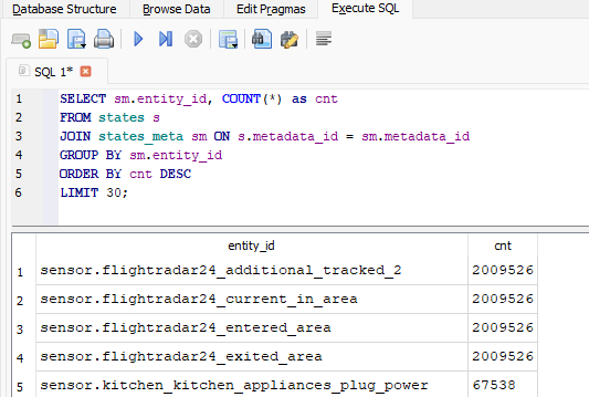

your last point sounds like the most likely. A brief look into the DB points to a custom integration:
do you think it would make sense to exclude these from the recorder (and purge)? oc I’ll follow up with a ticket…
