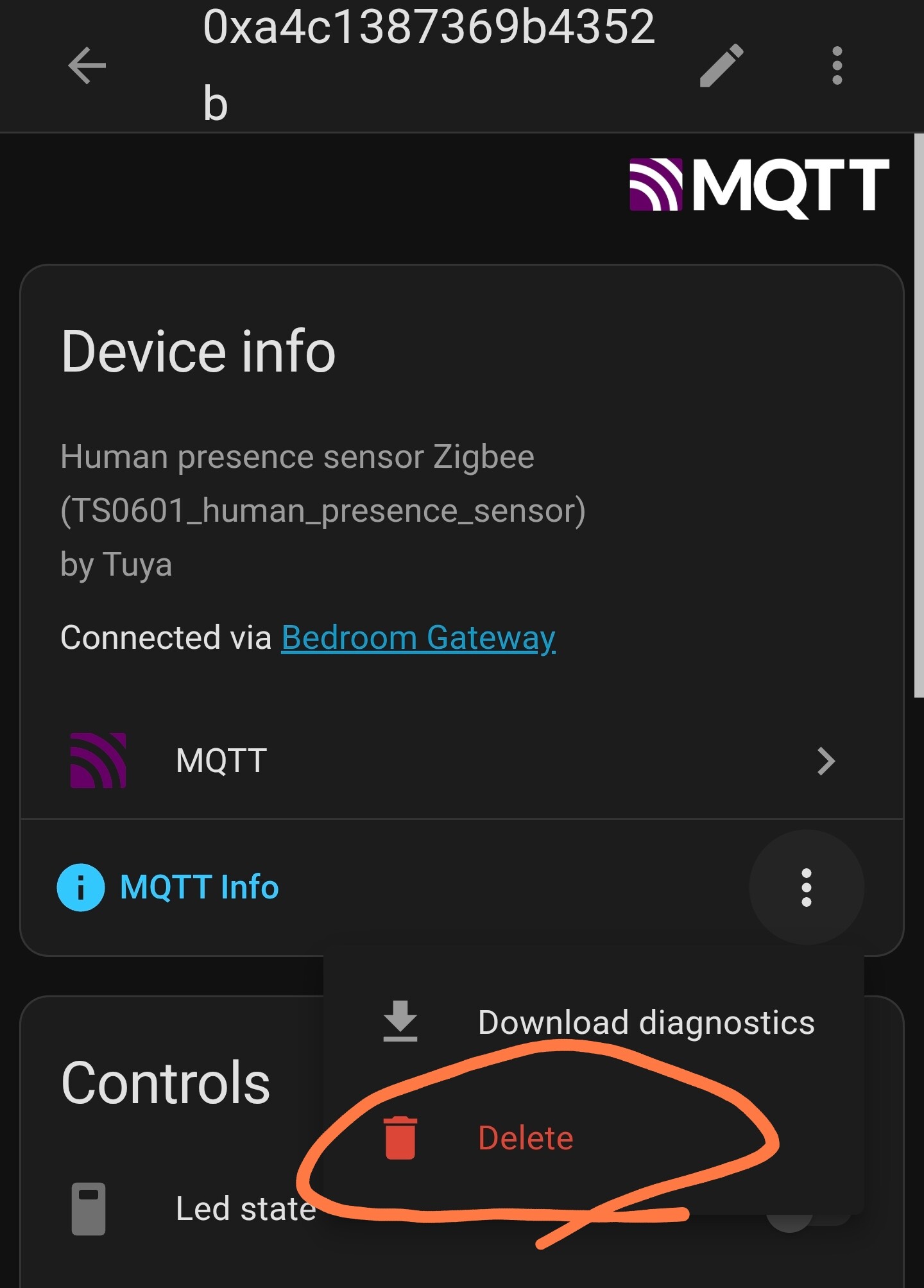

You can delete mqtt entities via device definition from home assistant UI, no?
