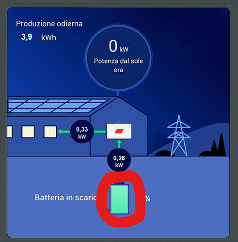

Hi everyone, I’m trying to create a very cute way to display my solar panels info, with the same layout used in my solar panels’ application UI. The only thing I miss is changing a rectangle’s height depending on the battery’s level. I wonder if somebody knows how to help me.
In the screenshot the rectangle is the one circled in red and here’s my code.
