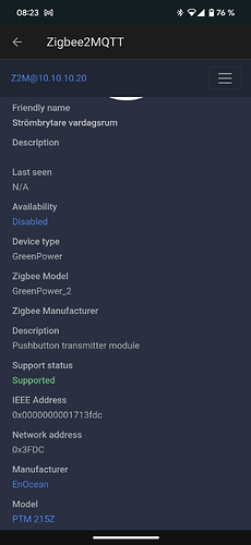

I bought this Sunricher switch with four buttons and paired it with my Sonoff Zigbee adapter.
I use Zigbee2mqtt and IKEA lights, and it’s working!
My goal with this switch was to turn on/off lights as well as dim the lightning. I couldn’t find anyone who solved it already ( or maybe my googling skills is kind of bad )
The thing is with this switch is, that it only sends events, which for me is:
press_1, release_1, press_2 release_2, press_3, release_3, press_4 release_4
But I wanted to know if the button was either short or long pressed.
So I have now created a new component which solves this, I call it dimmer_button for now.
So what it does is, when the event press_1 is pressed, it spawns a new thread and waits for x time before it checks again. If the release_1 was trigged, then we had a shortpress, otherwise the loop sends longpresses which then increase or decrease the lightning in the room.
I just wanted to share this component if someone else is interested in the same functionality.
