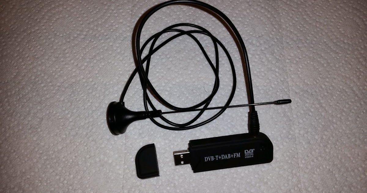

Would like to see support for Acurite sensors. These work on 433mhz radio frequencies.
A receiver could be attached to a Raspberry Pi to receive the data. Don’t know if this is already possible with other components or not.
Something like this one
