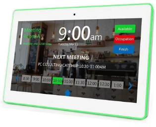

Support for LEDs on meeting room tablets?
I came across this tablet: https://www.aliexpress.us/item/3256806258548412.html
2024-12-03 18_18_12-8 Inch Meeting Booking Tablet With 4 LED Light Bars Support POE Power NFC Contac
It’s an Android unit. What makes it interesting are the LEDs around the bezel. It seems like it’d be clever to make use of those for notifications from HA.
Anyone seen/tried/using one of those?
bump. anyone?
The listing mentions you can control the light via an API, though the sole review mentions the light is controlled via an app.
Might be a good idea to get in touch with the seller to clarify how it’s controlled exactly. If it really is via an API and they can provide documentation for it, then it should be possible to use it for HA notifications.
They send you a zip file with instructions to build your own android app to control the led strip. I’m interested in these display as well (this is the one I’m targeting at the moment), but I was wondering the same: has anyone already built an app that expose a simple rest api for these devices? If needed I can forward the zip file in private.
