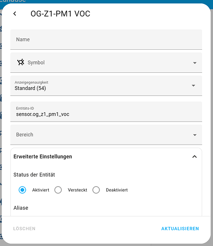

What is the best way to get this data into Home Assistant and have it represented correctly in the dashboard? When assigning the generic 2byte_float data type, then the value has no unit and is mis-represented in the dashboard:
Rather than having this weird graph for data that can easily be plotted over time, I would like to have this view (e.g. for the CO2 reading, which is 9.008 i.e. ppm):
Is is possible to have such a datatype, even though there is no dedicated DPT for it?
Or do I have to work around this with some template sensor?
I think you’d just need to add state_class: measurement and the device_class to your knx sensor entity definition to have the Ui show that graph.
Unit of measurement can be overridden in UI.
