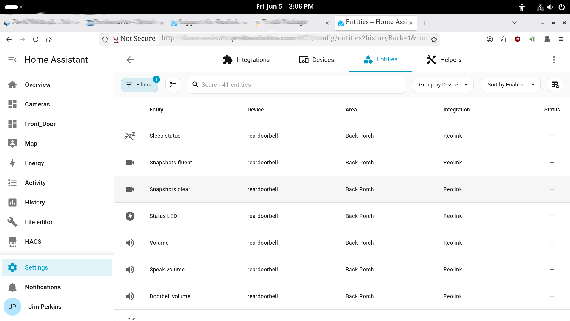

I would be happy to have this for the moment. But I did not find those hidden settings "snapshots fluent" and "snapshots clear" you mentioned. This refers to hidden HA entities, right? There's nothing like this for me, only lots of other entities such as floodlight, AI settings, image saturation etc.

Where did you enable them? Would you have a screenshot for me? Thanks!
settings, devices and services, reolink,3 dots to right of doorbell, 41 entities, snapshots fluent(or clear),click gear, enable.
then the snapshot could be viewed from the overview card when you select the area that the camera was assigned to. note it takes about 10 seconds for the snapshot to appear.
then I added another card to the dashboard and selected by card type, picture glance, and selected the appropriate camera entry.
remember this is a work in progress and I am a novice grade HA user
Okay... Thanks. This does not exist for an Argus 3 Ultra battery-powered camera.
