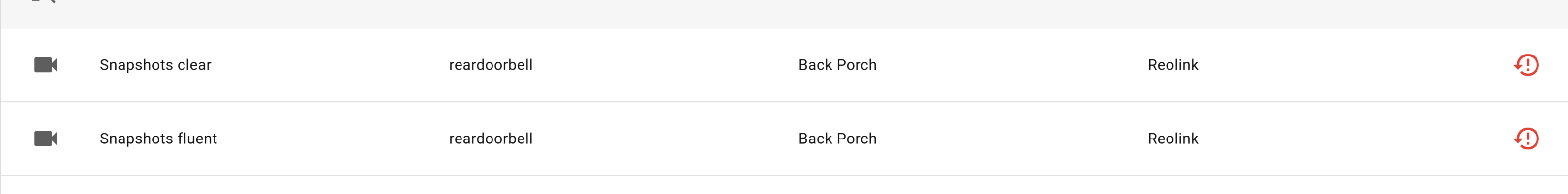

After the HA update to 2026.6.2 I am no longer getting the snapshots with the Reolink Video Doorbell battery. They were working previously.
I have reloaded the reolink integration and restarted HA to troubleshoot, the camera in question is reardoorbell.

the Snapshots are back working with the Reolink Video Doorbell battery with HA 2026.6.3

You are right, they were not showing on some battery models.
In the latest HA version I have fixed that.
Could you check if you now do have the snapshot entities (disabled by default)?
