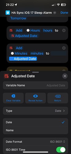

Could you check the formatting of the datetime within the dictionary?
Tap the Adjusted date right above the HA service call.
Check if the date and time is set to ISO8601. If this part isn’t formatted right, this could give your error.

I’ve got this setup but it doesn’t seem to be updating the helper in HA this is what I get when I print the dictionary result
Is this the normal result?
No it’s not. It ought to be just a single datetime, not four, like yours…
I’m unsure why you got 4 different date times, instead of one. You could add ‘show result’ at the different stages to see where it goes wrong.
Yeah it looks like it starts at adding alarm hours to adjusted time
I figured it out. I had to reset the hours and minutes to edit sleep time. It must have gotten unsynced or something.

So what worked for me was removing the variable “:clock1: Hours” (that comes from the alarm) from the “Add :clock1: Hours hours to Adjusted time” block. Then I added back in the “:clock1: Hours” variable and then repeated the same thing with the “:clock1: Minutes” variable and that seemed to fix my problem of multiple times appearing. Let me know if that makes sense or not and I can try to explain it in more detail or take some more screenshots.
Removing hours and minutes like @Stevebutler18 mentioned didn’t work for me, but removing the “Adjusted Date” variable and re-adding it worked. You may try that if removing and re-adding the “:clock1: Hours” and “:clock1: Minutes” doesn’t work for you.
I’m wondering if it’s a locale issue with the shared shortcut (I’m in the US). I was able to share the edited shortcut to my wife’s phone with no issues once I dropped and re-added the variable.
For some reason I’m still seeing the issue. I even tried recreating the shortcut from scratch. As soon as I put the add hours and add minutes actions in there, it starts duplicating the number of entries in the end result. I always end up with a list of like four date/times by the end.
