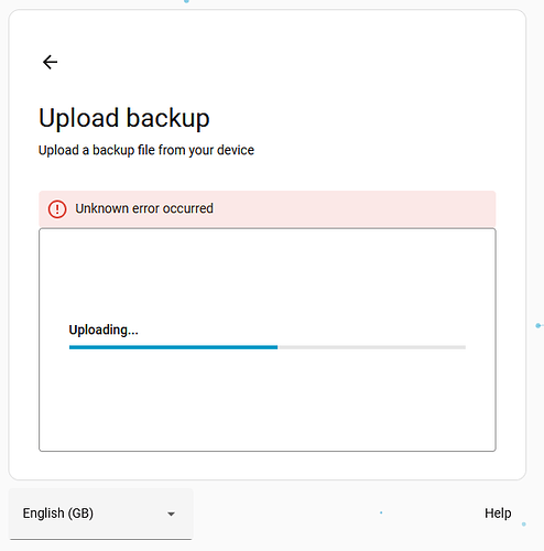

I am downloading the latest version in DSM under Container-Image. Hereafter I create the Container using the new Image and using my backup, but I get and error every time, that there is an Unknown error occurred. I have tried with the latest image and version 2025.9.0.

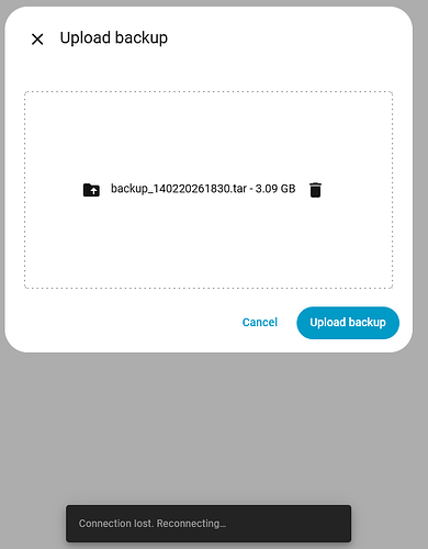

I have also tried to create a new Container and hereafter try to upload my backup I will lose the connection during the process “Connection lost. Reconnecting…”.

I made a backup with the History and it made me a backup with the size 3,09 GB and that was too large for my system.
When making a backup without History the size then was 0,49 GB and when using this backup, I was able to create a container from the backup.
Hereafter I open the system/backup and saw the full backup in the Synology DSM area. I did now make a backup from that and now it seems that I also have the history.
