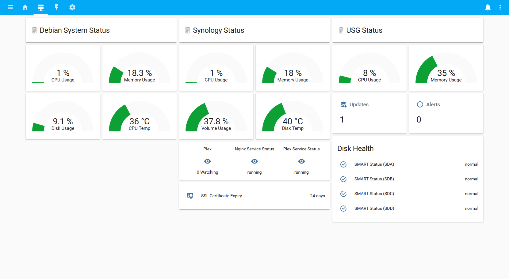

Mine’s very simple by comparison to most of the dashboards shown here, but this is mine:
The only custom UI element in use here is the Compact Custom Header.
And in case anyone’s interested in how this is layed out and configured:

Simple is good. You can see what you need to at a glance.
How did you get the usg cpu , memory data and update data? Can you share? Thanks
Always happy to share! :slight_smile:
I used the custom Unifi Gateway component and added the templates for the USG hardware stats as per gohassgo’s helpful post here.
