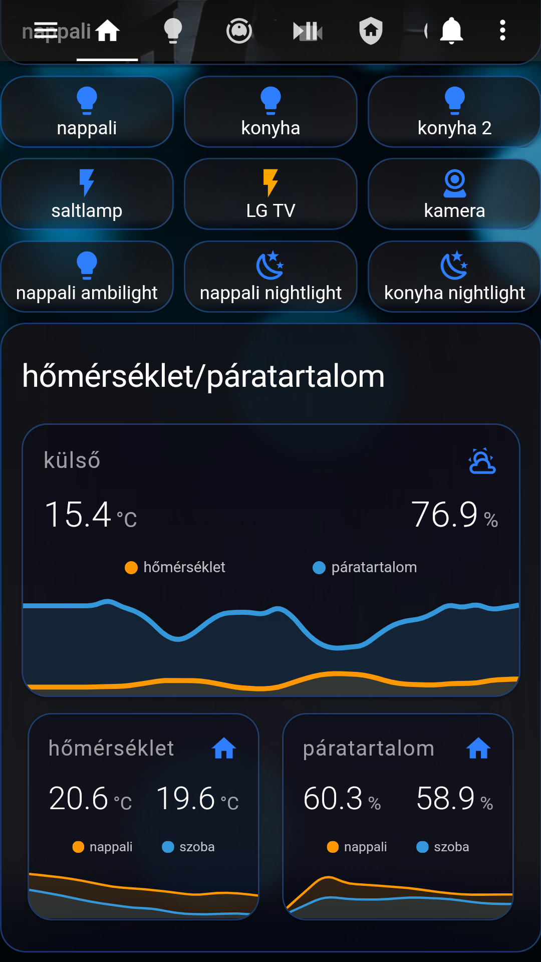

Inner and outer temperature-humidity monitoring.
Would you mind sharing the config for temperature-humidity monitoring? Not sure how you got both data (Celcius and %) shown in there.
Of course
card:
color: white
entities:
- cards:
- cards:
- card:
animate: true
entities:
- entity: sensor.temperature_mi
- entity: sensor.humidity_mi
show_state: true
font_size: 80
hour24: true
hours_to_show: 72
icon: 'mdi:weather-partlycloudy'
legend: true
show:
graph: line
type: 'custom:mini-graph-card'
style:
background-color: 'rgba(0,0,20,0.3)'
background-repeat: no-repeat
background-size: 100% 100%
border: 'solid 1px rgba(57,128,228,0.4)'
border-radius: 20px
transform: scale(0.95)
type: 'custom:card-modder'
type: horizontal-stack
type: 'custom:vertical-stack-in-card'
- cards:
- cards:
- card:
animate: true
entities:
- entity: sensor.temperature_temperature
show_state: true
- entity: sensor.broadlink_sensor_temperature
show_state: true
font_size: 75
icon: 'mdi:home'
style:
border-radius: 20px
- card:
animate: true
entities:
- entity: sensor.temperature_humidity
show_state: true
- entity: sensor.broadlink_sensor_humidity
show_state: true
font_size: 75
icon: 'mdi:home'
style:
border-radius: 20px
show_header_toggle: false
type: entities
style:
background-color: 'rgba(0,0,20,0.6)'
background-image: url("/local/pictures/cardback.png")
border-radius: 20px

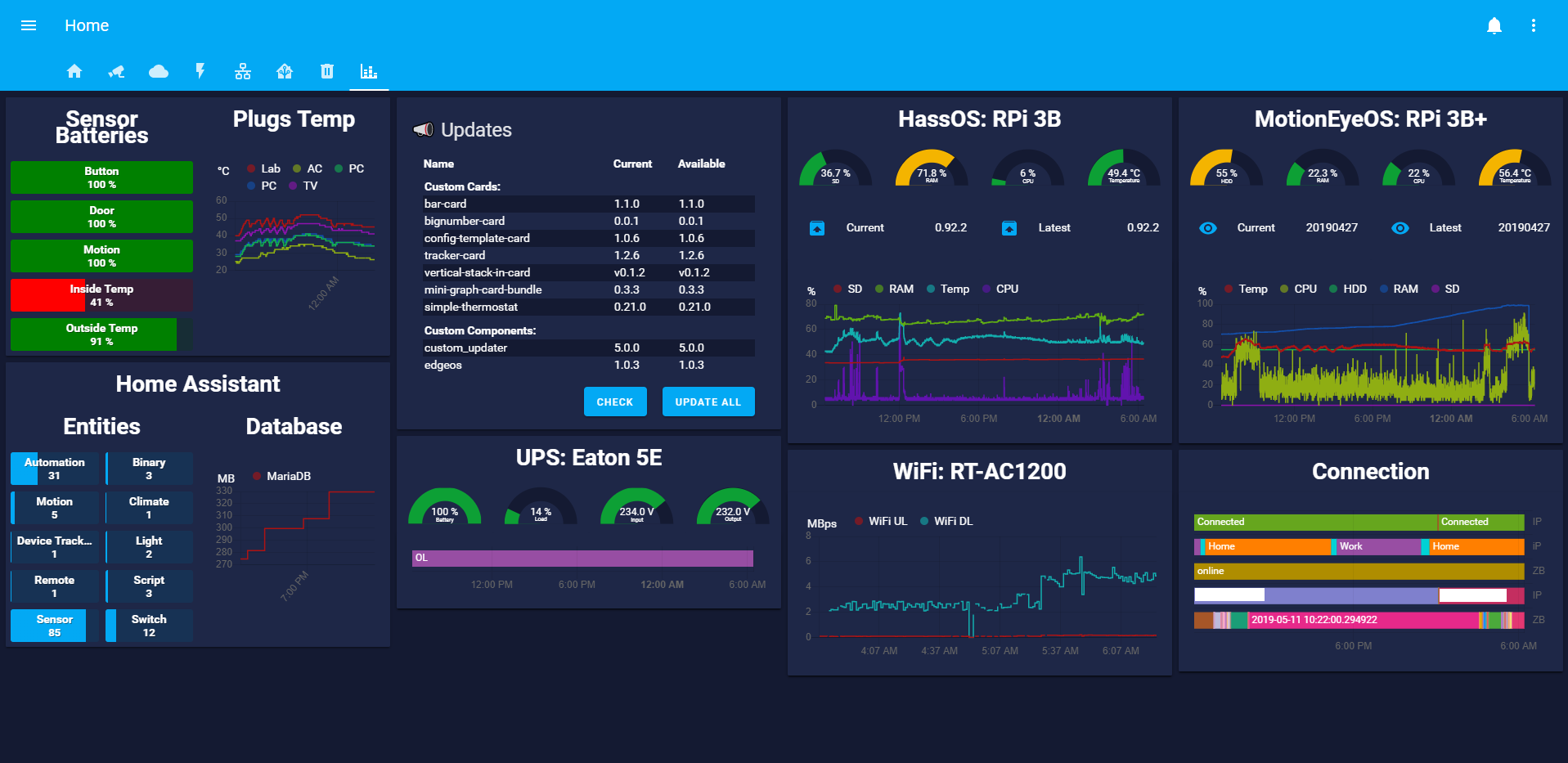

I think mine is exactly the same as @krovachek
## Database size
- platform: sql
db_url: !secret mariadb_url
queries:
- name: Database Size
query: 'SELECT table_schema "database", Round(Sum(data_length + index_length) / 1048576, 2) "value" FROM information_schema.tables WHERE table_schema="homeassistant" GROUP BY table_schema'
column: 'value'
unit_of_measurement: MB
We must have stolen it from the same post
Thank you guys I got it working!
it’s a wifi sensor
- platform: command_line
command: 'iwconfig wlan0 |grep Signal|cut -d"=" -f3|cut -d" " -f1'
unit_of_measurement: " dBm"
value_template: '{{ value | round(1) }}'
I can’t work out how you got the border around the outside of your card (see, Card modder and vertical-stack-in-card )
In fact I can’t work out how you got your card to show at all. It looks like you have your vertical/horizontal stack in cards listed in an entities card but when I try that nothing shows up. Which is what I would expect. An entities card only supports lists of entities not cards.
Hey bro, how did you get the stats from your Eaton UPS?? I have a 5PX !
Used NUT addon from this repo: https://github.com/RoosterX/hassio-addons
with NUT sensor: https://www.home-assistant.io/components/nut/
how did u get the latest hass.io version sensor?
## HA version
- platform: version
## HA available version
- platform: version
name: Latest Available Version
beta: false
source: hassio
Can you provide the code for the github part. Thank you.

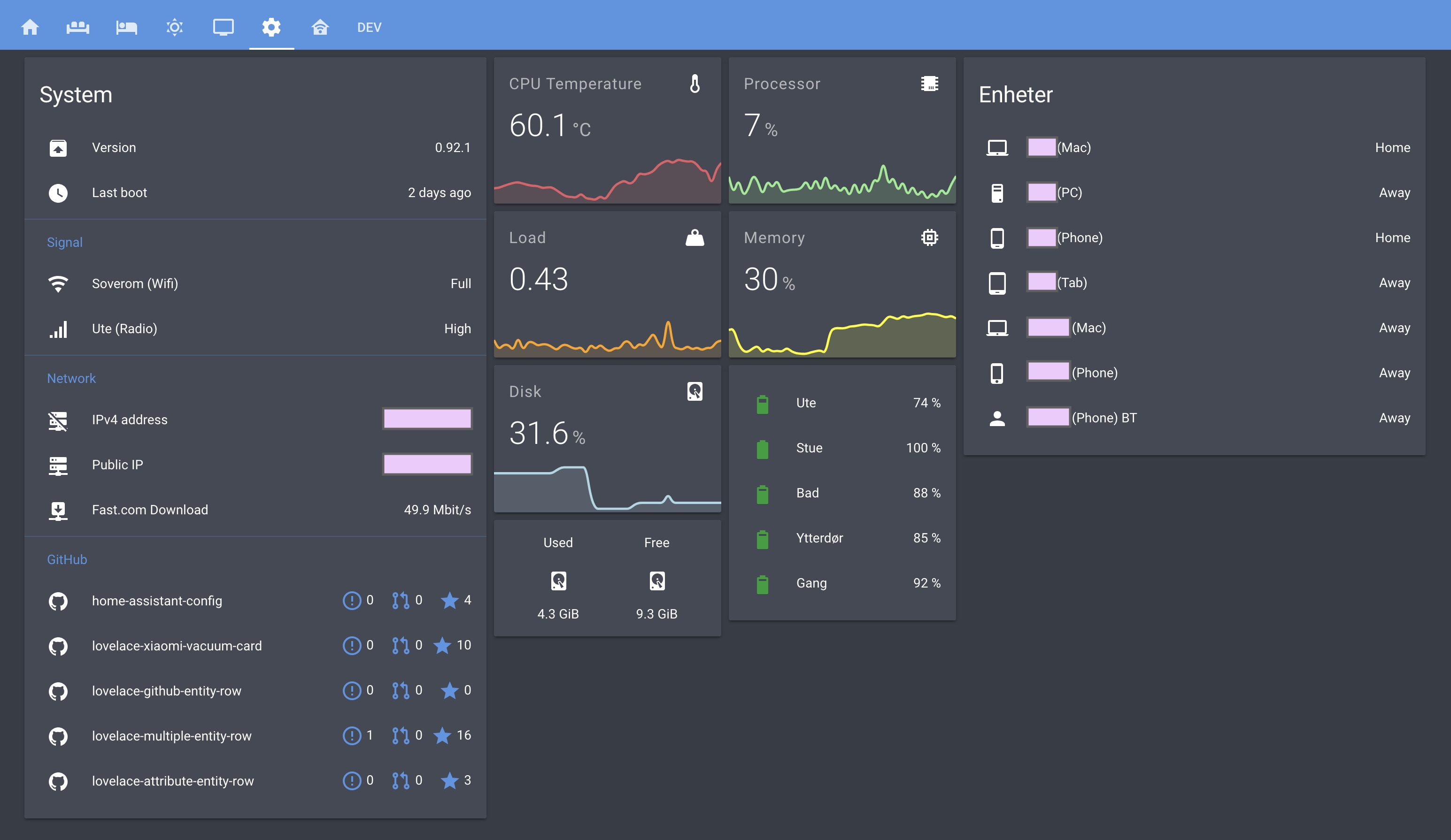

Got alot of inspiration from this thread! Thanks! working on sliming it down to fit the screen better
I made an entity-row version of ljmerza’s github-card, so you can use either depending on how you want to display them.
Thank you. Looks great.
