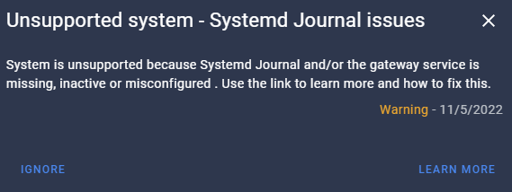

I got below warning 6 months ago and I believe I fixed it, maybe I also clicked ignore on the message but I do not think so.
Now it popped up again but with the original date.
`Unsupported system - Systemd Journal issues
System is unsupported because Systemd Journal and/or the gateway service is missing, inactive or misconfigured . Use the link to learn more and how to fix this.
Warning - 11/5/2022`
Is this message still valid i.e. I still have the problem? Or is the message just stuck and I need to ignore it.
