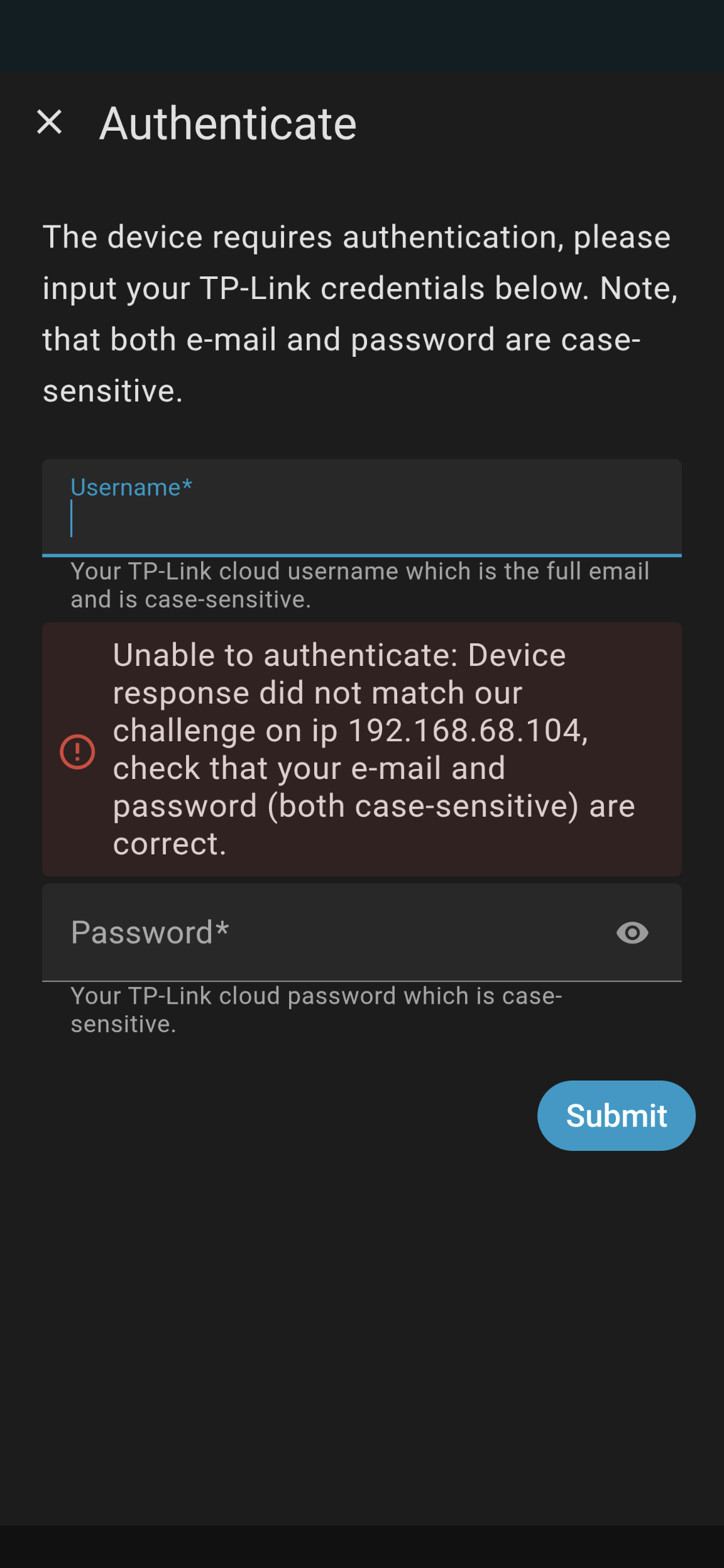

I have the same problem. The issue seems to be that the authentication requested by the TP-Link integration is actually not for the TP-Link cloud, but for a local account on the device.
That’s the way that the Tapo cameras work and the solution in that case is to enable an account on the device, through its advanced settings on the Tapo app I learned this from discussions on this forum, and it works.
But, the P105 has no such setting via the Tapo app. Nevertheless the error from the integration suggests that it is trying to authenticate on the device. See the screenshot attached.
I can’t find a way around this, at least using the “official” TP-Link integration.

I have 3 P105’s and they are all working now using the TP-Link Smart Home integration. The issue I was having was related to the username. In the Tapo app under account my email address had a capital letter in it. Once I used it exactly as shown it worked. Apparently, it is case sensitive. Beyond that I don’t know. I just added a KP115 I forgot about and it added right in without auth I assume because it is kasa.

What strikes me is that the error message reports that authentication has failed on the IP address of the device. Also this failure is immediate - consistent with something happening locally.
