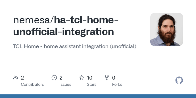

Greatest news ever!!
Works for AC’s
Enjoy
perfect!, thanks it’s a great solution.
