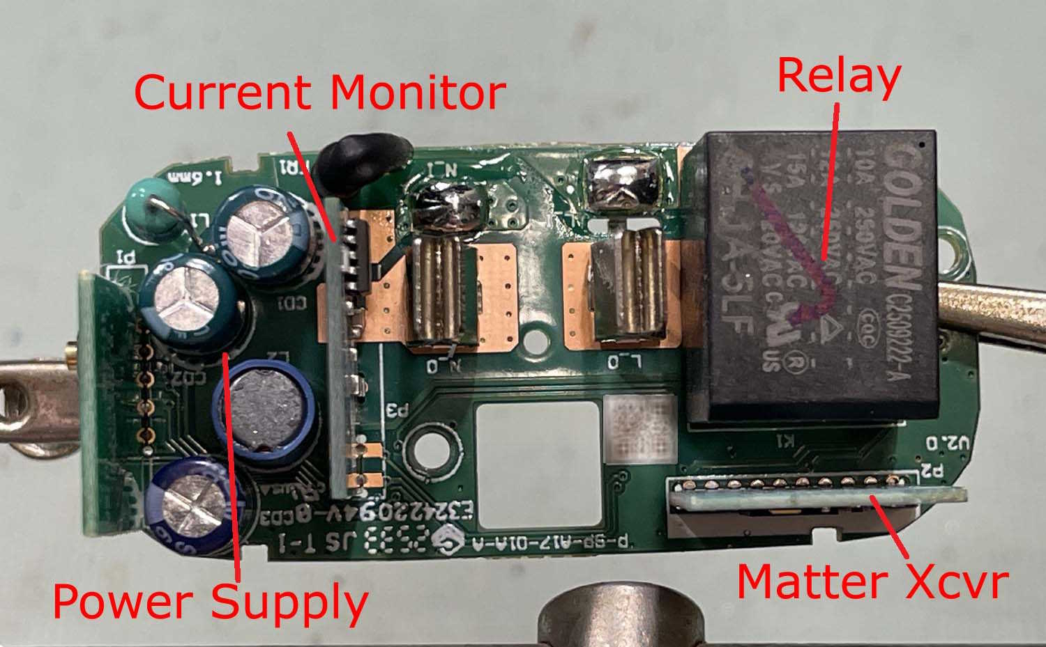

Teardown of a new Ikea Grillplats plug (potential always-on current monitor)
I’d recently made a post regarding the Ikea Inspelning plug in a thread where someone was looking for an always-on current monitor (no relay.) I found that those devices worked well, if you were willing to do a modification to the unit.
Ikea decided to drop ZigBee for some reason in favor of Matter, and with that, new devices. The replacement for the Inspelning is the Grillplats, a similar smart plug that has a Matter transceiver instead of a ZigBee unit. It’s a bit smaller, more packed in, and a little harder to get apart, but it can be modified to be always-on just as easily.
I’ve done a complete writeup regarding this unit on a personal project page with plenty of pictures. As always, there are lethal voltages inside these devices when operating, and you can cause death and property damage by improperly modifying units. If you don’t know how, don’t do it.

Hi @wereboar. Wondering what is the power metering IC used in it? Would appreciate if you could look inside one more time.
It looks like someone already quoted me, but broadly:
I want a power monitor for a device that should not turn off, or would cause problems if it did. Bypassing the relay gives me that option.
I’m not sure. If I have time this week, I’ll see what I can see.

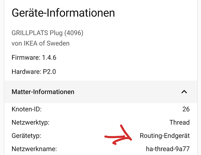

Im wondering why they aren’t used as thread router instead they only seem to be used as end devices?
I wonder why ikea made that choice for an always powered device…?
The alpstuga air quality monitor is used as a thread router.
I think the plug should be used as one as well

Can anyone confirm if Grillplats can work as a thread repeater/router just as Alpstuga can? I could not find any confirmation of this.
It's a Router-Eligible End Devices (REED) (see Node Roles and Types  |  OpenThread)
Yes, i can confirm it's a router and can also switch to REED-Mode, when there are already enough/too many routers within the Mesh.
