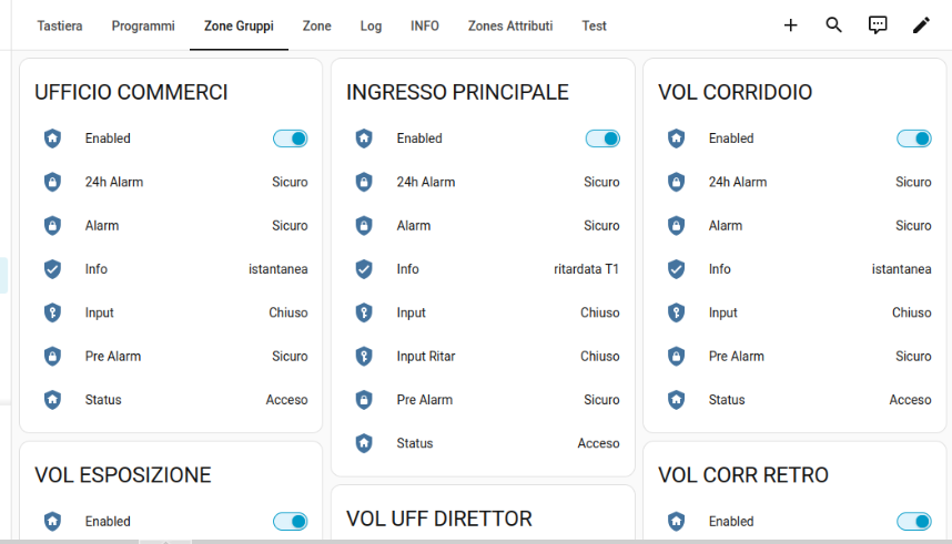

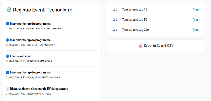

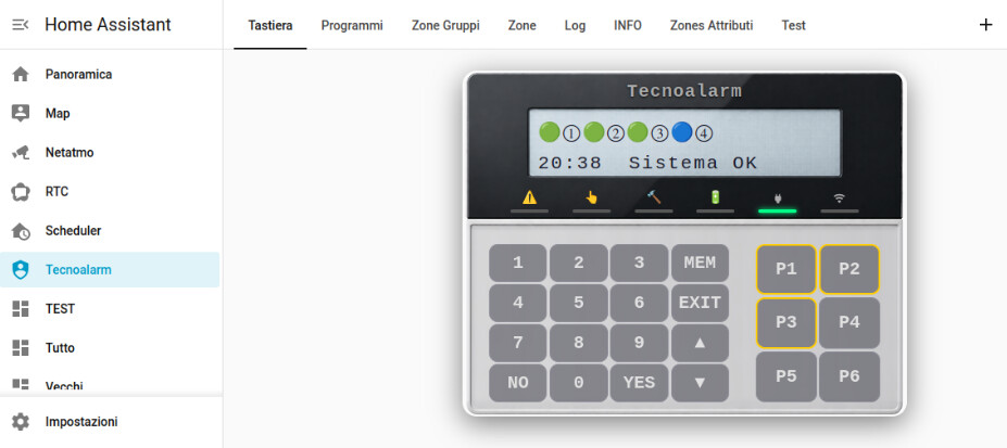

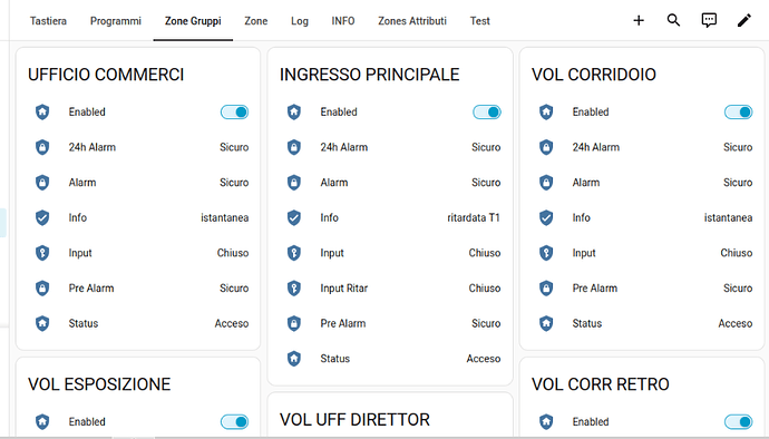

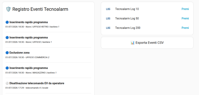

I'm working on a professional addon for Tecnoalarm systems with Tecnoout
