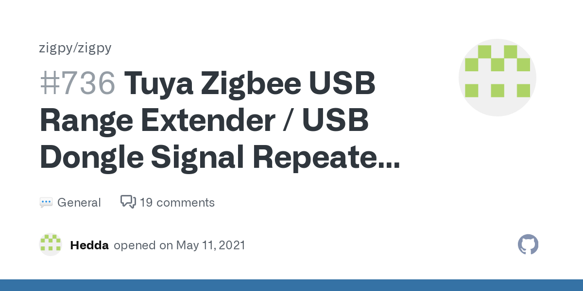

If you’re referring to the Tuya tiny usb repeaters, watch out because these used to (not sure of the current situation now) drop zigbee messages from non-Tuya devices.
If you’re using them reliably with Aqara & other non-Tuya devices, then it would be great if you could add your experience with them on that github discussion.
They work fine with my aqara door sensors, magic cube and leak sensors. No noticeable drops. I will add to the discussion.
@ShadowFist Added my experiences.
