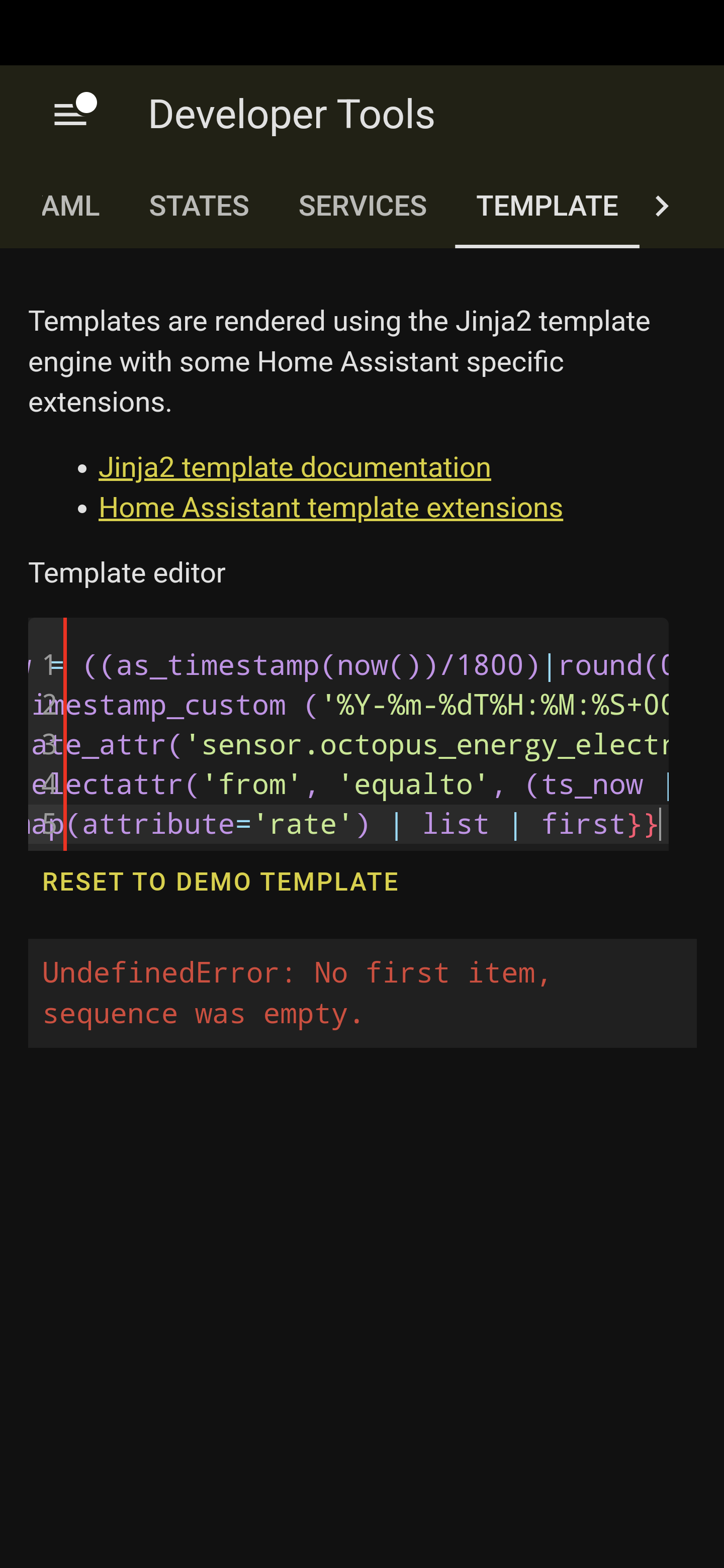

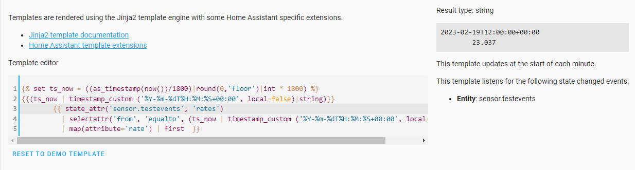

My intention is to create 3 new template sensors that update precisely on the half hour and pick up the correct rate from the array that already exists.
My templating needs some help, but I came up with this:
{% set ts_now = ((as_timestamp(now())/1800)|round(0,'floor')|int * 1800) %}
{{(ts_now | timestamp_custom ('%Y-%m-%dT%H:%M:%S+00:00', local=false)|string)}}
        {{ state_attr('sensor.octopus_energy_electricity_XXXX_XXXX_current_rate', 'rates')
          | selectattr('from', 'equalto', (ts_now | timestamp_custom ('%Y-%m-%dT%H:%M:%S+00:00', local=false)) )
          | map(attribute='rate') }}
Can anyone tell me what I might have got wrong?
Thanks!
James
Almost there… revise to this
| map(attribute='rate') | first }}

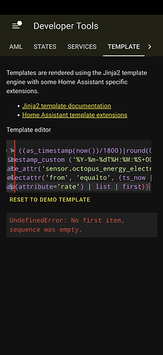

Thank you, however with that I get
UndefinedError: No first item, sequence was empty.

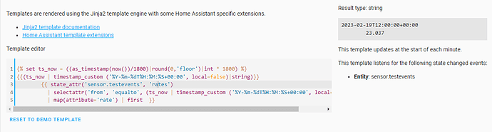

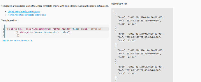

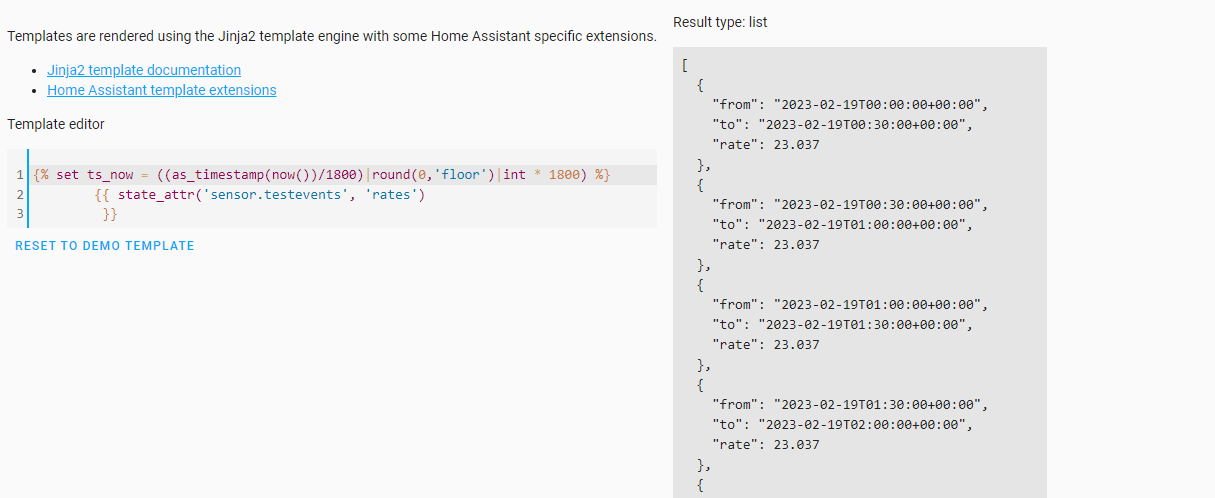

? with me this works fine, are you sure your sensor has the attribute ‘rates’ populated?
EDIT:
I pasted your data above in the attributes of a entity “testevents” and then

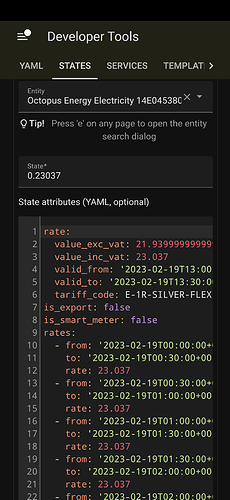

Thanks. The attributes I shared are copied straight from the state attributes yaml from Developer Tools, States, so I believe everything is ok - not sure how to confirm?
I had tried what you suggested, but yes, struggling to make it work, and not sure why.
So what does it show in Templates without the | first?
<generator object sync_do_map at 0x9e97ca00>
Which I have struggled to understand!
Because it sends a object.
What happens when you use | map(attribute=‘rate’) | list | first
        {{ state_attr('sensor.octopus_energy_electricity_XXXX_XXXXX_current_rate', 'rates')
Returns:
[{'from': datetime.datetime(2023, 2, 19, 0, 0, tzinfo=datetime.timezone.utc), 'to': datetime.datetime(2023, 2, 19, 0, 30, tzinfo=datetime.timezone.utc), 'rate': 23.037}, {'from': datetime.datetime(2023, 2, 19, 0, 30, tzinfo=datetime.timezone.utc), 'to': datetime.datetime(2023, 2, 19, 1, 0, tzinfo=datetime.timezone.utc), 'rate': 23.037}, {'from': datetime.datetime(2023, 2, 19, 1, 0, tzinfo=datetime.timezone.utc), 'to': datetime.datetime(2023, 2, 19, 1, 30, tzinfo=datetime.timezone.utc), 'rate': 23.037}, {'from': datetime.datetime(2023, 2, 19, 1, 30, tzinfo=datetime.timezone.utc), 'to': datetime.datetime(2023, 2, 19, 2, 0, tzinfo=datetime.timezone.utc), 'rate': 23.037}, {'from': datetime.datetime(2023, 2, 19, 2, 0, tzinfo=datetime.timezone.utc), 'to': datetime.datetime(2023, 2, 19, 2, 30, tzinfo=datetime.timezone.utc), 'rate': 23.037}, {'from': datetime.datetime(2023, 2, 19, 2, 30, tzinfo=datetime.timezone.utc), 'to': datetime.datetime(2023, 2, 19, 3, 0, tzinfo=datetime.timezone.utc), 'rate': 23.037}, {'from': datetime.datetime(2023, 2, 19, 3, 0, tzinfo=datetime.timezone.utc), 'to': datetime.datetime(2023, 2, 19, 3, 30, tzinfo=datetime.timezone.utc), 'rate': 23.037}, {'from': datetime.datetime(2023, 2, 19, 3, 30, tzinfo=datetime.timezone.utc), 'to': datetime.datetime(2023, 2, 19, 4, 0, tzinfo=datetime.timezone.utc), 'rate': 23.037}, {'from': datetime.datetime(2023, 2, 19, 4, 0, tzinfo=datetime.timezone.utc), 'to': datetime.datetime(2023, 2, 19, 4, 30, tzinfo=datetime.timezone.utc), 'rate': 23.037}, {'from': datetime.datetime(2023, 2, 19, 4, 30, tzinfo=datetime.timezone.utc), 'to': datetime.datetime(2023, 2, 19, 5, 0, tzinfo=datetime.timezone.utc), 'rate': 23.037}, {'from': datetime.datetime(2023, 2, 19, 5, 0, tzinfo=datetime.timezone.utc), 'to': datetime.datetime(2023, 2, 19, 5, 30, tzinfo=datetime.timezone.utc), 'rate': 23.037}, {'from': datetime.datetime(2023, 2, 19, 5, 30, tzinfo=datetime.timezone.utc), 'to': datetime.datetime(2023, 2, 19, 6, 0, tzinfo=datetime.timezone.utc), 'rate': 23.037}, {'from': datetime.datetime(2023, 2, 19, 6, 0, tzinfo=datetime.timezone.utc), 'to': datetime.datetime(2023, 2, 19, 6, 30, tzinfo=datetime.timezone.utc), 'rate': 23.037}, {'from': datetime.datetime(2023, 2, 19, 6, 30, tzinfo=datetime.timezone.utc), 'to': datetime.datetime(2023, 2, 19, 7, 0, tzinfo=datetime.timezone.utc), 'rate': 23.037}, {'from': datetime.datetime(2023, 2, 19, 7, 0, tzinfo=datetime.timezone.utc), 'to': datetime.datetime(2023, 2, 19, 7, 30, tzinfo=datetime.timezone.utc), 'rate': 23.037}, {'from': datetime.datetime(2023, 2, 19, 7, 30, tzinfo=datetime.timezone.utc), 'to': datetime.datetime(2023, 2, 19, 8, 0, tzinfo=datetime.timezone.utc), 'rate': 23.037}, {'from': datetime.datetime(2023, 2, 19, 8, 0, tzinfo=datetime.timezone.utc), 'to': datetime.datetime(2023, 2, 19, 8, 30, tzinfo=datetime.timezone.utc), 'rate': 23.037}, {'from': datetime.datetime(2023, 2, 19, 8, 30, tzinfo=datetime.timezone.utc), 'to': datetime.datetime(2023, 2, 19, 9, 0, tzinfo=datetime.timezone.utc), 'rate': 23.037}, {'from': datetime.datetime(2023, 2, 19, 9, 0, tzinfo=datetime.timezone.utc), 'to': datetime.datetime(2023, 2, 19, 9, 30, tzinfo=datetime.timezone.utc), 'rate': 23.037}, {'from': datetime.datetime(2023, 2, 19, 9, 30, tzinfo=datetime.timezone.utc), 'to': datetime.datetime(2023, 2, 19, 10, 0, tzinfo=datetime.timezone.utc), 'rate': 23.037}, {'from': datetime.datetime(2023, 2, 19, 10, 0, tzinfo=datetime.timezone.utc), 'to': datetime.datetime(2023, 2, 19, 10, 30, tzinfo=datetime.timezone.utc), 'rate': 23.037}, {'from': datetime.datetime(2023, 2, 19, 10, 30, tzinfo=datetime.timezone.utc), 'to': datetime.datetime(2023, 2, 19, 11, 0, tzinfo=datetime.timezone.utc), 'rate': 23.037}, {'from': datetime.datetime(2023, 2, 19, 11, 0, tzinfo=datetime.timezone.utc), 'to': datetime.datetime(2023, 2, 19, 11, 30, tzinfo=datetime.timezone.utc), 'rate': 23.037}, {'from': datetime.datetime(2023, 2, 19, 11, 30, tzinfo=datetime.timezone.utc), 'to': datetime.datetime(2023, 2, 19, 12, 0, tzinfo=datetime.timezone.utc), 'rate': 23.037}, {'from': datetime.datetime(2023, 2, 19, 12, 0, tzinfo=datetime.timezone.utc), 'to': datetime.datetime(2023, 2, 19, 12, 30, tzinfo=datetime.timezone.utc), 'rate': 23.037}, {'from': datetime.datetime(2023, 2, 19, 12, 30, tzinfo=datetime.timezone.utc), 'to': datetime.datetime(2023, 2, 19, 13, 0, tzinfo=datetime.timezone.utc), 'rate': 23.037}, {'from': datetime.datetime(2023, 2, 19, 13, 0, tzinfo=datetime.timezone.utc), 'to': datetime.datetime(2023, 2, 19, 13, 30, tzinfo=datetime.timezone.utc), 'rate': 23.037}, {'from': datetime.datetime(2023, 2, 19, 13, 30, tzinfo=datetime.timezone.utc), 'to': datetime.datetime(2023, 2, 19, 14, 0, tzinfo=datetime.timezone.utc), 'rate': 23.037}, {'from': datetime.datetime(2023, 2, 19, 14, 0, tzinfo=datetime.timezone.utc), 'to': datetime.datetime(2023, 2, 19, 14, 30, tzinfo=datetime.timezone.utc), 'rate': 23.037}, {'from': datetime.datetime(2023, 2, 19, 14, 30, tzinfo=datetime.timezone.utc), 'to': datetime.datetime(2023, 2, 19, 15, 0, tzinfo=datetime.timezone.utc), 'rate': 23.037}, {'from': datetime.datetime(2023, 2, 19, 15, 0, tzinfo=datetime.timezone.utc), 'to': datetime.datetime(2023, 2, 19, 15, 30, tzinfo=datetime.timezone.utc), 'rate': 23.037}, {'from': datetime.datetime(2023, 2, 19, 15, 30, tzinfo=datetime.timezone.utc), 'to': datetime.datetime(2023, 2, 19, 16, 0, tzinfo=datetime.timezone.utc), 'rate': 23.037}, {'from': datetime.datetime(2023, 2, 19, 16, 0, tzinfo=datetime.timezone.utc), 'to': datetime.datetime(2023, 2, 19, 16, 30, tzinfo=datetime.timezone.utc), 'rate': 23.037}, {'from': datetime.datetime(2023, 2, 19, 16, 30, tzinfo=datetime.timezone.utc), 'to': datetime.datetime(2023, 2, 19, 17, 0, tzinfo=datetime.timezone.utc), 'rate': 23.037}, {'from': datetime.datetime(2023, 2, 19, 17, 0, tzinfo=datetime.timezone.utc), 'to': datetime.datetime(2023, 2, 19, 17, 30, tzinfo=datetime.timezone.utc), 'rate': 23.037}, {'from': datetime.datetime(2023, 2, 19, 17, 30, tzinfo=datetime.timezone.utc), 'to': datetime.datetime(2023, 2, 19, 18, 0, tzinfo=datetime.timezone.utc), 'rate': 23.037}, {'from': datetime.datetime(2023, 2, 19, 18, 0, tzinfo=datetime.timezone.utc), 'to': datetime.datetime(2023, 2, 19, 18, 30, tzinfo=datetime.timezone.utc), 'rate': 23.037}, {'from': datetime.datetime(2023, 2, 19, 18, 30, tzinfo=datetime.timezone.utc), 'to': datetime.datetime(2023, 2, 19, 19, 0, tzinfo=datetime.timezone.utc), 'rate': 23.037}, {'from': datetime.datetime(2023, 2, 19, 19, 0, tzinfo=datetime.timezone.utc), 'to': datetime.datetime(2023, 2, 19, 19, 30, tzinfo=datetime.timezone.utc), 'rate': 23.037}, {'from': datetime.datetime(2023, 2, 19, 19, 30, tzinfo=datetime.timezone.utc), 'to': datetime.datetime(2023, 2, 19, 20, 0, tzinfo=datetime.timezone.utc), 'rate': 23.037}, {'from': datetime.datetime(2023, 2, 19, 20, 0, tzinfo=datetime.timezone.utc), 'to': datetime.datetime(2023, 2, 19, 20, 30, tzinfo=datetime.timezone.utc), 'rate': 23.037}, {'from': datetime.datetime(2023, 2, 19, 20, 30, tzinfo=datetime.timezone.utc), 'to': datetime.datetime(2023, 2, 19, 21, 0, tzinfo=datetime.timezone.utc), 'rate': 23.037}, {'from': datetime.datetime(2023, 2, 19, 21, 0, tzinfo=datetime.timezone.utc), 'to': datetime.datetime(2023, 2, 19, 21, 30, tzinfo=datetime.timezone.utc), 'rate': 23.037}, {'from': datetime.datetime(2023, 2, 19, 21, 30, tzinfo=datetime.timezone.utc), 'to': datetime.datetime(2023, 2, 19, 22, 0, tzinfo=datetime.timezone.utc), 'rate': 23.037}, {'from': datetime.datetime(2023, 2, 19, 22, 0, tzinfo=datetime.timezone.utc), 'to': datetime.datetime(2023, 2, 19, 22, 30, tzinfo=datetime.timezone.utc), 'rate': 23.037}, {'from': datetime.datetime(2023, 2, 19, 22, 30, tzinfo=datetime.timezone.utc), 'to': datetime.datetime(2023, 2, 19, 23, 0, tzinfo=datetime.timezone.utc), 'rate': 23.037}, {'from': datetime.datetime(2023, 2, 19, 23, 0, tzinfo=datetime.timezone.utc), 'to': datetime.datetime(2023, 2, 19, 23, 30, tzinfo=datetime.timezone.utc), 'rate': 23.037}, {'from': datetime.datetime(2023, 2, 19, 23, 30, tzinfo=datetime.timezone.utc), 'to': datetime.datetime(2023, 2, 20, 0, 0, tzinfo=datetime.timezone.utc), 'rate': 23.037}, {'from': datetime.datetime(2023, 2, 20, 0, 0, tzinfo=datetime.timezone.utc), 'to': datetime.datetime(2023, 2, 20, 0, 30, tzinfo=datetime.timezone.utc), 'rate': 71.6415}, {'from': datetime.datetime(2023, 2, 20, 0, 30, tzinfo=datetime.timezone.utc), 'to': datetime.datetime(2023, 2, 20, 1, 0, tzinfo=datetime.timezone.utc), 'rate': 71.6415}, {'from': datetime.datetime(2023, 2, 20, 1, 0, tzinfo=datetime.timezone.utc), 'to': datetime.datetime(2023, 2, 20, 1, 30, tzinfo=datetime.timezone.utc), 'rate': 71.6415}, {'from': datetime.datetime(2023, 2, 20, 1, 30, tzinfo=datetime.timezone.utc), 'to': datetime.datetime(2023, 2, 20, 2, 0, tzinfo=datetime.timezone.utc), 'rate': 71.6415}, {'from': datetime.datetime(2023, 2, 20, 2, 0, tzinfo=datetime.timezone.utc), 'to': datetime.datetime(2023, 2, 20, 2, 30, tzinfo=datetime.timezone.utc), 'rate': 71.6415}, {'from': datetime.datetime(2023, 2, 20, 2, 30, tzinfo=datetime.timezone.utc), 'to': datetime.datetime(2023, 2, 20, 3, 0, tzinfo=datetime.timezone.utc), 'rate': 71.6415}, {'from': datetime.datetime(2023, 2, 20, 3, 0, tzinfo=datetime.timezone.utc), 'to': datetime.datetime(2023, 2, 20, 3, 30, tzinfo=datetime.timezone.utc), 'rate': 71.6415}, {'from': datetime.datetime(2023, 2, 20, 3, 30, tzinfo=datetime.timezone.utc), 'to': datetime.datetime(2023, 2, 20, 4, 0, tzinfo=datetime.timezone.utc), 'rate': 71.6415}, {'from': datetime.datetime(2023, 2, 20, 4, 0, tzinfo=datetime.timezone.utc), 'to': datetime.datetime(2023, 2, 20, 4, 30, tzinfo=datetime.timezone.utc), 'rate': 71.6415}, {'from': datetime.datetime(2023, 2, 20, 4, 30, tzinfo=datetime.timezone.utc), 'to': datetime.datetime(2023, 2, 20, 5, 0, tzinfo=datetime.timezone.utc), 'rate': 71.6415}, {'from': datetime.datetime(2023, 2, 20, 5, 0, tzinfo=datetime.timezone.utc), 'to': datetime.datetime(2023, 2, 20, 5, 30, tzinfo=datetime.timezone.utc), 'rate': 71.6415}, {'from': datetime.datetime(2023, 2, 20, 5, 30, tzinfo=datetime.timezone.utc), 'to': datetime.datetime(2023, 2, 20, 6, 0, tzinfo=datetime.timezone.utc), 'rate': 71.6415}, {'from': datetime.datetime(2023, 2, 20, 6, 0, tzinfo=datetime.timezone.utc), 'to': datetime.datetime(2023, 2, 20, 6, 30, tzinfo=datetime.timezone.utc), 'rate': 71.6415}, {'from': datetime.datetime(2023, 2, 20, 6, 30, tzinfo=datetime.timezone.utc), 'to': datetime.datetime(2023, 2, 20, 7, 0, tzinfo=datetime.timezone.utc), 'rate': 71.6415}, {'from': datetime.datetime(2023, 2, 20, 7, 0, tzinfo=datetime.timezone.utc), 'to': datetime.datetime(2023, 2, 20, 7, 30, tzinfo=datetime.timezone.utc), 'rate': 71.6415}, {'from': datetime.datetime(2023, 2, 20, 7, 30, tzinfo=datetime.timezone.utc), 'to': datetime.datetime(2023, 2, 20, 8, 0, tzinfo=datetime.timezone.utc), 'rate': 71.6415}, {'from': datetime.datetime(2023, 2, 20, 8, 0, tzinfo=datetime.timezone.utc), 'to': datetime.datetime(2023, 2, 20, 8, 30, tzinfo=datetime.timezone.utc), 'rate': 71.6415}, {'from': datetime.datetime(2023, 2, 20, 8, 30, tzinfo=datetime.timezone.utc), 'to': datetime.datetime(2023, 2, 20, 9, 0, tzinfo=datetime.timezone.utc), 'rate': 71.6415}, {'from': datetime.datetime(2023, 2, 20, 9, 0, tzinfo=datetime.timezone.utc), 'to': datetime.datetime(2023, 2, 20, 9, 30, tzinfo=datetime.timezone.utc), 'rate': 71.6415}, {'from': datetime.datetime(2023, 2, 20, 9, 30, tzinfo=datetime.timezone.utc), 'to': datetime.datetime(2023, 2, 20, 10, 0, tzinfo=datetime.timezone.utc), 'rate': 71.6415}, {'from': datetime.datetime(2023, 2, 20, 10, 0, tzinfo=datetime.timezone.utc), 'to': datetime.datetime(2023, 2, 20, 10, 30, tzinfo=datetime.timezone.utc), 'rate': 71.6415}, {'from': datetime.datetime(2023, 2, 20, 10, 30, tzinfo=datetime.timezone.utc), 'to': datetime.datetime(2023, 2, 20, 11, 0, tzinfo=datetime.timezone.utc), 'rate': 71.6415}, {'from': datetime.datetime(2023, 2, 20, 11, 0, tzinfo=datetime.timezone.utc), 'to': datetime.datetime(2023, 2, 20, 11, 30, tzinfo=datetime.timezone.utc), 'rate': 71.6415}, {'from': datetime.datetime(2023, 2, 20, 11, 30, tzinfo=datetime.timezone.utc), 'to': datetime.datetime(2023, 2, 20, 12, 0, tzinfo=datetime.timezone.utc), 'rate': 71.6415}, {'from': datetime.datetime(2023, 2, 20, 12, 0, tzinfo=datetime.timezone.utc), 'to': datetime.datetime(2023, 2, 20, 12, 30, tzinfo=datetime.timezone.utc), 'rate': 71.6415}, {'from': datetime.datetime(2023, 2, 20, 12, 30, tzinfo=datetime.timezone.utc), 'to': datetime.datetime(2023, 2, 20, 13, 0, tzinfo=datetime.timezone.utc), 'rate': 71.6415}, {'from': datetime.datetime(2023, 2, 20, 13, 0, tzinfo=datetime.timezone.utc), 'to': datetime.datetime(2023, 2, 20, 13, 30, tzinfo=datetime.timezone.utc), 'rate': 71.6415}, {'from': datetime.datetime(2023, 2, 20, 13, 30, tzinfo=datetime.timezone.utc), 'to': datetime.datetime(2023, 2, 20, 14, 0, tzinfo=datetime.timezone.utc), 'rate': 71.6415}, {'from': datetime.datetime(2023, 2, 20, 14, 0, tzinfo=datetime.timezone.utc), 'to': datetime.datetime(2023, 2, 20, 14, 30, tzinfo=datetime.timezone.utc), 'rate': 71.6415}, {'from': datetime.datetime(2023, 2, 20, 14, 30, tzinfo=datetime.timezone.utc), 'to': datetime.datetime(2023, 2, 20, 15, 0, tzinfo=datetime.timezone.utc), 'rate': 71.6415}, {'from': datetime.datetime(2023, 2, 20, 15, 0, tzinfo=datetime.timezone.utc), 'to': datetime.datetime(2023, 2, 20, 15, 30, tzinfo=datetime.timezone.utc), 'rate': 71.6415}, {'from': datetime.datetime(2023, 2, 20, 15, 30, tzinfo=datetime.timezone.utc), 'to': datetime.datetime(2023, 2, 20, 16, 0, tzinfo=datetime.timezone.utc), 'rate': 71.6415}, {'from': datetime.datetime(2023, 2, 20, 16, 0, tzinfo=datetime.timezone.utc), 'to': datetime.datetime(2023, 2, 20, 16, 30, tzinfo=datetime.timezone.utc), 'rate': 71.6415}, {'from': datetime.datetime(2023, 2, 20, 16, 30, tzinfo=datetime.timezone.utc), 'to': datetime.datetime(2023, 2, 20, 17, 0, tzinfo=datetime.timezone.utc), 'rate': 71.6415}, {'from': datetime.datetime(2023, 2, 20, 17, 0, tzinfo=datetime.timezone.utc), 'to': datetime.datetime(2023, 2, 20, 17, 30, tzinfo=datetime.timezone.utc), 'rate': 71.6415}, {'from': datetime.datetime(2023, 2, 20, 17, 30, tzinfo=datetime.timezone.utc), 'to': datetime.datetime(2023, 2, 20, 18, 0, tzinfo=datetime.timezone.utc), 'rate': 71.6415}, {'from': datetime.datetime(2023, 2, 20, 18, 0, tzinfo=datetime.timezone.utc), 'to': datetime.datetime(2023, 2, 20, 18, 30, tzinfo=datetime.timezone.utc), 'rate': 71.6415}, {'from': datetime.datetime(2023, 2, 20, 18, 30, tzinfo=datetime.timezone.utc), 'to': datetime.datetime(2023, 2, 20, 19, 0, tzinfo=datetime.timezone.utc), 'rate': 71.6415}, {'from': datetime.datetime(2023, 2, 20, 19, 0, tzinfo=datetime.timezone.utc), 'to': datetime.datetime(2023, 2, 20, 19, 30, tzinfo=datetime.timezone.utc), 'rate': 71.6415}, {'from': datetime.datetime(2023, 2, 20, 19, 30, tzinfo=datetime.timezone.utc), 'to': datetime.datetime(2023, 2, 20, 20, 0, tzinfo=datetime.timezone.utc), 'rate': 71.6415}, {'from': datetime.datetime(2023, 2, 20, 20, 0, tzinfo=datetime.timezone.utc), 'to': datetime.datetime(2023, 2, 20, 20, 30, tzinfo=datetime.timezone.utc), 'rate': 71.6415}, {'from': datetime.datetime(2023, 2, 20, 20, 30, tzinfo=datetime.timezone.utc), 'to': datetime.datetime(2023, 2, 20, 21, 0, tzinfo=datetime.timezone.utc), 'rate': 71.6415}, {'from': datetime.datetime(2023, 2, 20, 21, 0, tzinfo=datetime.timezone.utc), 'to': datetime.datetime(2023, 2, 20, 21, 30, tzinfo=datetime.timezone.utc), 'rate': 71.6415}, {'from': datetime.datetime(2023, 2, 20, 21, 30, tzinfo=datetime.timezone.utc), 'to': datetime.datetime(2023, 2, 20, 22, 0, tzinfo=datetime.timezone.utc), 'rate': 71.6415}, {'from': datetime.datetime(2023, 2, 20, 22, 0, tzinfo=datetime.timezone.utc), 'to': datetime.datetime(2023, 2, 20, 22, 30, tzinfo=datetime.timezone.utc), 'rate': 71.6415}, {'from': datetime.datetime(2023, 2, 20, 22, 30, tzinfo=datetime.timezone.utc), 'to': datetime.datetime(2023, 2, 20, 23, 0, tzinfo=datetime.timezone.utc), 'rate': 71.6415}, {'from': datetime.datetime(2023, 2, 20, 23, 0, tzinfo=datetime.timezone.utc), 'to': datetime.datetime(2023, 2, 20, 23, 30, tzinfo=datetime.timezone.utc), 'rate': 71.6415}, {'from': datetime.datetime(2023, 2, 20, 23, 30, tzinfo=datetime.timezone.utc), 'to': datetime.datetime(2023, 2, 21, 0, 0, tzinfo=datetime.timezone.utc), 'rate': 71.6415}]
I think this might be a clue that I’m not transforming my required date/time correctly?

The result of adding list filter before first is:
So, the output above that you copied is not (!) the same as with with you started off from

The initial output is the whole yaml attributes from the sensor under Developer settings/States for the sensor.
The thing I pasted subsequently is the output of the template/filter that I shared.
It appears the way the state attributes are presented in the UI not the same way it is seen by the template filters?
I have no issues with that , copied your code and only changed my sensor name.
The templating should not change the datetime to what you sent so sorry to ask…are you really sure that the sensor is correct and has the right attributes?
Here’s a screenshot of what I see under Developer Tools/States
Is there something else I should be using? :slightly_smiling_face:
And screenshot of devtools > template when you the latest code?
I donot want to sound patronizing but it is not uncommon to miss the point and from a distance, I am asking until I too (may ) fail :slight_smile:
Not at all, very grateful for your help
Will get the screenshot now
        {{ state_attr('sensor.octopus_energy_electricity_14e0453806_1900013341923_current_rate', 'rates')
          | map(attribute='rate') | list | first}}
(I am no longer going to worry about hiding my meter’s serial number).
