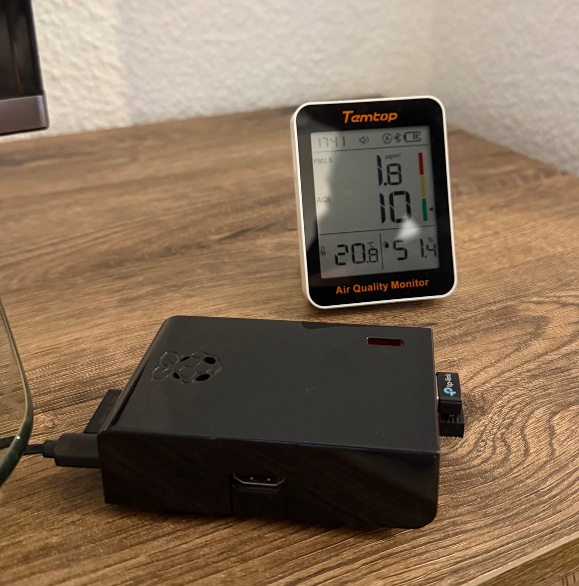

I reverse-engineered the BLE protocol of the Temtop S1+ air quality monitor and built a Python-based integration that sends sensor data directly to Home Assistant — without the official app, without MQTT, without any cloud.

Hardware:
  • Temtop S1+ air quality monitor
  • Raspberry Pi with Bluetooth (built-in or USB dongle)
  • Tested with: Raspberry Pi 1 Model B (2011) + TP-Link UB500
